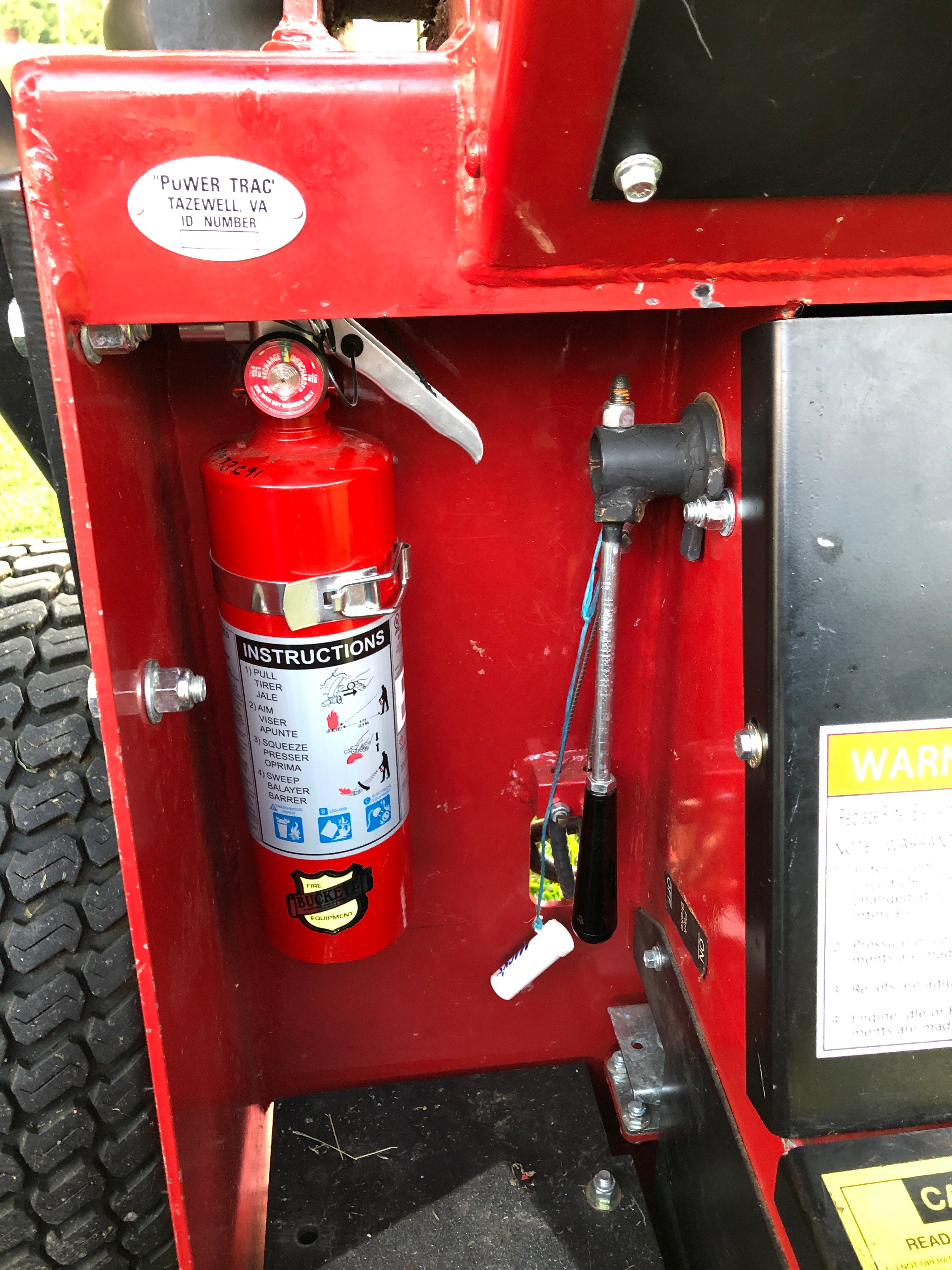

I finally got the fire extinguisher on today. The parking brake lever I done last year; it gives me move leverage, more comfortable handle, and it's down out of the way so it doesn't hit my knee.IMG_1211.jpg
/ PowerTrac Specific Modifications #56
Good place for the fire ext. On your park brake, did your handle start off in the vertical position and you just made it longer? Mine starts off in the horizontal (off) and goes up from there. I think I would like to have it like yours, seems like it would be easier.
/ PowerTrac Specific Modifications #58
I will take a better picture of it tomorrow, but yes, this was horizontal too before I retro fitted it. From this picture you can see where the original handle was that I cut off, then welded a extra little piece on for a stop against that nut when the parking brake pin is fully engaged. Then welded that piece of pipe onto the original handle.
The hood on this tractor is heavy, so I did not want to add anymore weight to it by putting a fire extinguisher on it.
