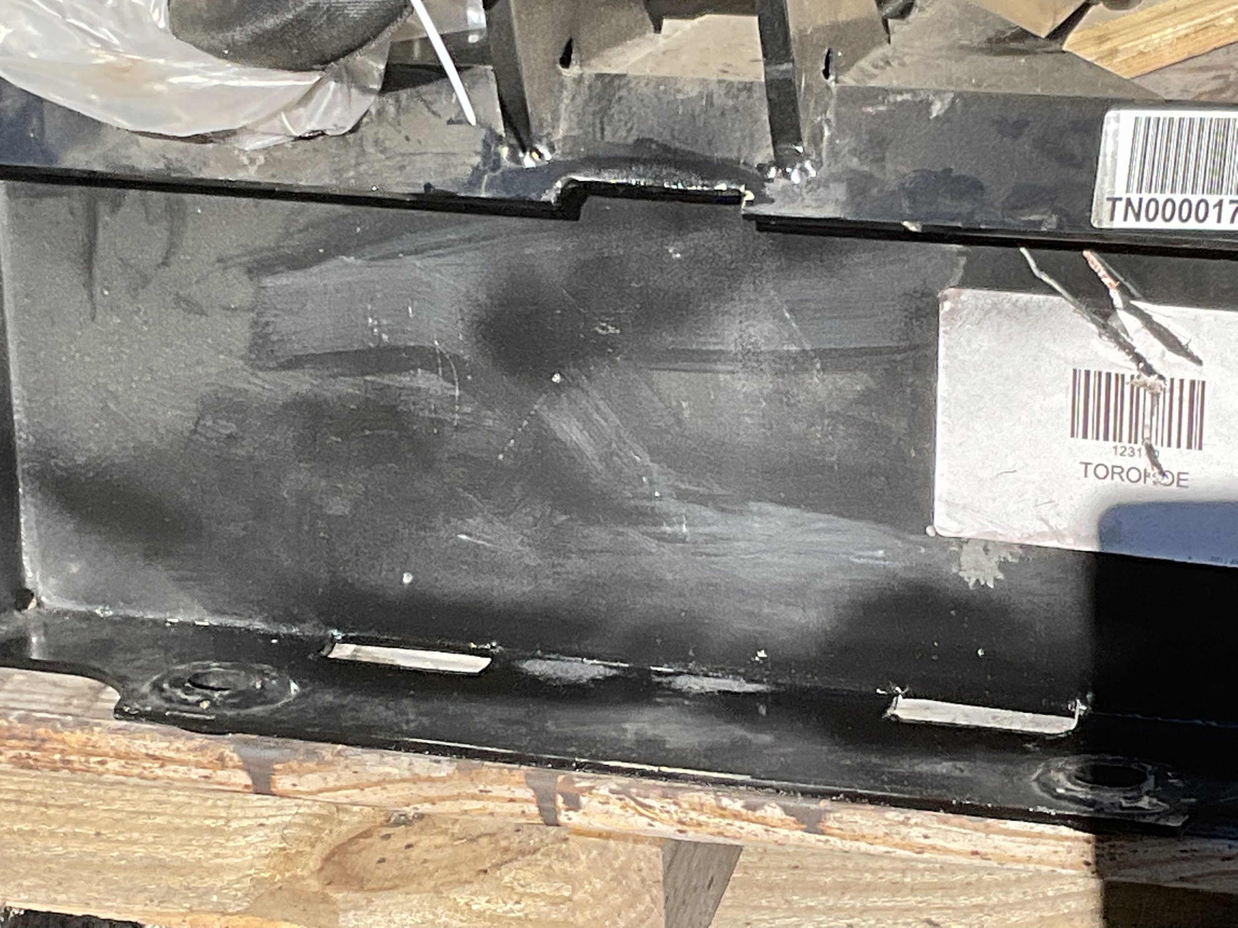

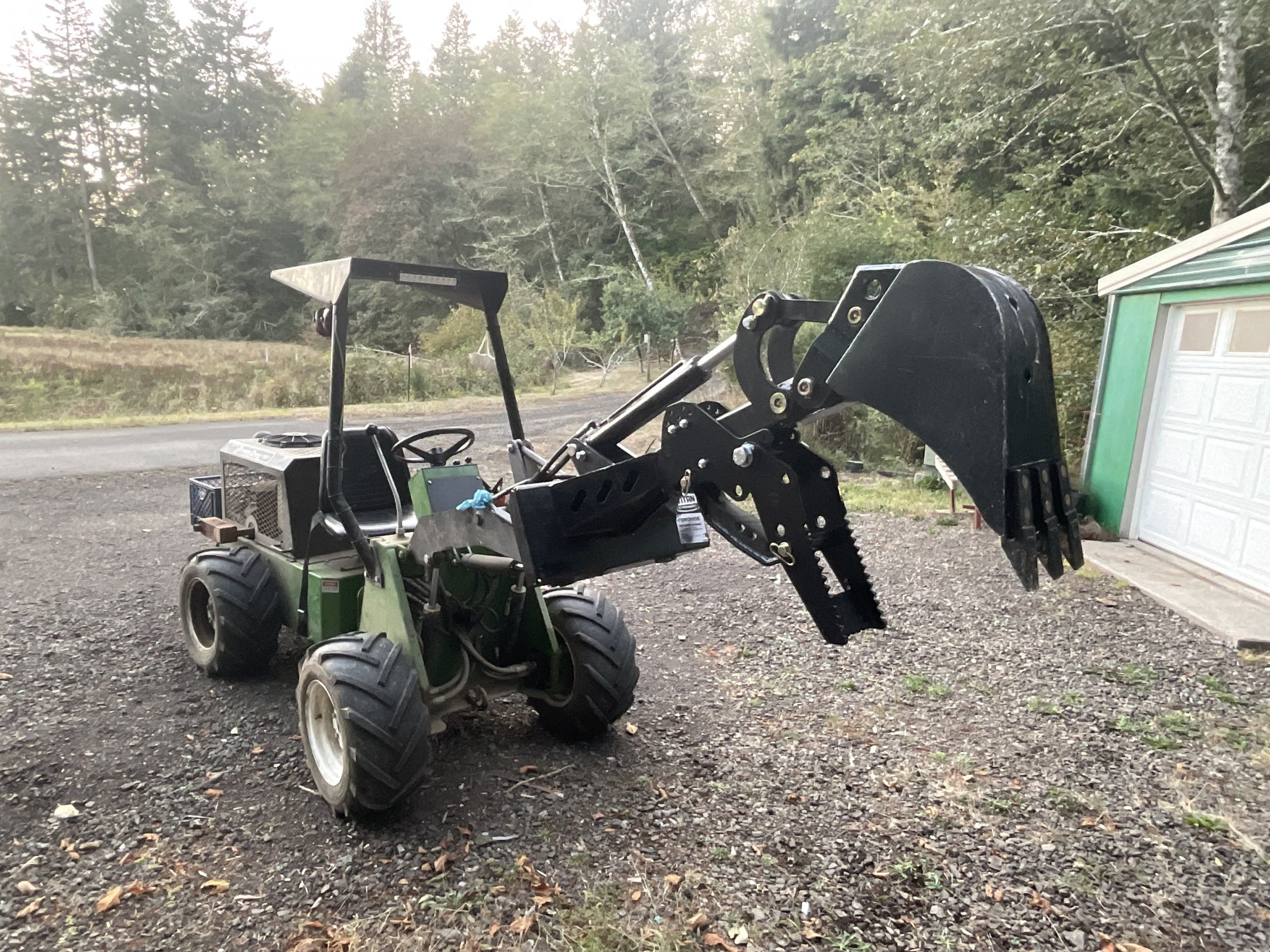

I bought a front hoe with the Toro Dingo attach plate. All I needed to do to make it work with my PT425 was to cut a notch in the top and cut the two rectangle holes in the bottom for the locking mechanism. View attachment 778099View attachment 778101
Would this apply to the pt422 as well? Anyway you could post some pics of the cuts you made on the dingo connect? I would love to be able to use dingo attachments as they are easier to find
/ PowerTrac Specific Modifications #146
I believe so. My understanding is is that the QAP IS THE SAME ON BOTH 422 and 425
