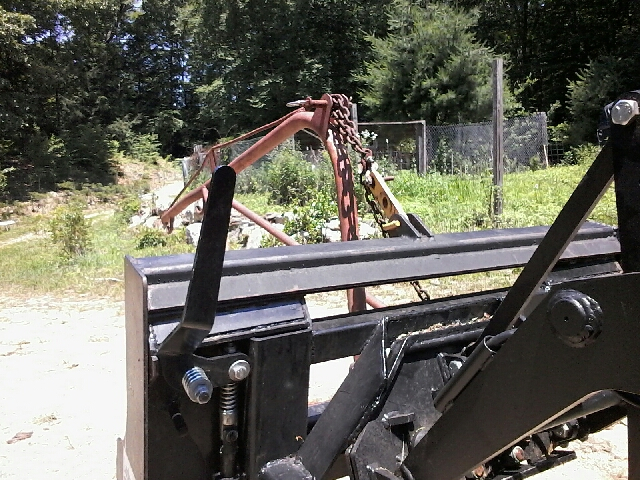

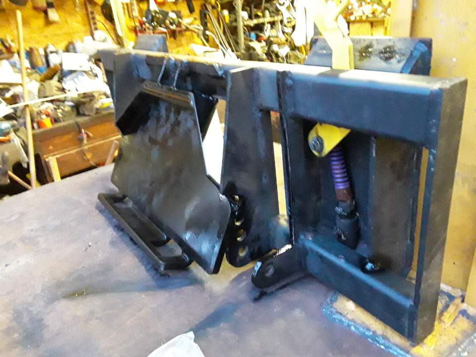

So, I picked up a power broom and an auger at auction. I needed the broom for a construction project, and realized that renting one was going to be 2/3rds the cost of a new one. The only issue was that the attachments were for skidsteers.
So, I made a PT QA to skid steer quick attach plate.
I bought the SSQA locking mechanisms off of eBay. At $99, I can’t build it for that price (3/8” steel).
I put 1/4” plate between the two ready made ends, cutting the plate to match the curves in the lock mechanism plates and added a 2”x2”x 3/8” heavy wall square tube to reinforce the bottom and to tip the Power-Trac quick attach out ten degrees or so to better match the PT’s curl range of motion. The PT QA portion is flat 1/4” plate with 3/8” rim and a bevel cut piece of 3/4” round stock as the top retaining lip. (That was a production as the rim has an extended bend that I couldn't quite reproduce. I ended up cutting my bent to shape rim and welding in a little extra metal to broaden the curve. I am sure that someone more skilled than I am would have been able to do this faster and better.) I tacked it together and made the mistake of lifting with it. (I got excited and wasn’t thinking.) That bent the top of the middle plate a bit so I removed the bend and added a 1/4” bar across the top to reinforce it. Probably unnecessary with all the other full welds in place, but I thought why risk it?
(It is leaning on the broom, so it looks crooked, but isn't.)
I’m still working out how to best adjust the springs on the locking assembly. The other minor thing that I did was remove the original grease zerks as they were a small metric variety in a location that was going to be a problem for my uses. I welded the old openings shut and then drilled new holes and tapped new NPT threads in a better location for standard US zerks.
I may make another plate for my auger. I have some concerns about overall weight of the auger and adapter, but I will cross that bridge when I get there.
The broom in the photos is supposedly 800-ish pounds, but with the weight so far in front, it is close to the limit of my 1445. The broom also came with a snazzy AB/straight through/BA solenoid to run the left / right swivel angle off of the main PTO power. I elected to bypass it and just use the PT QA/QC fittings in a dedicated circuit for the angle and run the PT PTO directly to the motor. I am considering using it as a reverse for the broom, if that turns out to be important. Otherwise, I plan to just sell the system to someone who needs a +/- function from a full flow hydraulic.

/ PowerTrac Specific Modifications #122
I made one for my 1430, shown with the boom and one for my 1460 which is a lot heavier. Both started out as 3pt hitch to SSQA adapters.

/ PowerTrac Specific Modifications #123
@m5040 so how are the springs on the pins supposed to be set/adjusted? I am wondering if I was supposed to weld a stop 10-15 degrees past BDC.
All the best,
Peter
/ PowerTrac Specific Modifications #124
Mine came all put together. But they are like a dump truck tail gate hook. It should push the pin down and go just a slight amount past, starting to raise up and stop there. That way they can't disengage unless they get tighter first.
/ PowerTrac Specific Modifications #125
Thanks, that is what I suspected. Time to weld on some stops, just past the point the pins go in.

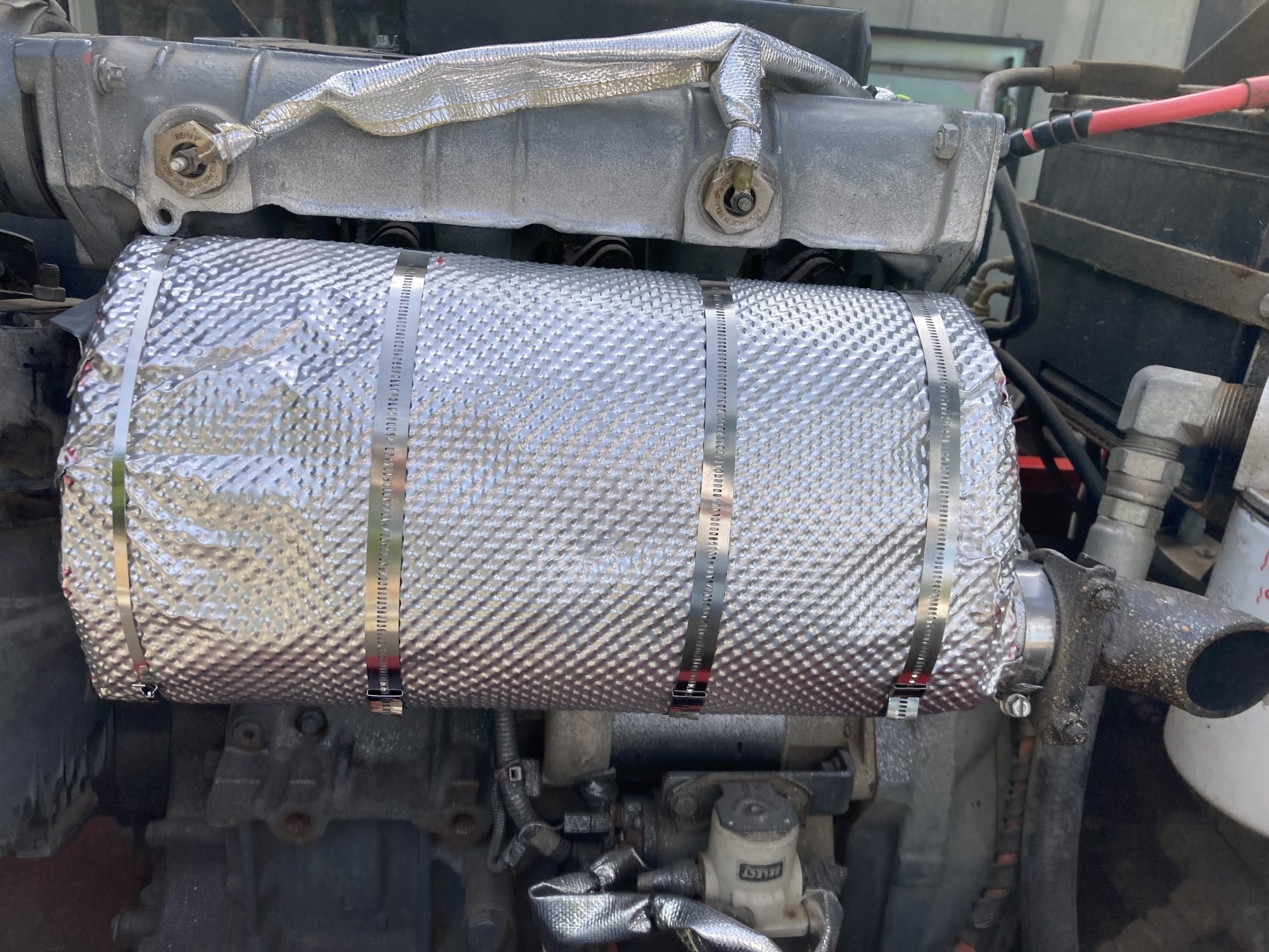

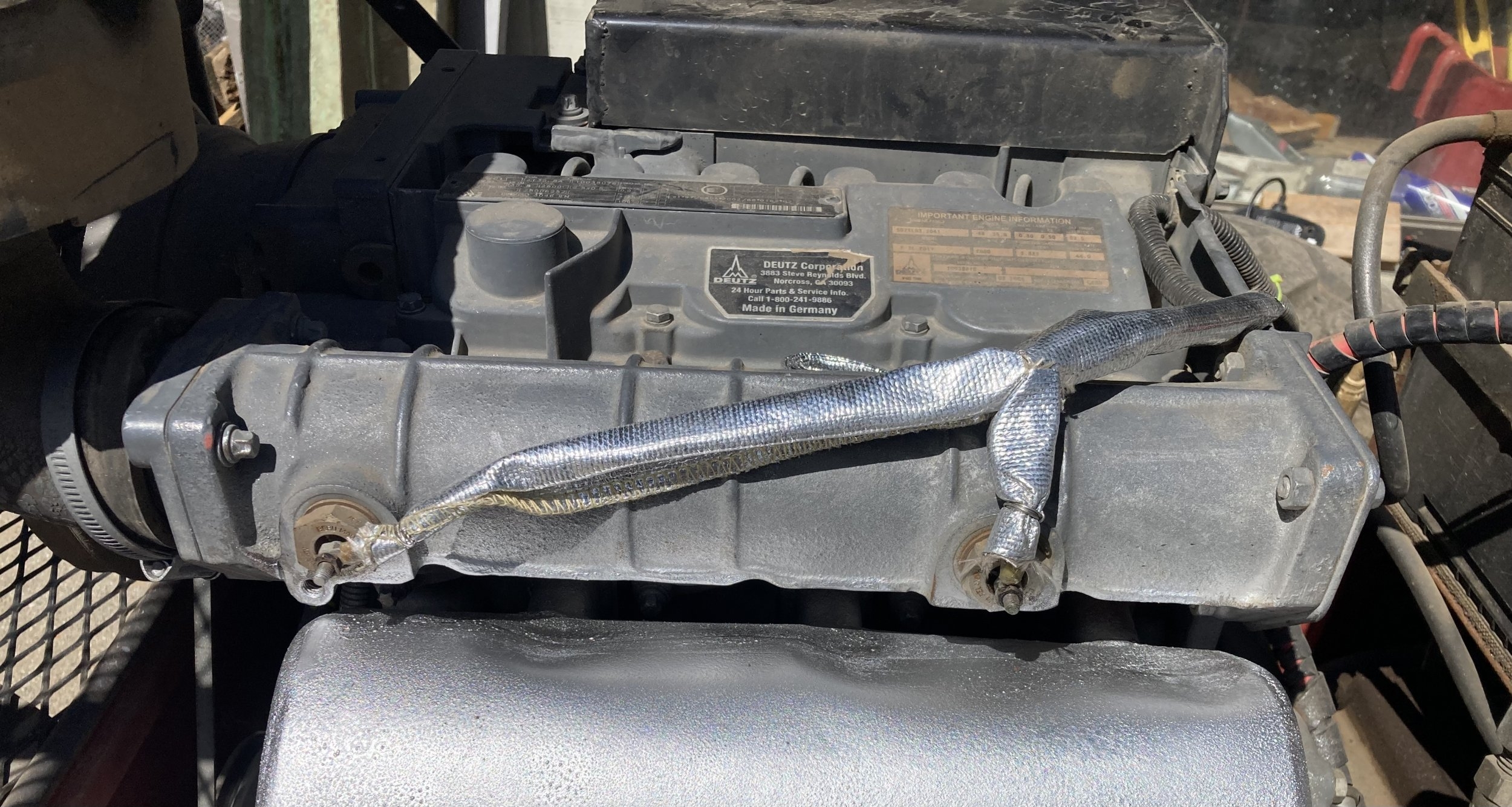

Aluminized wire loom protecting the glow plugs on the 1445 Deutz BF3L2011 engine.
In hindsight, I probably made the heat issue worse by trying to prime the muffler with Rust-Oleum Rust Reformer, which I found out later has an upper limit of 200F. It turns black as it dries. It then proceeded to flake off in the first hour, leaving rusty metal underneath, so I am underwhelmed at its rust reforming abilities as well.
So yes, sanded, prepped, and painted twice; once with the rust reformer and then sanded it down with an abrasive disk (way better than rust reformer or sand paper)
I used silver "high temp" paint the second time, but one that sets at about 400F, which is about all the Deutz can generate.
Did I mention that I love the intake heaters? They really help cut down the black smoke on starting below 40F for me. (Thanks @SpringHollow!) I am not sure that I need two, but they certainly work.

/ PowerTrac Specific Modifications #136
Might be better if you lowered the backside of the deflector so the air stream hits the shield at an angle and not straight on.

Can you tell any difference in the noise level after the wrap?

I'd be curious to see if that would make a difference on my 2001 PT425. Anything to reduce the heat under the hydraulic cooler would be a bonus, as long as it doesn't build up heat somewhere else, in my case.
Nothing too obvious to me, but the muffler didn't rattle beforehand, so I would not have expected a change. I guess the hotter exhaust gases might sound different, but I also wear Howard Leighton Leightning L3 (30dB NRR) ear muffs, so I don't know how reliable I am on this one...
