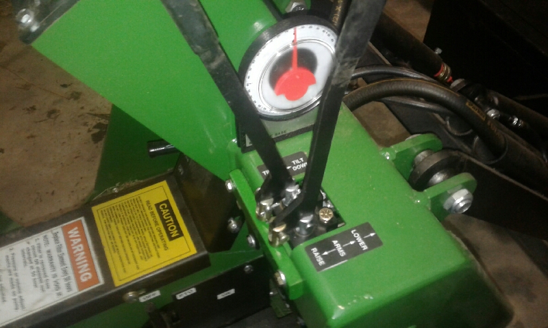

Re: PowerTrac Specific Modifications FOR PT 180 only
As you prob know, the PT 180 is a economy tractor with a lot of corners cut in the manufacturing process. Never the less it is a very capable tractor and here is a modification I did to the loader control valve.
The situation was, when a female operator (I never did this....) was using the tractor, mowing in unknown areas and encountered foreign objects, the gut reaction was to rapidly pull the loader handle back from the hold (due to higher than "float" setting for rough terrain), but due to the urgency of the situation, a lot of times the handle would be pulled back too far, through the loader "raise" position into the loader "float" position, thereby compounding the situation because the deck would now lower into the foreign object.
For those not familiar with the loader valve control on the PT180, it work as such Full Forward was lower/power down, one back was hold, again one back from hold was raise and finally all the way back was float.
I believe this was done because the valve fit in the tractor easily and was much quicker in the manufacturing process.
So, for those interested, I lowered the valve under the dash for access to the lines, switch the bucket tilt hoses top to bottom. On the loader lift cylinder, I switch the hoses end for end because it was much easier to do then fiddle with the control valve. I couldn't do this with the tilt cylinder because the hoses are different lengths. I then added a piece of 3/8 thick flat stock to the dash behind the loader control valve and drilled to mount the pivot fitting for the handles behind the valve. This changes the direction of the spool valves when you op the handles, that is why you have to switch the hoses. Now I have a regular forward float, one back down, back hold, all the way back raise setup and can now sharpen the mower blades...

That's a weird valve operation. You sure it wasn't just hose-swapped at the factory by mistake?
My 425 is held in center position, pull back to raise, push forward to lower, push even further forward past the detent to float.
/ PowerTrac Specific Modifications #33
Roger, both of yours and the rest of the PT line is how it should have been built, but the PT180 has the antiquated 2 lever controls that were on machines built back in the 70s and 80s (before someone got the idea of a single joystick). For simplicity and low cost Power Trac put the valve in basically backward in the economy machine, so they then had to use float position next to raise otherwise the controls would have cause movements opposite the motion of the bucket (IE pull the tilt lever toward operator and the bucket would have went away). The manufacture of the valve had the threaded boss for the lever pivots (in pic you can see the 2 gold grade 8 bolts to plug the holes) incorporated in the valve, so for ease of assembly, PT made it work for quick assembly with the only side effect being the float next to raise. It took me some time to make it right and when PT sells the economy machine for only $6500, they can't afford to put more labor into it. I really wonder how much they can be profiting on a tractor with 4x4 - 4 drive motors, power steering, loader, 3 hyd pumps, top quality American hyd hoses (EVEN THE LOW PRESSURE RETURN HOSES ARE PRESSURE RATED!), heavy steel throughout, quality tires, quick attach for implements etc..and to sell it for that low of a price?

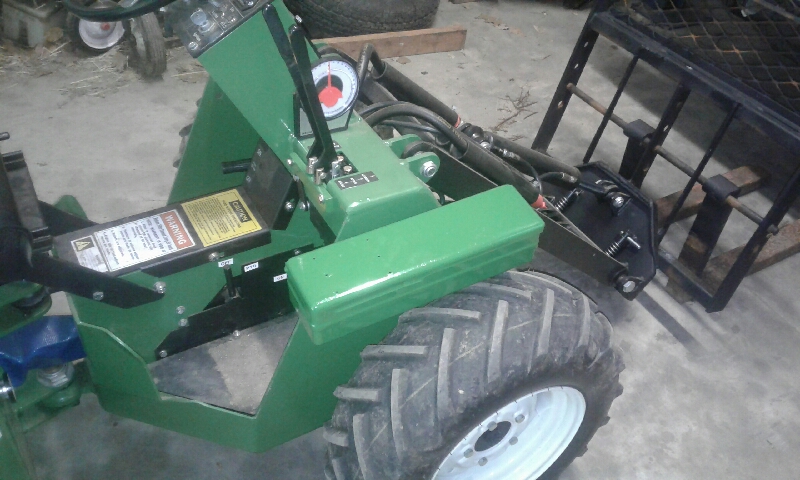

Can you find the tool box in the picture?
Not many places to put a tool box. Trying this out, doubles as a fender. Now I can store my 3pt snap ring pins, top link pin, cat 1 to cat 2 bushings, wrenches to adj sway chains......oh yeah don't need those on a Power trac. Maybe two 15/16" wrenches to tighten the mower blade bolts.

About the only semi-safe location for a toolbox for me would be on top of the engine compartment right behind my seat, but heck, even there, I managed to rip my fire extinguisher off out in the woods. I go through some pretty nasty stuff out there.
/ PowerTrac Specific Modifications #37
The biggest reason I chose that spot is because the tractor had unused holes for the ROPS, so no drilling and it seemed like it would work, so only some time to bolt it on and try it out.
