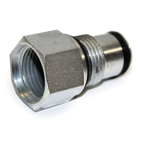

A power beyond port (PB) fitting will look something like this...It is your "connection " to add valve down the line

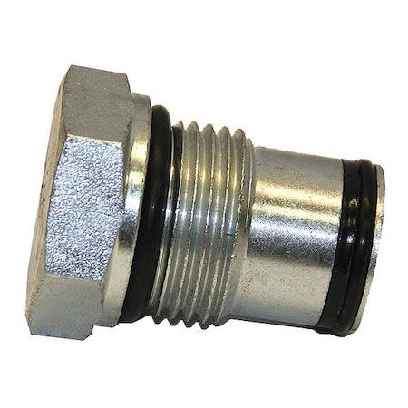

Replaces a plug that looks something like this...
Output of "PB" port usually goes to "P" (power?) port on downstream valve..
Its usually just a way to connect another control valve in series (down stream) for current (last existing) valve in line...
You will also have to deal with "tank" and "return" line from added valving...
Dale
