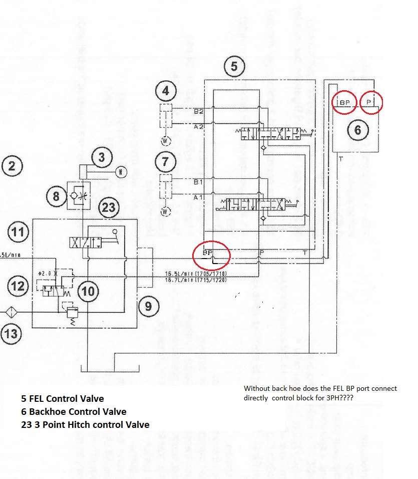

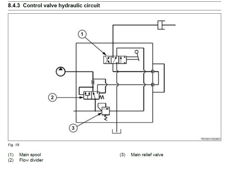

Going to reopen this thread as I think I have resolved some of the issues of how plumbing for backhoe is configured and how the MF shop manual may have it wrong... It also makes more sense if the hydraulic connections were used to add BP if no BH is on machine...
This would be hydraulics WITHOUT either FEl or BH...

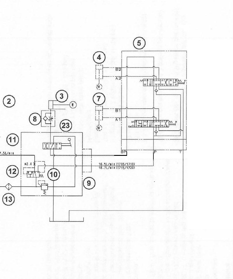

This picture is with just FEL and 3PH in hydraulic system (1705-1715) ...
This is where MF shop manual gets it wrong with added BH...
This is corrected diagram of FEL to BH (BP?) then to 3PH.. #6 could be either BH or a BP valve assembly ...
Dale
   / Help with MF GC 1705 to 1720 series Power Beyond... #15
Your last figure looks right. Now, what are you gonna do with this knowledge?

Your pictures show a maximum of 18.7 liters/minute or just under 5 gpm. And, it will be less under load.
