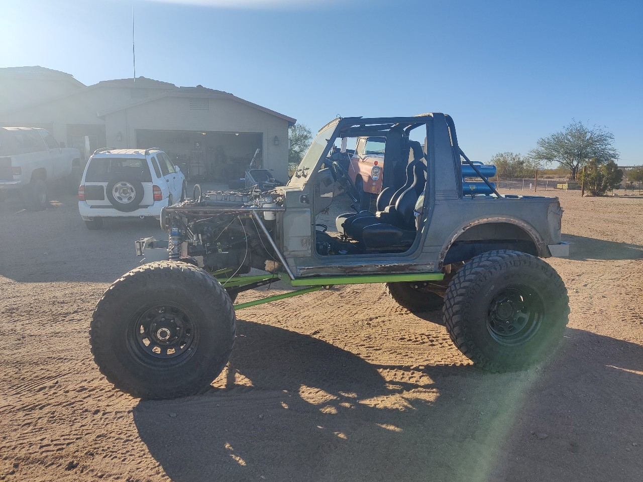

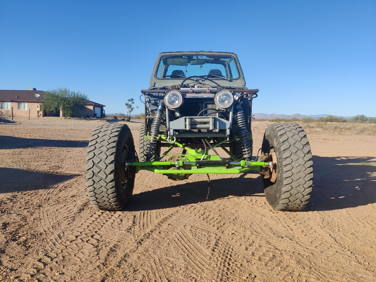

Non tractor application, but it may become a tractor application depending on what happens with this valve...while I've used and repaired the hydraulics on the tractor, this is my first venture into building a system from scratch.
I converted an off road 4x4 toy to full hydraulic steering, using a Char-Lynn 291-5012-001 - 5 port, non load reaction power beyond steering valve, with a double ended balanced steering cylinder and fed it all with a stock automotive power steering pump. I used the PB valve because I had gotten a new one dirt cheap from a shop that went out of business. I initially had just plugged the PB port, found the pump got to be in excess of 400*F within 30 seconds, and had a pump failure shortly after while trying to figure out what was going on.
I did a bunch of searching, learned that the tank port is effectively blocked off when no steering input is given, and blocking the PB port made the valve a closed center. I now have the hoses from the PB and Tank ports tee'd together at the filter input, and filter output flows to reservoir tank. Pump seems happy, steering works well in garage.
1st test drive - front end is all over the road at anything above 25mph, acting as if there is extreme toe in/out. Virtually impossible to keep it running in a straight line. I've played with the alignment a bunch, and got it better, but still nowhere near "right". This isn't something that I intend to be able to run down the freeway, or on pavement at all really, but running access roads to the trails at 10mph is gonna be a bummer too.
Now I'm wondering if using a PB valve without having a need for the PB function is somehow causing an issue with all this? Is my hose routing, with the PB and tank hoses tee'd together causing a problem? Is it possible that the PB is somehow now back feeding pressure through the T port?
I had read where there is a PB sleeve that's supposed to be installed, but I also couldn't really find a clear answer on whether this is a requirement on all PB valves, or if it's needed when not using the PB function. It also doesn't look like either the PB or T port on my valve could have that sleeve added anyways, as in the ports aren't machined in a way that would provide room for a sleeve to drop down in to them. I have considered just ditching this valve, and buying a non-PB valve, but I really dislike just throwing parts at a problem without a clear understanding of why.

I had a feeling it was still some sort of alignment issue, but as I also don't yet have a firm understanding on the internal workings of the hydraulic issue, I also wanted to make sure I wasn't chasing my tail so to speak, and why I was questioning whether the hydraulics could be playing a part in this. It's not at all a situation of being sure that the hydraulics was absolutely the problem, and more one of "I just don't know". Hopefully that makes sense?
On an alignment machine? No..not unless you consider on jackstands, in my garage, with tape measures, levels, and angle finders a machine, lol. I've found it difficult in the past to find shops willing to work with highly modified vehicles in the first place, and then willing to deal with going outside of factory specs, as absolutely nothing in the suspension and drivetrain is anything even remotely close to factory any more.
What started out as a factory 1987 Suzuki Samurai now has full size Chevy truck axles from a 1985 K20, coil overs front with double triangulated 4 link suspension, Jeep CJ leaf springs rear, running on 37x12.50R17 tires. Front axle was pushed out 14" over stock.
I still haven't yet finished out all the tubing work, axle vents, etc in these pics. But all the suspension and drivetrain is welded in solid.
I currently have the toe in set at 3/16" at the wheel lip, which I realize that toe is set in degrees, but I've done it this way for 20 some years on the other trucks, and has always worked well...Wheels are brand new, so the wheels haven't yet been chewed up, and I figured that was the best place to get repeatable measurements. Caster is currently 7* positive.
I have gone from 1/4" toe in to 1/4" toe out, 1/16" at a time trying to find a sweet spot, and settled on 3/16" as the best so far. Caster I've gone from 0* to 10* positive, again settling on 7*. I'm thinking with the much larger tires, I might just need to go past 1/4" toe in?
All of the suspension and axle work was done at the same time. I didn't have any kind of power steering on the Samurai before I did this, I knew there was no way I'd be able to deal with 37s on the factory tiny manual steering box, and bump steer would be atrocious with that 4 link anyways. I was driving the Chevy truck that the axles came out of for a while before all this, so I'm confident that the axles themselves are OK, and it's an issue with the way I set things up.

Not while driving, but I have been all over the front end looking for loose bearings, joints, heims, etc while on stands in the garage, and have none.

I edited the post with photos, and just added them again as attachments, rather than trying to insert them inline. It gave me problems the first time too, and I assumed it was because I was on a work computer with stupid firewall restrictions. It blocks a lot of free image hosts, free email providers, etc as spam/malware/etc. I'm a security admin and communications tech with wide open freedom on much of the corporate network, but apparently I can't be trusted to check email or look at pictures of silly cats, lol.
If you can see them now, you'll see that tire clearance is not even remotely close to an issue now, and I set up the suspension links specifically to avoid tires hitting anything at full lock. I spent a LOT of time doing the math on the 4 link to ensure that geometry issues don't crop up. Especially with things like axle rotation/pinion angle changes throughout the travel, or the amount of wheelbase change left to right.
Though obviously some changes will occur just due to the nature of a linked suspension going through an arc during compression/rebound, I just aimed to minimize it. I have a spreadsheet of all the numbers if you want to see it. Hopefully the pics show up, so you can see that I've gone well beyond just the typical suspension lift, or just copying a known OEM style 4 link. I don't know of any OEM implementation of a double triangulated 4 link front anyways.
The "bump steer" we usually see on solid axle rigs comes from big lifts on coil spring front end vehicles that end up with different angles on the drag link vs track bar. This also crops up on trucks with push/pull steering, such as full size Chevys with a solid front axle. The drag link ends up with such an extreme angle that the axle cycling through the suspension ends up causing the drag link to be pushed around, which then moves the steering around.
It was my understanding that non load reaction steering valve/orbitol that I'm running would prevent outside forces on the tires from moving them without active steering input, outside of things like slop in the wheel bearings, ball joints, etc.
The steering cylinder on the axle is mounted so that the tie rods are in a straight line as full lock left/right. At center, the cylinder is slightly ahead of where a normal tie rod would be, so that the tie rods on either end of the cylinder are angling back just a bit.

Side to side play - none. I've checked that several times over the build time, and yep..familiar with broken steering box mounts. My other toy is a Chevy K5 Blazer squarebody. I'm pretty sure just about all of those squarebodies ended up breaking steering boxes off eventually, lol.
Steering valve resists - yep...kept forgetting about it when I was building, and had a few WTF moments when I went to move the tires over the other direction, and couldn't figure out why I couldn't just push on the tire to move it. Then remembered why :D
Caster - I didn't feel any difference between 7* and 10*, so I just dialed it back to 7*. Biggest problem any solid axle 4WD rig when lifting them is the pinion angle. Go too far, and the front driveshaft u-joints bind when the suspension droops. Go WAY too far, and it binds at ride height. What a lot of guys end up having to do on big lifts on stock style suspension is cut the inner Cs off, then rotate them back and reweld to get a decent pinion angle and enough caster in there. I have my 4 link set up to minimize pinion angle change, so that I have less than 5* of change from full compression to full droop. Or in other words, as the suspension drops out, the axle rotates to keep the pinion pointed at the t-case output the whole time. I also have the front axle pushed out 14" from stock, and set up ride height to stay relatively low, which helps tremendously in minimizing the driveshaft angle.
Ended up getting called into work today, so I didn't have much time to play with it. Didn't have the steel on hand that I thought I did to make the alignment bars, so I did some quick and dirty tests, by dialing in all the toe-in I could just by collapsing the tie rods as much as I could, and ended up with noticeable toe in just by looking at it. Found the left/right centering of the axle was 3/4" off, and fixed that. Dialed in a noticeable amount of additional caster. Really wasn't looking for specific numbers at this point, just more of a "what happens if I throw a bunch of toe in and more caster as it?".
Result - drove a TON better. It's still wasn't "right", but it's night and day better than it was. Then a little voice in my head said to double check coilover charge pressures at this point. No idea why, but I'm glad it did. Turns out I completely forgot to charge them after installing them...oops. After putting in 200psi of nitrogen, it got better again.
It's still a bit twitchy, but definitely feels a lot more now like it's being induced somehow by how the suspension is reacting to the road surface, and not by my steering input. I was able to comfortably get it up to some decent speeds in the dirt without feeling like I was riding a real fine line with death on the other side, but pavement running is still a bit off, where keeping inside a lane is doable up to about 55mph, but hitting a bump is still unpredictable in how it's going to react. Realistically, I could call it good here, and move on, but now I'm really curious to see just how good I can get it dialed in.
