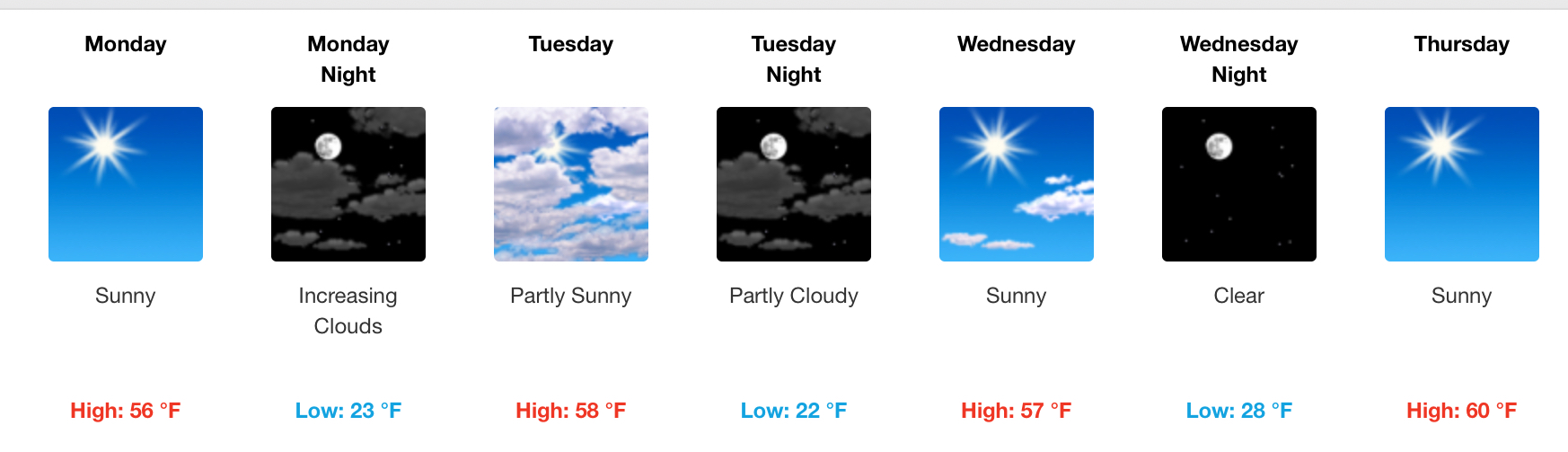

I really need to pour some concrete in the next couple days. Not a big area about 6遅12? This is the forecast.
Never poured when below freezing temperatures were forecast. What precautions do I need to take?

You should not pour it on a surface which is frozen. Sometimes you have to make an enclosure and heat it to thaw the granulars and soil.
You need to order the concrete heated i.e. made with hot water so when it arrives on the job site it is protected for a while.
Concrete generates heat as it cures, but a limited amount when the slab is thin
You need to have a 6' high wind barrier in place to stop wind sweeping across the surface. I would consider insulating the forms in some fashion. Often straw is used.
You need to have insulated tarps on hand. Essentially like bubble wrap in tarp form. Put them over the surface as soon as finishing is completed.
If it is going to be very cold, the tarps should be elevated above the concrete and heat added to the enclosure.
Do NOT use an open flame heater as they produce CO2 which is harmful to the quality of the concrete.
You need to keep the concrete above freezing for at least 7 days, preferably more as the curing time is 28
The sooner you stop keeping the concrete warm, the curing process stops until the temp rises so it will not have its full strength.
You need to have a way to monitor the temp within the enclosure so if things are starting to get close to freezing temps, you can take more drastic action.
Leave the forms on as long as possible to protect the concrete edges.

DaveM comments are correct but over kill for your weather forecast.
You could probably pour concrete with no protection and have no problems with your forecast. Slight protection is all you need

Thanks guys. It was a slab. 6' x12' x 18" thick. Certainly didn't need to be that thick but the concrete company has a 4 yard minimum and I have an excavator so why not. Truck didn't arrive until 2PM today. We got it poured but when it was getting dark it was still not set as hard as I would like. I went ahead and did the broom finish but it was a little too wet. We bought a a 12x25 insulating concrete blanket and doubled it up and put it over the pour. We will see. The finishing didn't go as well as I had hoped in these cooler temps. Normally we pour in the summer and it is all you can do to finish before it is too late.
/ Pouring concrete in the cold #10
At 18” thick you will have nothing to worry about. That thickness will generate enough heat to prevent freezing with Your forecast. With 4000 psi mix , the concrete in Ohio has enough strength by day two that freezing is not a concern
