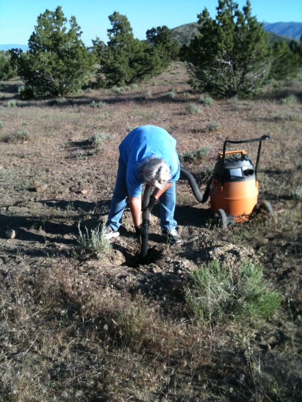

Dug a whole bunch of really nice 9" x 4' holes for the llama corral today.
Problem is they have to be a full 4' deep and a regular hand porthole digger will not close enough to hold the dry loose dirt.
The wife is threatening to getting my shop vac and have me string 500' of extension cord.
Any ideas on how to save my shop vac and get me out of just saying "Yes Dear " for the next few days ?

Ill be dammed, the shop vac worked !
Real quick and the boss is happy.

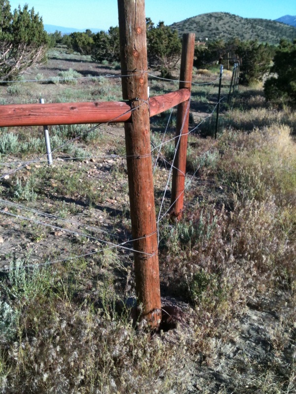

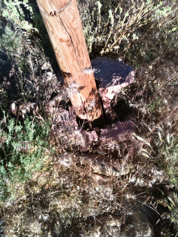

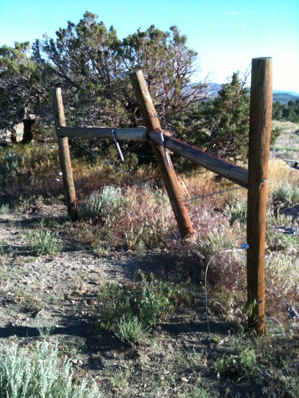

I have attached some pictures of what I am trying to fix.

A corner post should have an additional brace -- a diagonal running from just below that horizontal one down and over to the adjacent post to be fastened to it near the ground. Also, loop a wire between the posts just below the horiz brace so they can spread.

Isn't the triangle already there with the use of the "X" made out of wire?
/ Posthole Conundrum #27
What would the additional brace accomplish?
This brace resists the tension in the wire which causes a torque on the post causing the post to lean in the direction of the wire.
If you look at the pictures you will see that the corner posts were "braced" with an X between them and the next post in line in an attempt to strengthen them. Unfortunately theses wires are only strong in tension, and provide no compressive resistance. You need a wooden brace from the top of the corner post to the base of the second post in both fence directions in order to keep the corners upright.

That is what the horizantal wood brace is for. Which IMO should be at the top of the posts, not near the middle.

I agree - there's nothing wrong with the brace design. It doesn't look like the posts were well tamped. The corner post came up and it would do the same thing with a diagonal brace under compression.

After doing some research on fence corners, I stand corrected. The horizontal top rail plus the wire X is an acceptable corner for a wire fence.

Looking at the pictures of what you're replacing, that corner looks to be wider than 90 degrees. That can be a little harder to brace and not have it lean into the corner. You may have better luck using a double corner post (one for each side with non-tensioned wire between). Or adding an additional brace splitting the angle of the corner.

I agree. Looks like the original builder tried to rely on a sack of sackcrete to hold it in the ground.
