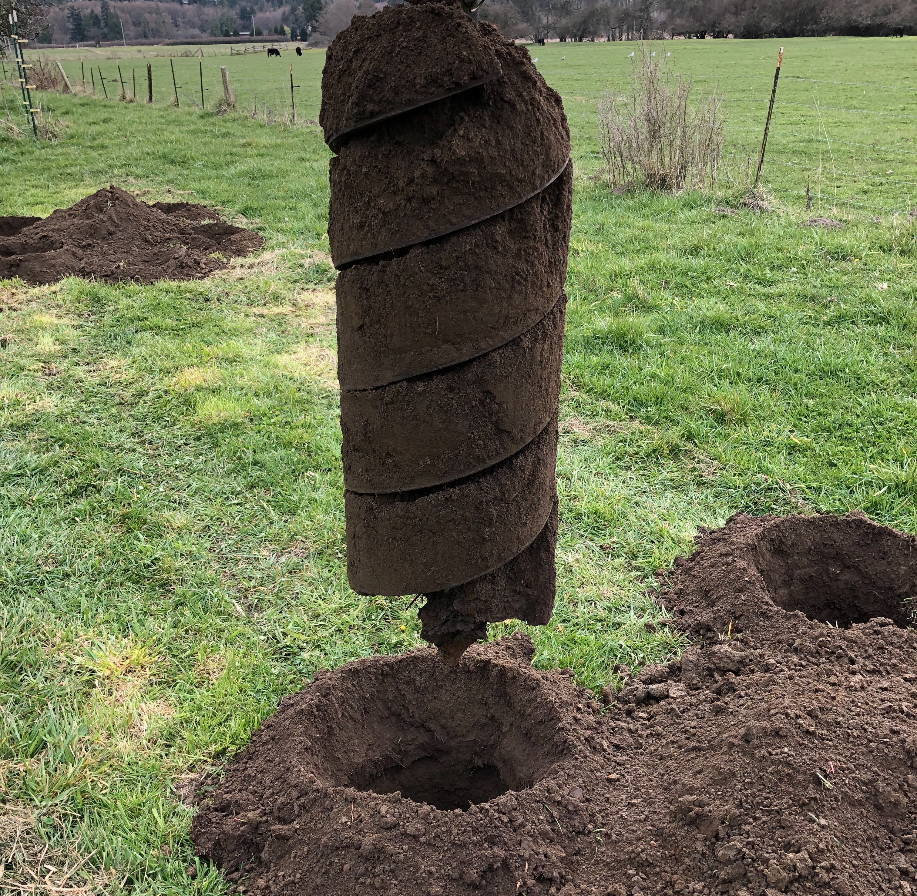

That property is a little over 100 acres and averages about 6 feet above high tide, stays green year around. Some clay mixed in but is still drains. At times I hit the water table at the bottom of the hole, but not this year. Sea level rise will make for good clam digging.
