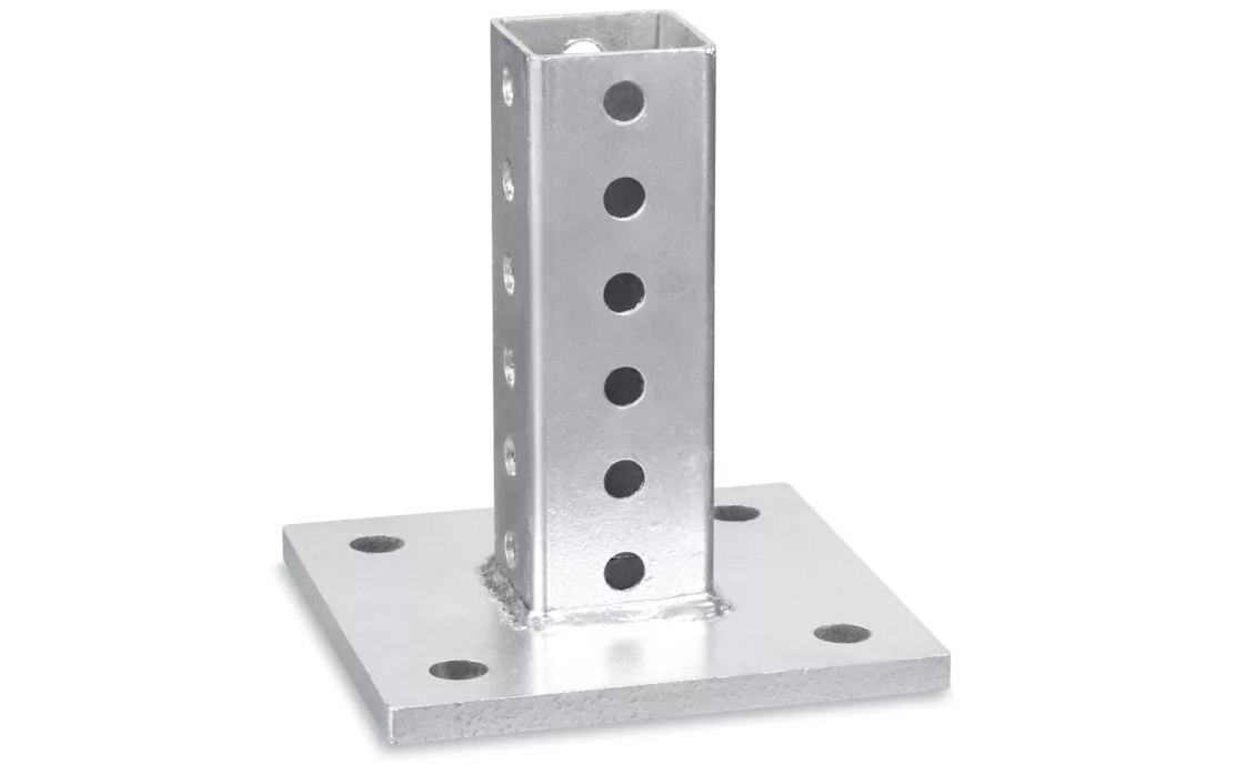

I don't bother trying to dig holes in solid rock to hold a post. I use these square post anchors and fasten them to the rock ledge with four masonry bolts. 10 minutes with a cordless drill & masonry bit and their as solid as the rock their bolted to. Take advantage of the rock rather than fight it.
They can get pricey if you need a lot of them, so I make my own by welding a piece of square stock to a 6" x 6" x 1/4" plate.
Most times, they outlast the fence post. I have some that have been in the ground for 20 years.

Makes since. Do you use these for corner or gate post also?
   / What to dig post holes with in rock? #13
I have one corner post where I had to use a larger 12' x 12" plate with 6 bolts. It's held well for several years now but I don't over tension the wire.
Not sure how it would work with a heavy gate though.

How are you attaching the post to that base?
