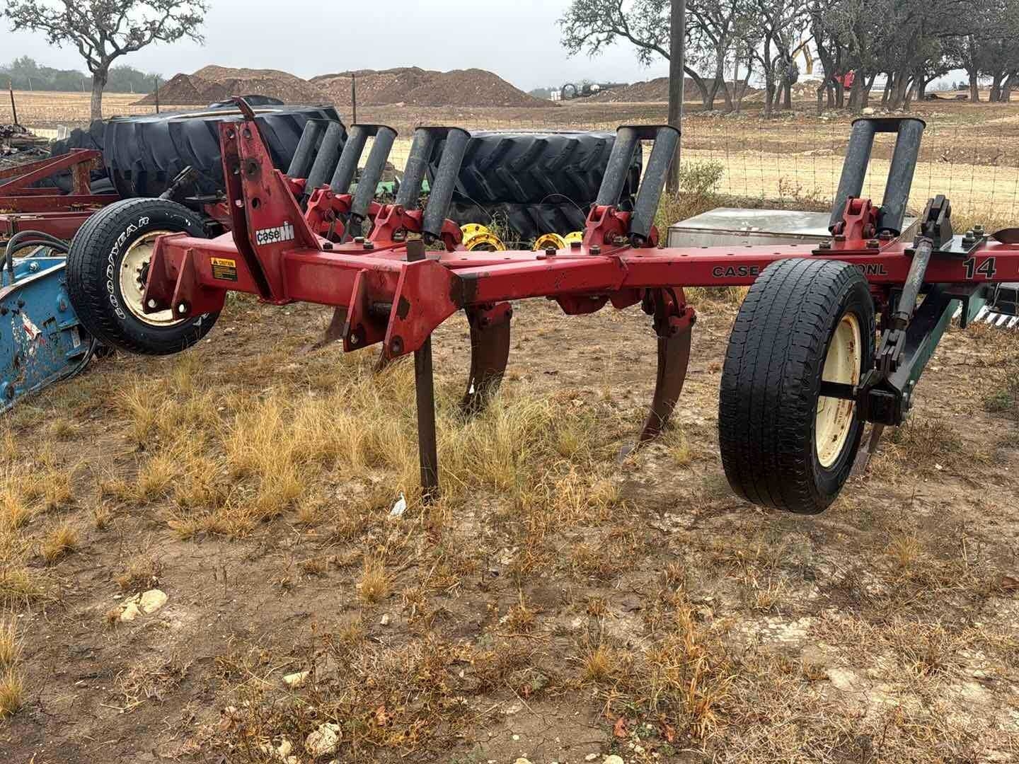

Had to check out this thread based on the listing:
