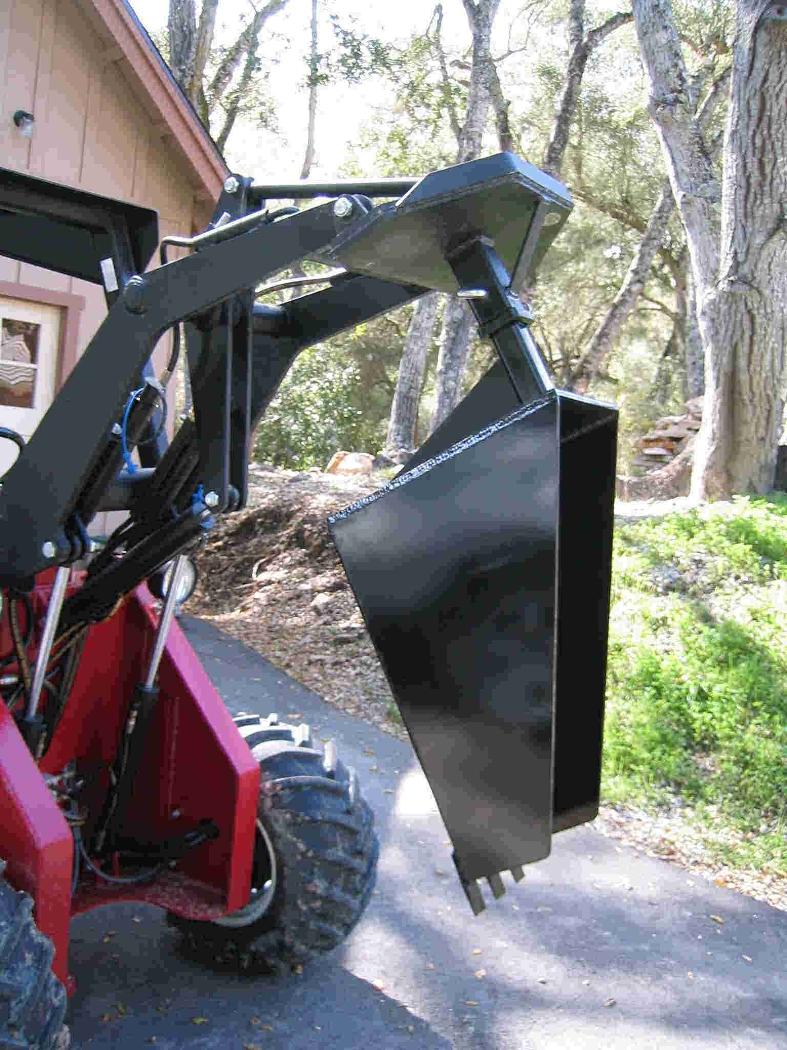

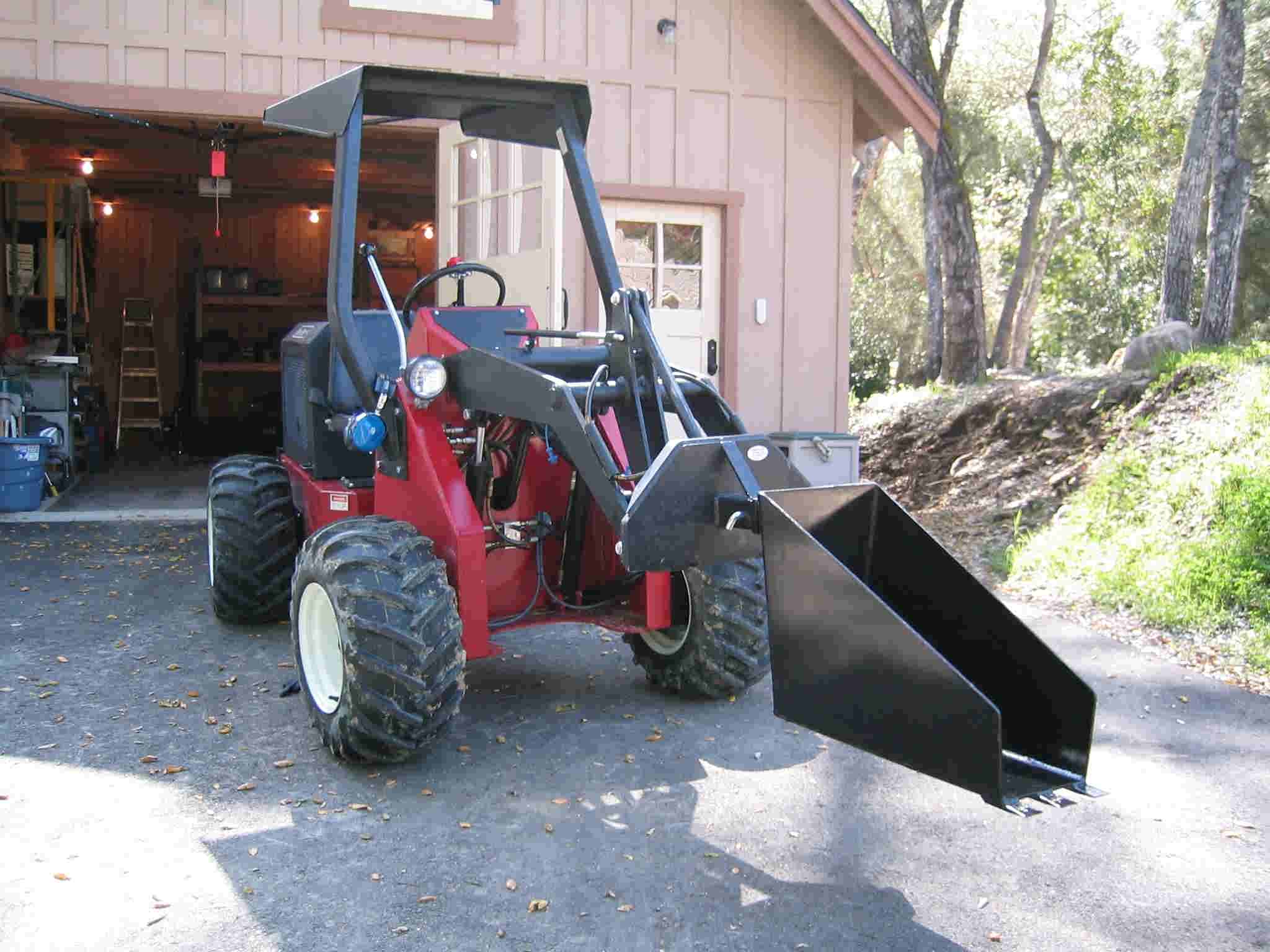

Attached is my vesion of a trenching bucket that could also be used to clean one dug with the minihoe.

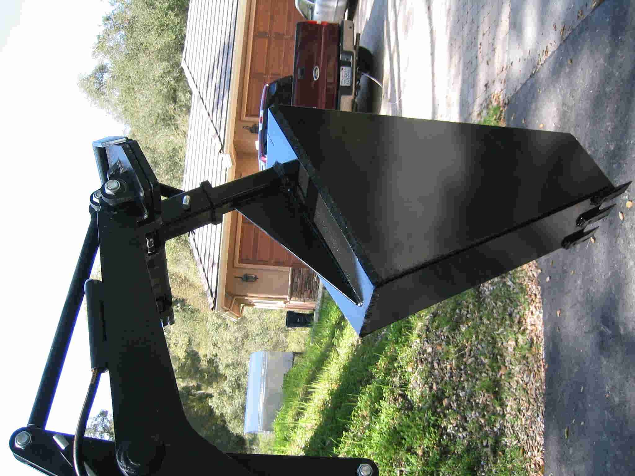

   / Post Trenching Trench Cleanout - MicroHoe #65
And another from the back that shows how it is attached

Wow! Awsome Job! Nice PT too /forums/images/graemlins/laugh.gif
   / Post Trenching Trench Cleanout - MicroHoe #67
</font><font color="blue" class="small">( Attached is my vesion of a trenching bucket that could also be used to clean one dug with the minihoe. )</font>
Wow! Nice job on a handy tool...
There'd be a market for those, since PT doesn't seem interested in building "grubbing buckets"... /forums/images/graemlins/frown.gif
   / Post Trenching Trench Cleanout - MicroHoe #68
You are very good at fabricating and welding.
Keep those projects coming.
PJ
   / Post Trenching Trench Cleanout - MicroHoe #69
Thanks but I can't take all the credit. I designed it, cut the materials but had a local fab shop weld it up for me. They charged me $150 to supply the tube and weld up all the pieces and they even painted it.
   / Post Trenching Trench Cleanout - MicroHoe #70
Nice job, I was getting ready to ask if you folded any of the pieces and welded the rest, but you said some one had welded the unit for you. You still get the credit for the design. Is it the same width as the mini-hoe?
