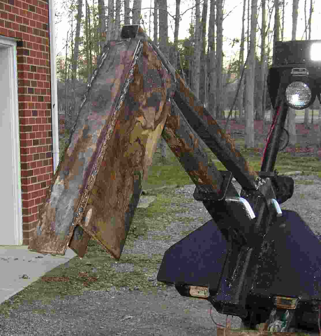

If the bucket is to be used for trenching, the body of the bucket can be as narrow as you want, and longer so that the attaching plate never has to get in the ground.
This is a bucket that I built from a kit. The backside of the backet is 4 in.

That looks good. Where did you get the kit?

From a guy in Canada, who laser cuts parts. You could use any bucket as a model and make it the size that you want.

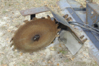

</font><font color="blue" class="small">( Another thought would be, after trenching with the chain trencher, to run down the trench line with something like that yellow scoop at the depth you want.
I also have one of those old U-Haul rental trenchers . It digs with a spinning wheel with carbide teeth in the forward direction. It has a rubber flap that the dirt is thrown over and is deposited about 6 in from the trench. It can dig just about as fast as you can push it. Pushing is the tough part. I was thinking of modifying it so the PT could pick it up and provide the push power. )</font>
That sounds like the PT wheel trencher or the older model stump grinder with fixed teeth. ( Reversed of course ).
   / Post Trenching Trench Cleanout - MicroHoe #25
No, is not like the old trencher/stumpgrinder. It digs a trench with PT driving backward. The wheel can not be reversed. It has no flap to deposit dirt away from the trench. The teeth are fixed. It does makes a decent trench
