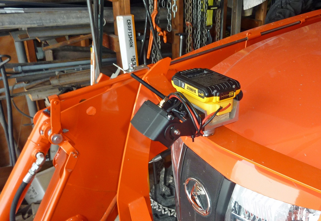

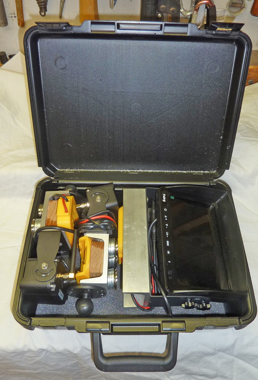

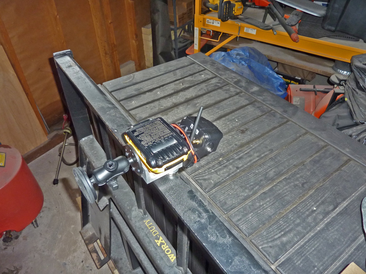

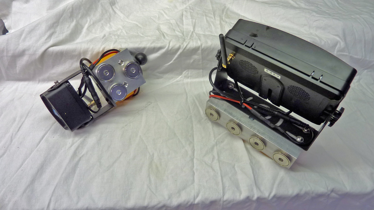

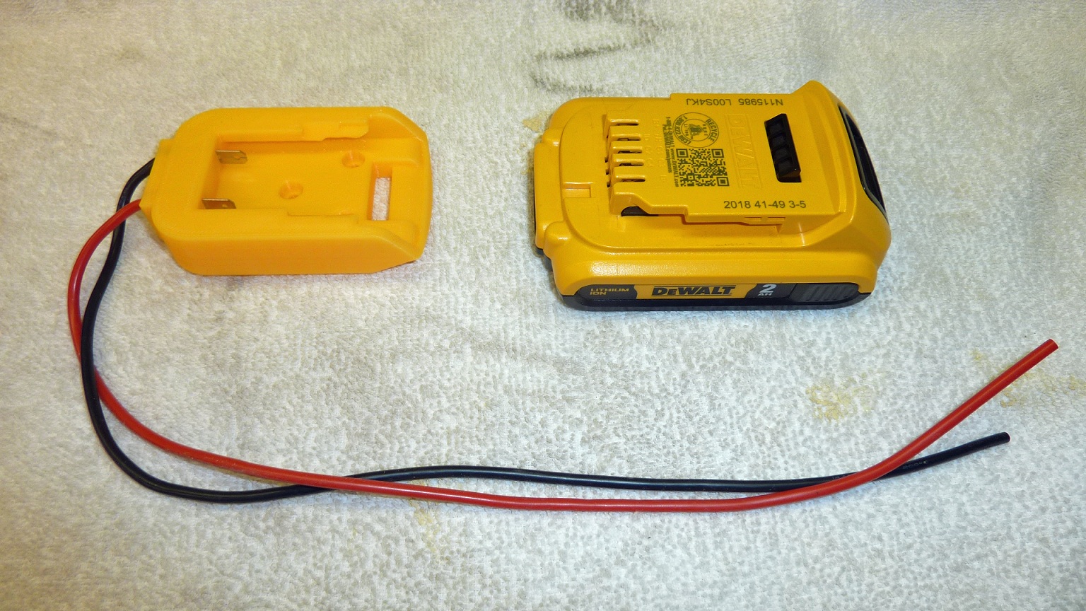

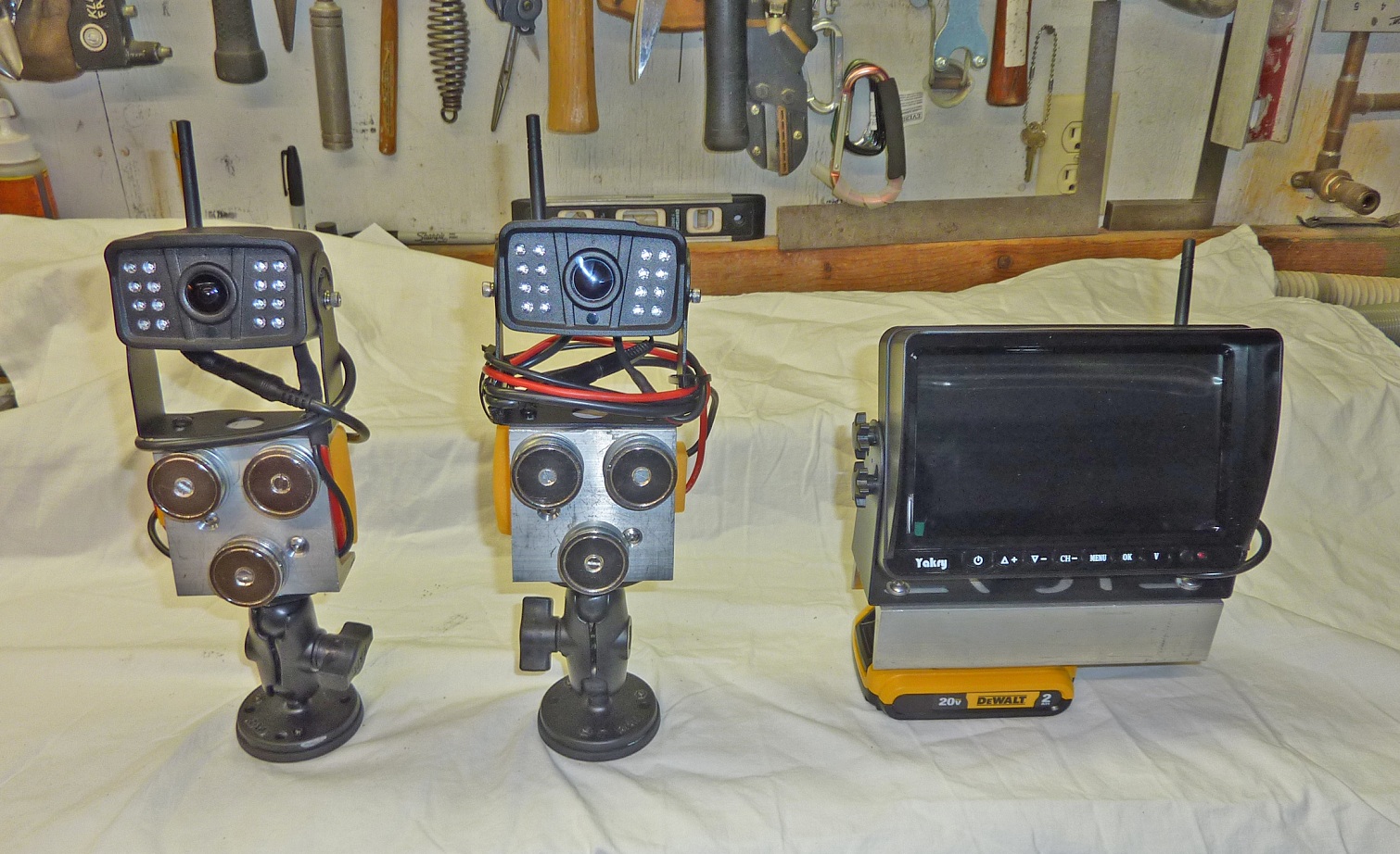

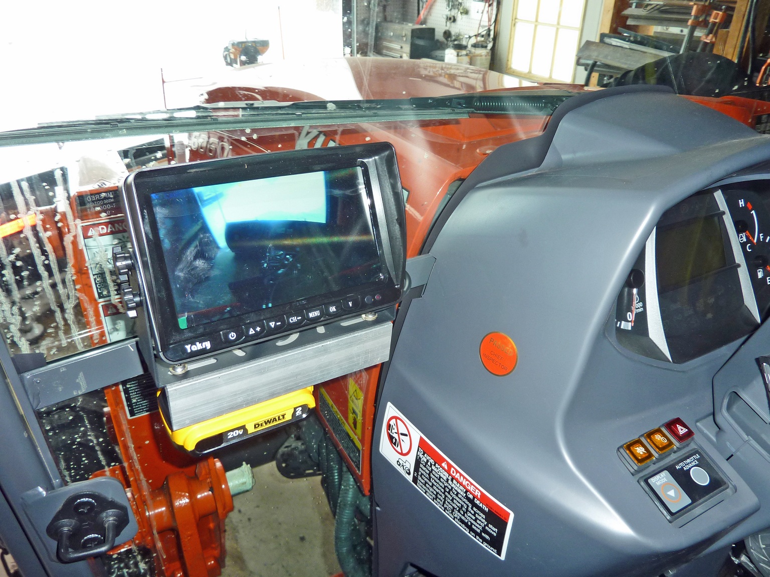

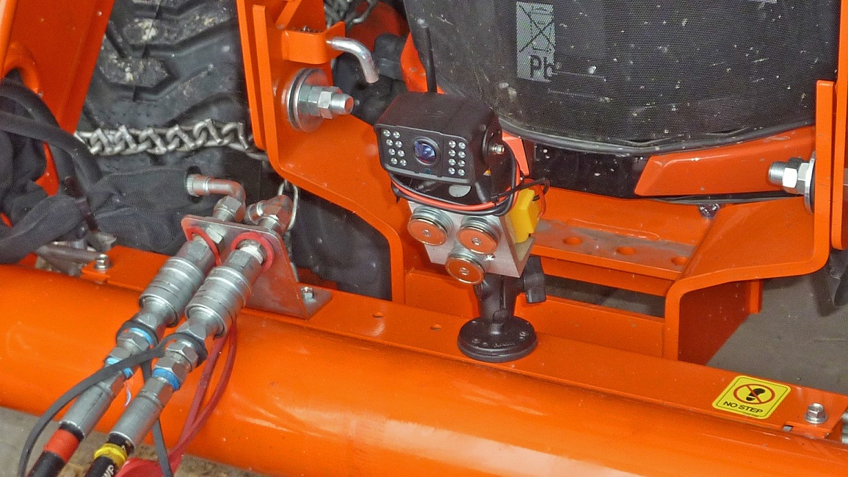

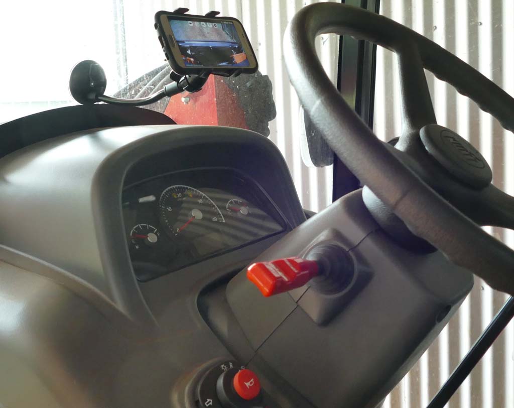

I have a fairly cheap wireless camera system I use on one of my tractors. I occasionally need to use a camera on other equipment as well. Rather than buy multiple cameras, I converted the one I have into a portable rig. Although the camera video is wireless, both camera and display require power. I used cordless tool batteries with adapters (in my case DeWalt), a few strong magnets and some 3" aluminum channel to make camera and display mounts that are truly portable and can be attached to any metal surface. These inexpensive battery adapters are available for most cordless tool battery brands. Even small 2 AH batteries will power the camera & display for several hours.

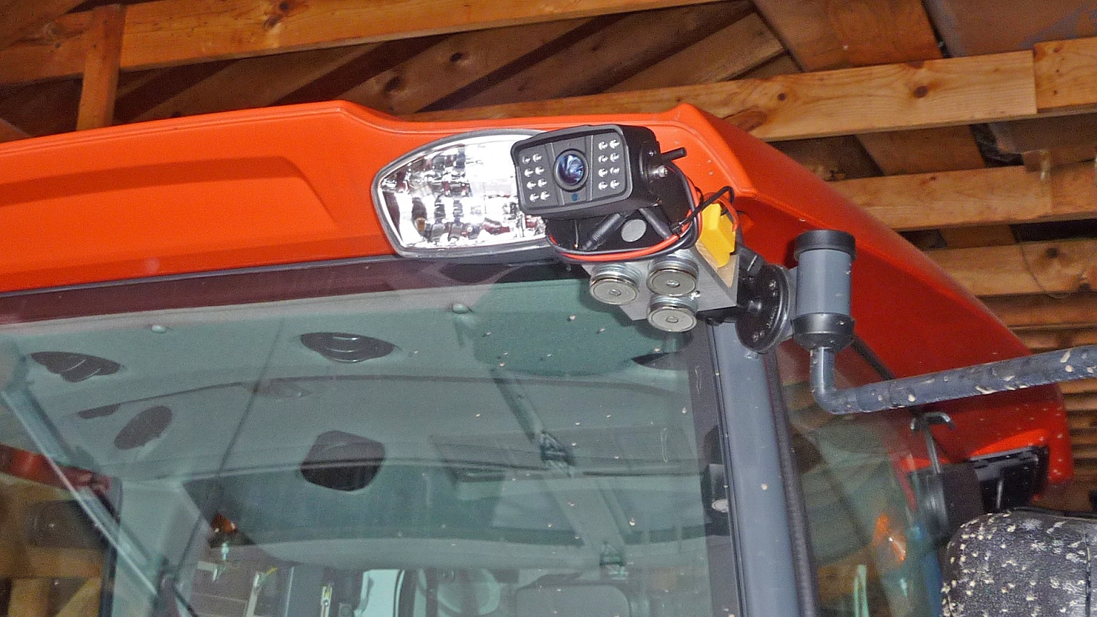

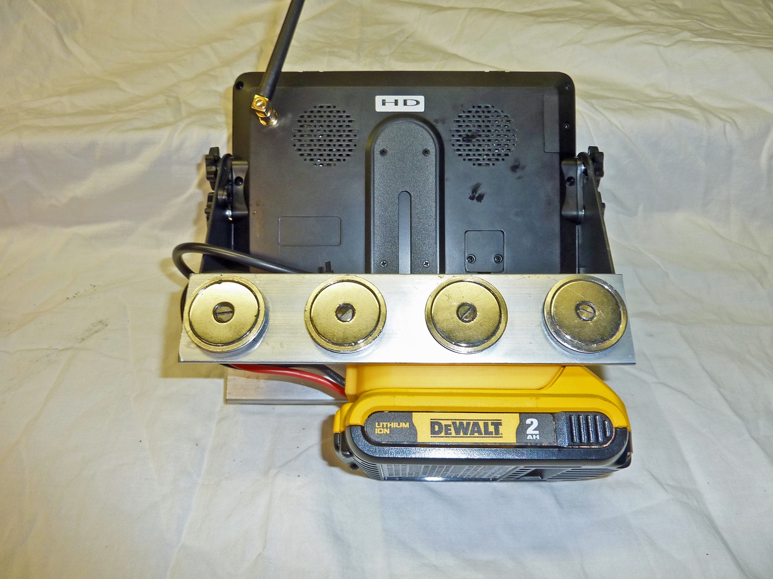

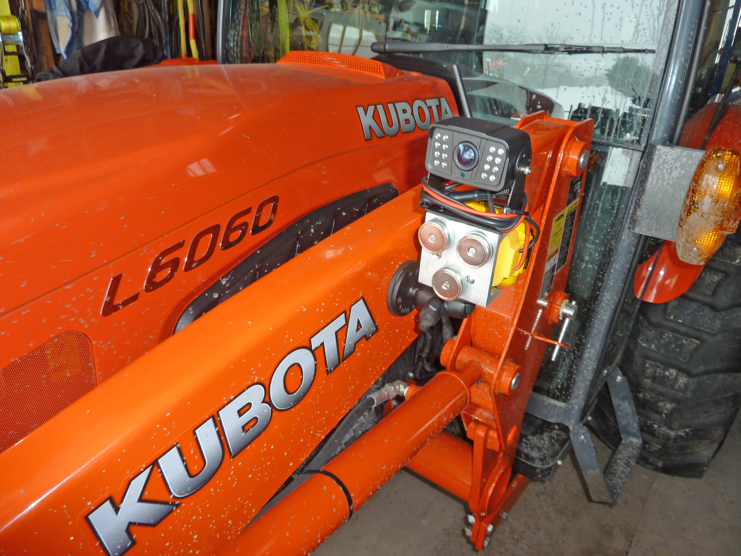

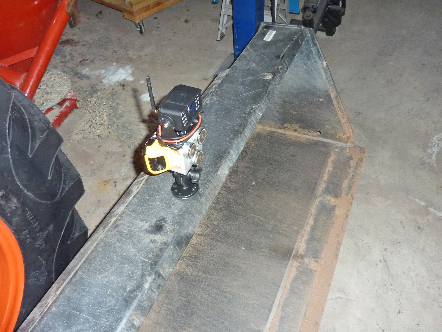

With the cameras hard wired to the tractor cab, general viewing is fine but I often can't see enough detail for some types of work. Lining up pallet forks or FEL SSQA implements can be difficult. Without any wiring, these cameras can be mounted almost anywhere. To increase flexibility, I added a ball / clamp combination from RAM products along with another magnetic base. I store the cameras & display in a case which I carry on the tractor. It can be set up in seconds anywhere it's needed.
P1080754a.jpg P1080751a.jpg P1080750a.jpg P1080749a.jpg P1080745a.jpg P1080744a.jpg P1080756a.jpg P1080752a.jpg P1080757a.jpg

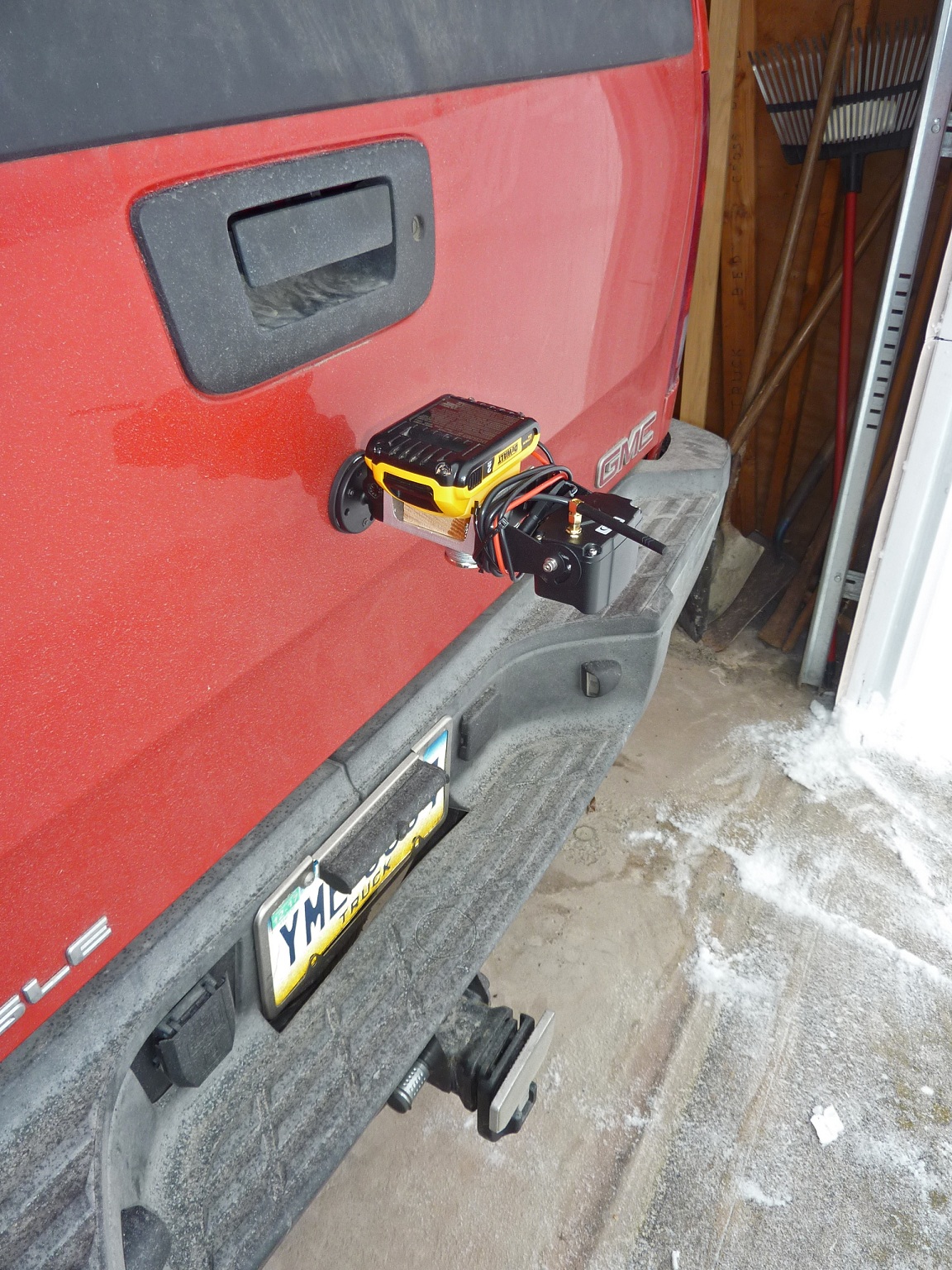

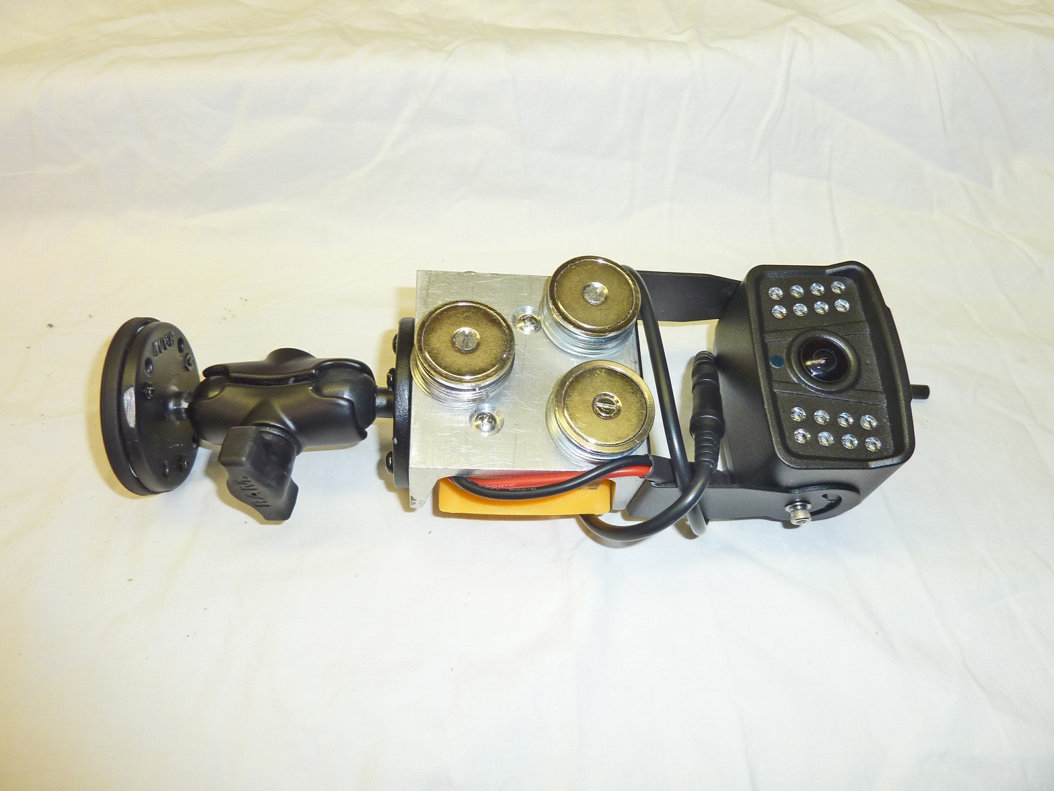

Although quite sturdy, these magnetic mounts aren't meant for permanent use. For general purposes, I rely on the cab mounted cameras and use these for temporary work operations.
Yes, there are portable camera systems available but they are expensive and most aren't meant for heavy duty farm equipment use. They also have proprietary batteries which must be kept charged. This rig costs less than $50 (excluding battery) and uses the camera I already have. I always have a supply of cordless tool batteries charged and ready to go.

I'm not sure if you are asking me or Tractorguy but here is my experience:
I use this fairy inexpensive wireless camera made in China by Yakry: Amazon.com: Yakry Y28 FHD 1:DP Digital Wireless 2 Backup Camera for RVs,Trailers,Trucks,Motorhomes,5th Wheels 7'' Touch Key Monitor with Recording DVR Highway Monitoring System Super Night Vision: Car Electronics
I attached the cameras to the magnetic self powered mounts as described in post#1. to better see what I'm doing with the FEL, I position a camera on the FEL cross member, the lip of the bucket or if I'm using the forks, on the top of the back plate.
I particularly like to use a camera on the pallet fork back plate when working with the FEL at full height. It makes it easy to line up the fork tips.
I sometimes use a camera on the upper lip of the bucket when grading. It makes it easy to see how the cutting edge is contacting the surface and how much material is in the bucket.
It's a snap to line up the SSQA on a implement with a camera on the FEL cross member.
Although the magnet mounts are strong, care must be used not to dislodge them when working material with these implements. They are not meant for permanent installation, just for specific purposes.

The magnets are available on Amazon: Neodymium Cup Magnets, Strongest Round Base Magnets, Hold up to 95 Pounds - 12pack: Amazon.com: Industrial & Scientific
The secondary magnetic mount isn't necessary but I find it's easier to adjust the camera angle in certain locations. The magnet isn't as strong as the ones linked above though. The parts are available from RAM: RAM Mount AMPS Plate Magnetic Base Mount
The system is indeed flexible. The possible camera locations are almost endless. I sometimes mount them off the tractor on a tree, rock or other object near the work site.
Damage is always a possibility but at $80 apiece, the cameras aren't super expensive. If you use the Yakry system:

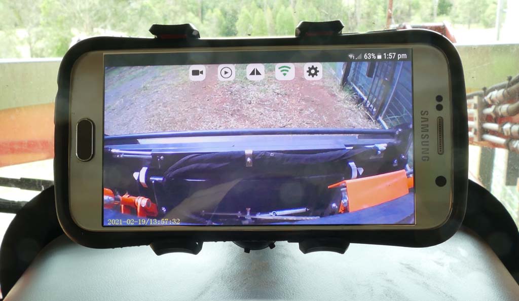

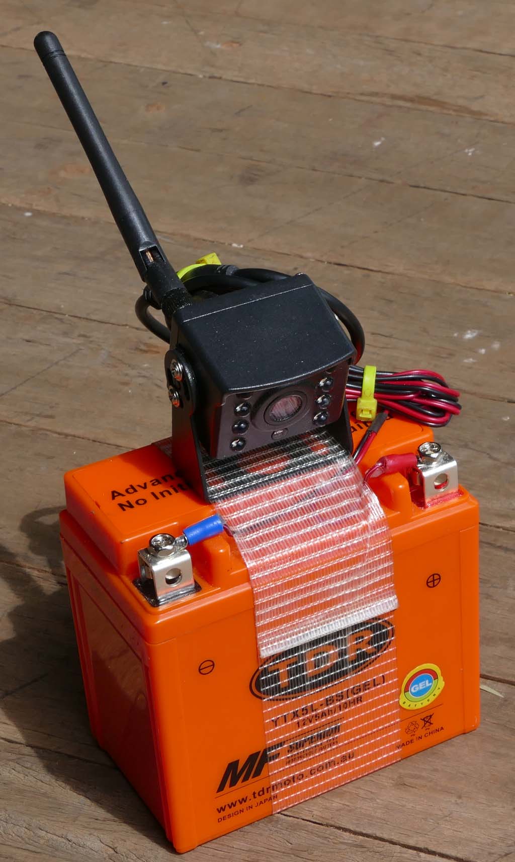

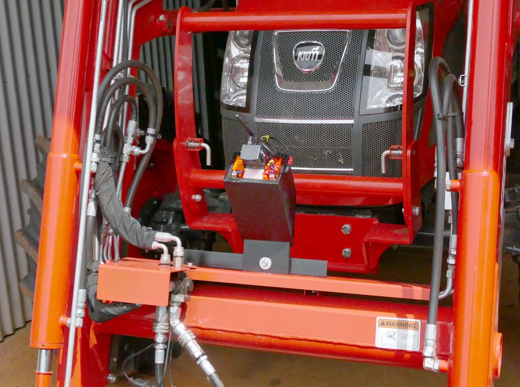

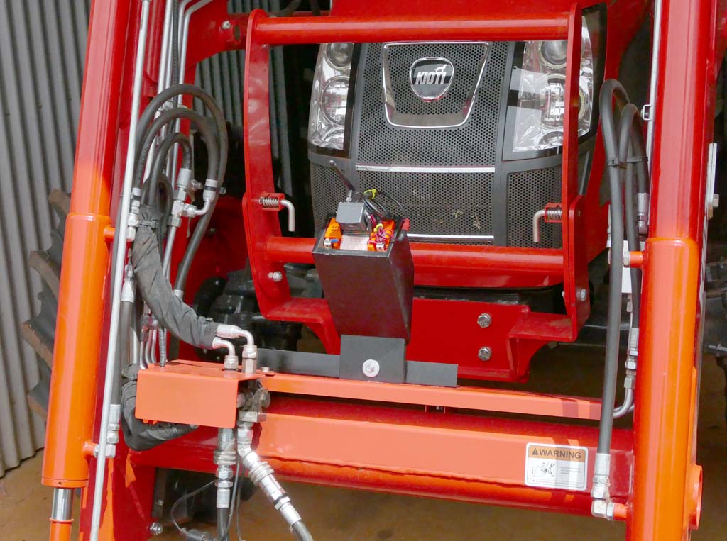

I set up my camera system a few weeks ago (before I saw the clever magnetic mounting idea), and I'm using an inexpensive wifi reversing camera sitting on top of a 5Ah gel battery. The camera is for an Android app called W-Car, and I have a Samsung S6 clamped in a suction-cup mount off the windscreen.
I made up a small box from plywood which is bolted onto an angle-iron strip on the loader crossarm. This arrangement is great for driving into an implement to hitch it up. I've painted the top of the hooks and the side wings white, so even on the small screen, they're quite visible. As you can see from the screen view, the angle of view is pretty good. For use off-tractor, the camera and battery just lift out and can be placed anywhere.
Cost of the bits worked out to around less than 100 Australian dollars (about 78 USD), not counting the phone.
I had some issues to start with. Namely, even though W-Car is an Android app, it didn't work at all well on either of the two tablets I have, nor on a Samsung S5. I then bought a new supposedly high-end Android phone with a magnificent high-res screen, running Ver 10, but still no go. The problem on all those was that there was an initial lag of a few seconds before the app showed what was happening (not much chop for a reversing camera :thumbdown: ), followed by a longer lag of about 20 seconds, followed by a complete freeze of the app. So I tried it out on a mate's S6, and all good with that phone, so I bought a good used S6 for a decent price, and now everything's sweet!
Maybe the app developer only tried his app out on an S6!

Another good idea to do the same thing. In your case, the heavy battery is the mount. This would work well when setting the camera on the ground.
You can spend as much or as little as you want on the video system. The trick is to get the camera as close to the work as possible using a portable, easily movable mount. Most have wide angle lenses which are all but useless at a distance. I can't believe how much easier it is to pick up a pallet at max FEL height with the camera mounted on the forks!
