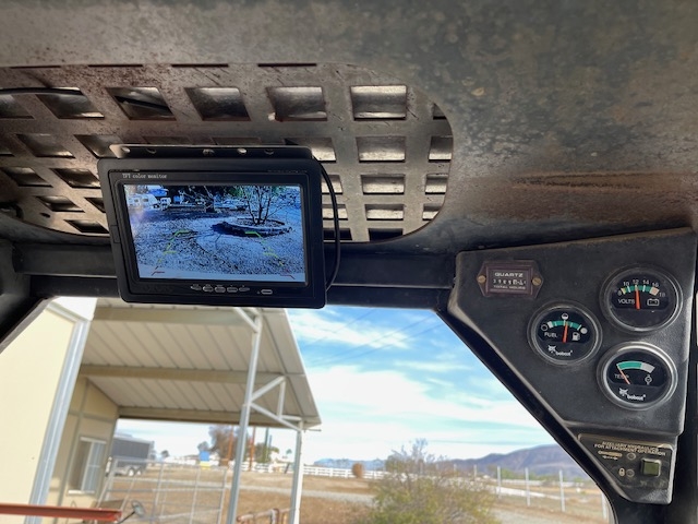

I put one on the Bobcat SS. Actually 2 cameras with different views and one monitor with a toggle switch to flip between views. It wasn't hard to install. Just needed to find a key switch power source and a ground. It works great. Rear visibility is almost nonexistent in a SS. One camera sees far and the other sees a wide angle closeup. Very handy. I can now back down the barn center isle if needed. Amazon has a wide selection of RV backup cameras that will do. Buy the best quality picture you can afford.

I put one on the Bobcat SS. Actually 2 cameras with different views and one monitor with a switch. Works great. Rear visibility is almost nonexistent in a SS. One camera sees far and the other sees a wide angle closeup. Very handy
Can you provide any detail on the exact system?

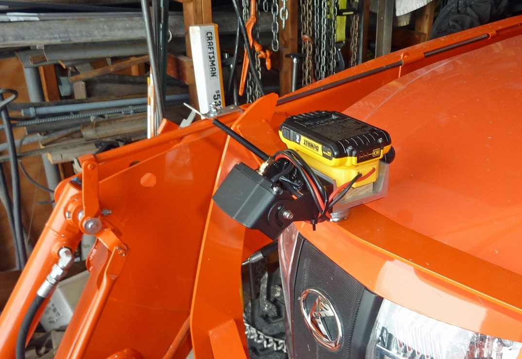

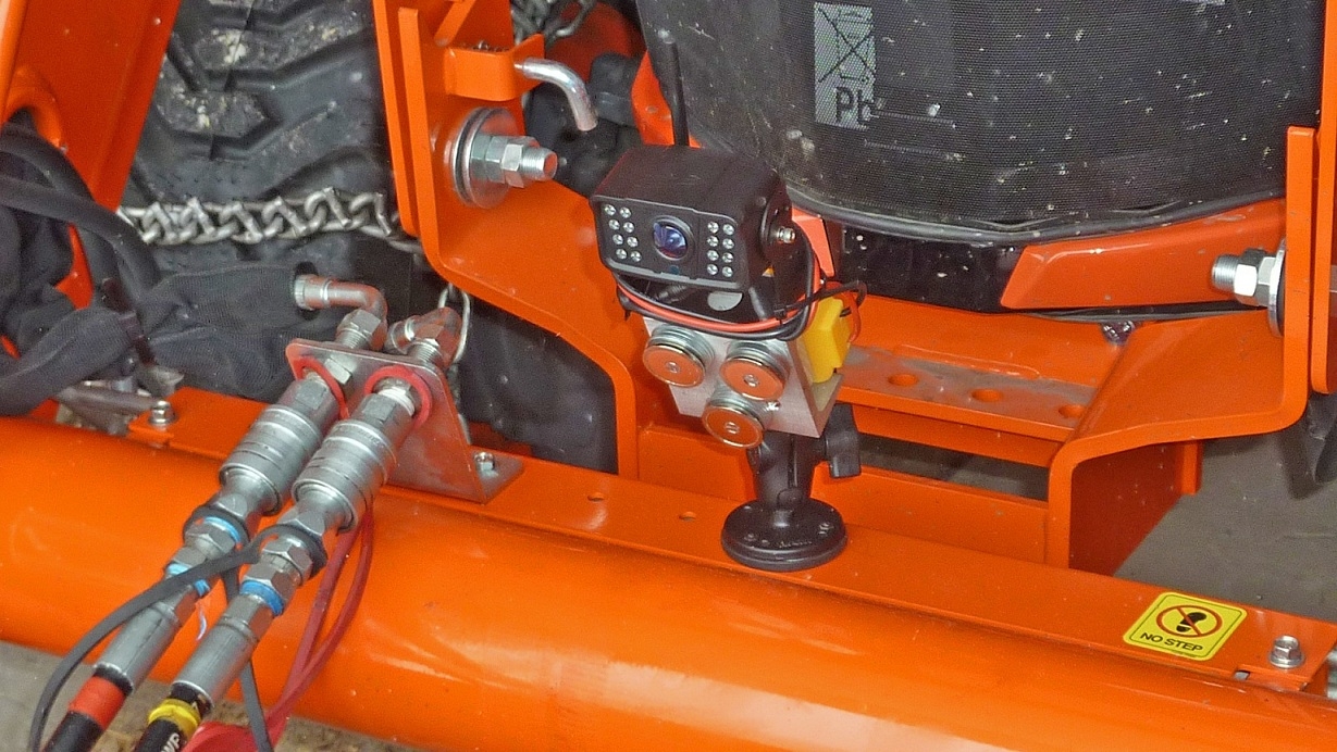

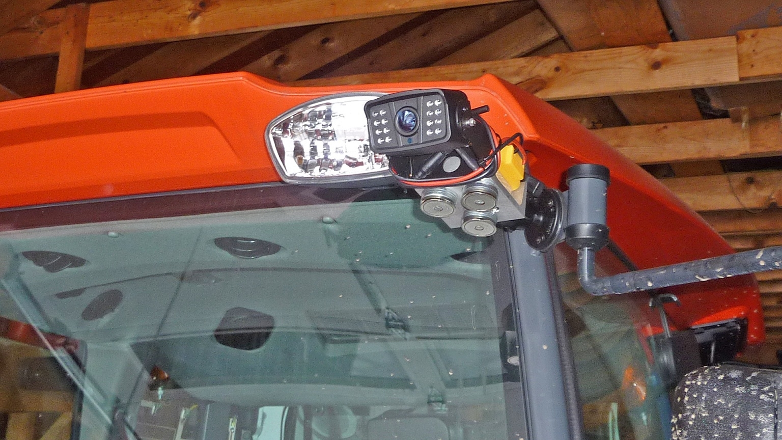

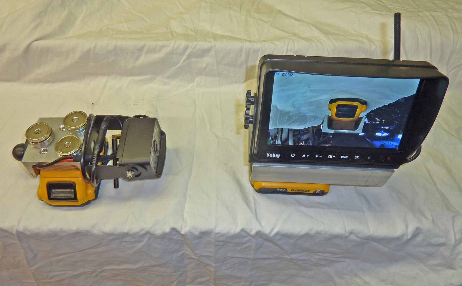

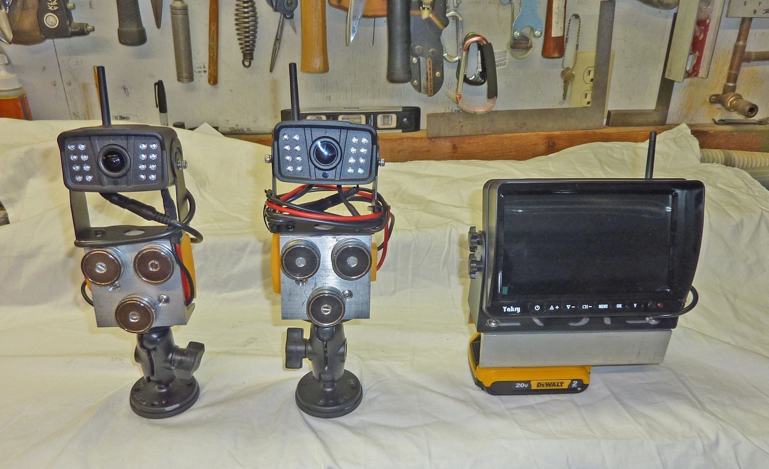

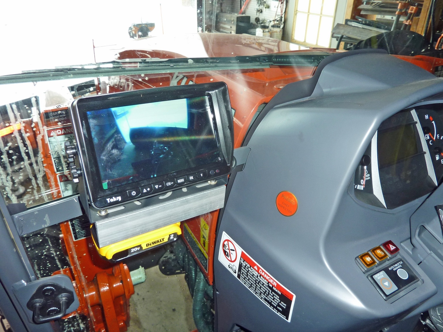

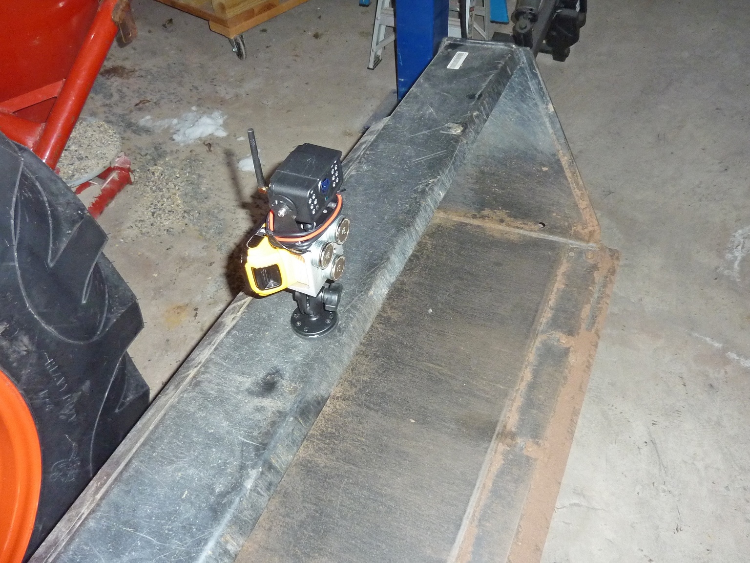

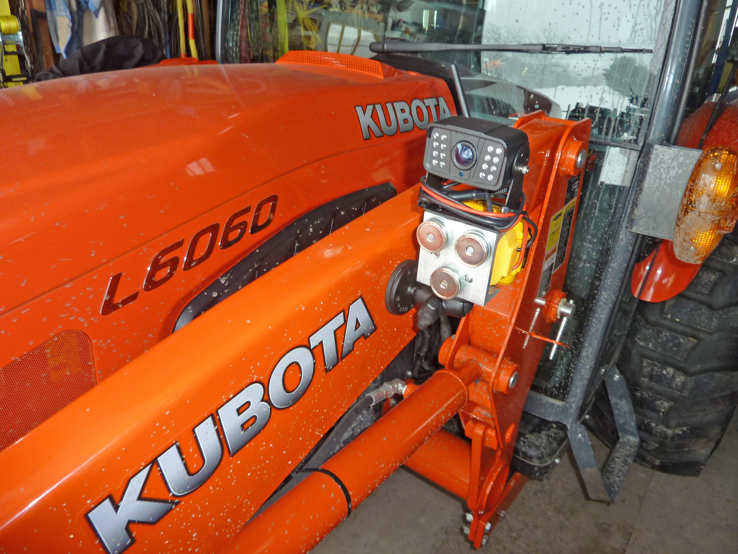

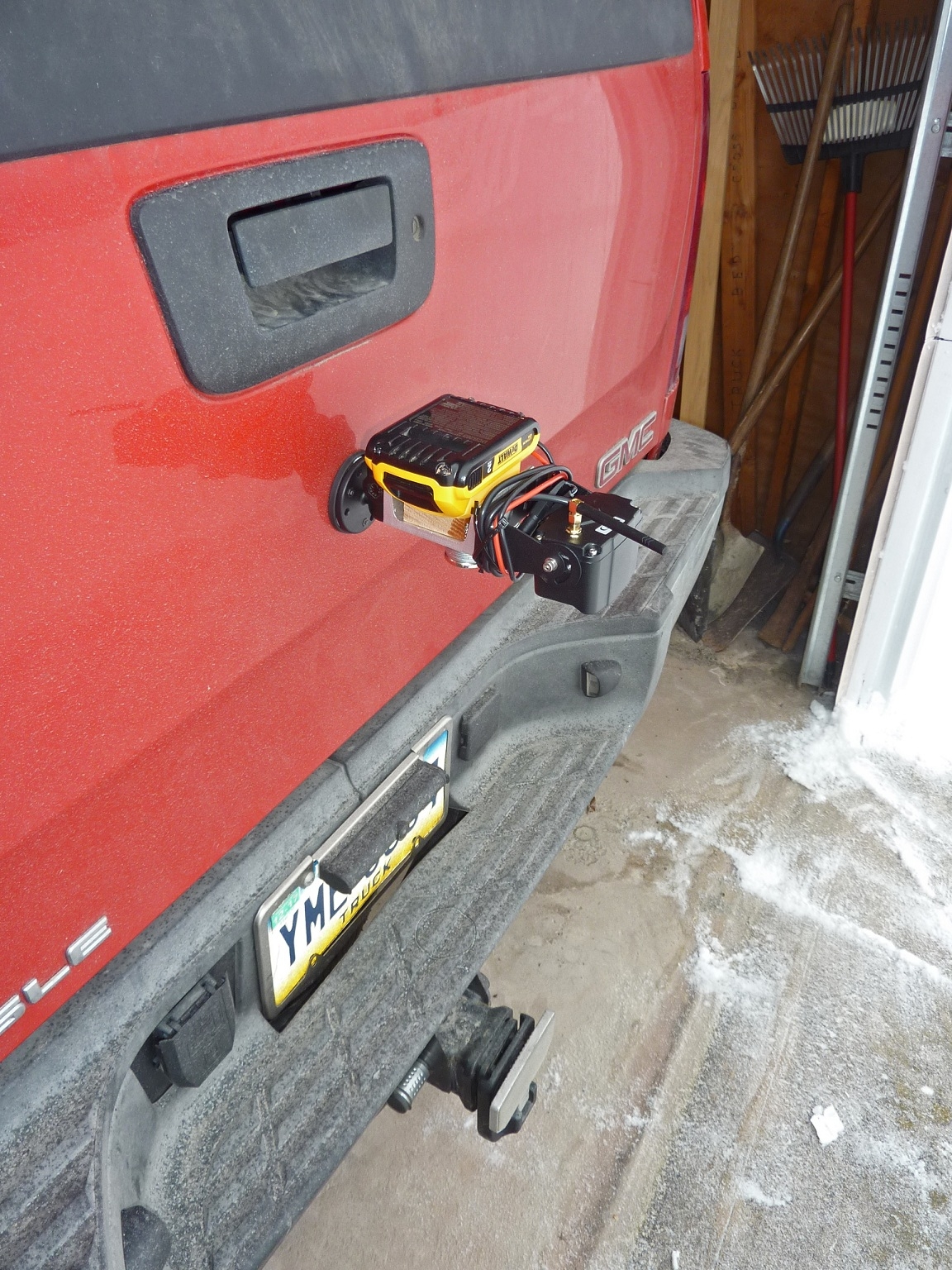

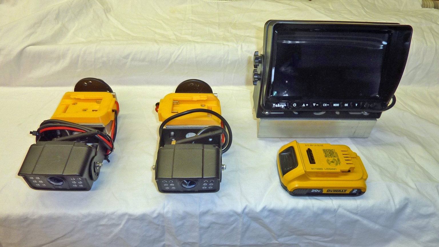

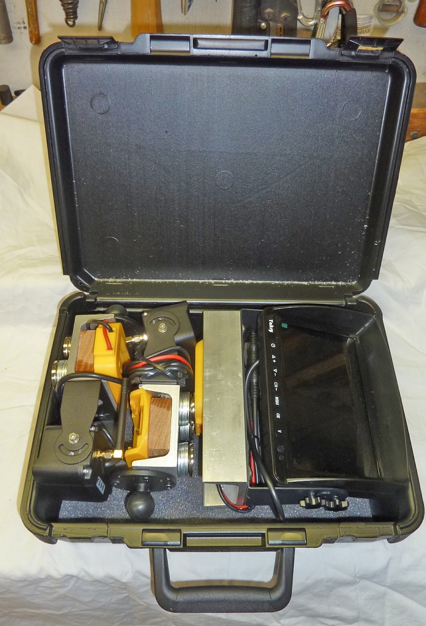

I've found that it's difficult to mount one or even two cameras on a tractor that will show what you need for all types of work. Powering the cameras is also tricky if you want to avoid running wires. Solar is an option but not for heavily shaded areas or at night. I solved these problems by making my own portable camera system.
I took my existing 2 camera wireless system and modified it to use cordless tool batteries. I added strong magnets so the cameras and monitor could be placed almost anywhere. It's sometimes better to put the camera on or near the work, rather than on the tractor.
This idea will work for most camera systems using an adapter for the brand of cordless tool batteries you use.
I don't always need the cameras, so the magnetic mounts are temporary. Most of the time, the system is in a case behind the tractor seat and deployed when necessary.
Not exactly. It's been many years since I purchased the system but searching TFT back up cameras on Amazon brought up something similar here > Amazon.com
The system I bought was around $100 and had only one camera. (best quality picture I could find) I later added a second wide angle hi-resolution camera. I have spent a fair amount of time in a SS in construction and this feature is a game changer.

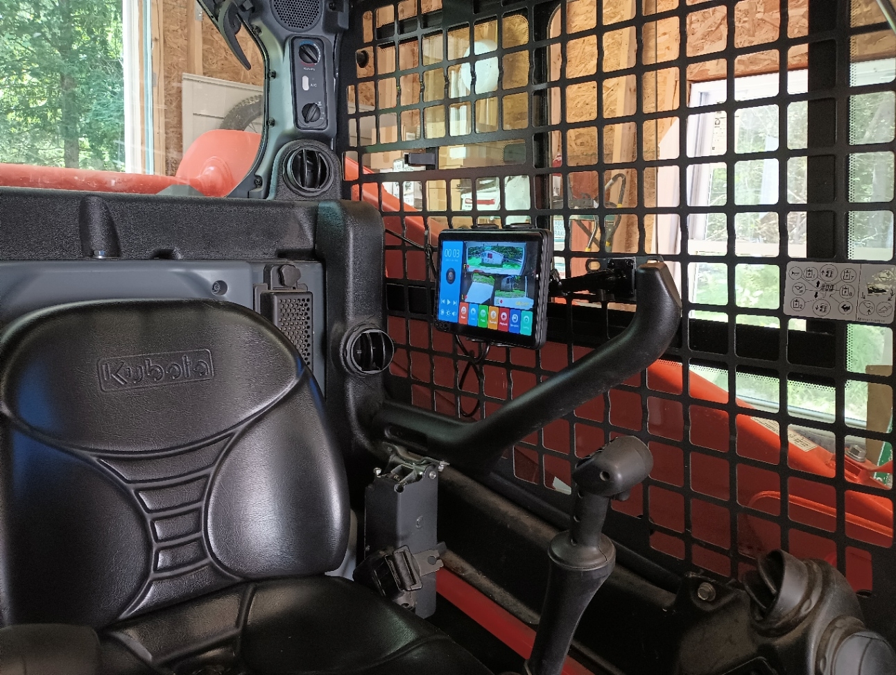

I bought this 4 camera system 9https://www.amazon.com/dp/B0DF7JP228?ref=ppx_yo2ov_dt_b_fed_asin_title )and installed it in my skid steer. I used 3 of the 4 cameras on the rear. No car play, just blue tooth. It was a tight fit in the cab. I used a tackform mount.

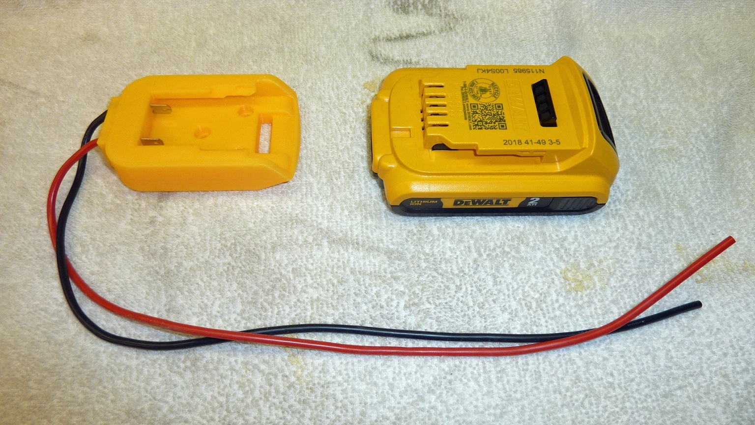

View attachment 4182918 View attachment 4182919
View attachment 4182920 View attachment 4182921
View attachment 4182922 View attachment 4182923
View attachment 4182924 View attachment 4182925
View attachment 4182926 View attachment 4182927
View attachment 4182928 View attachment 4182929
Word of warning: The DeWalt batteries are monitored and controlled by the tool. So, you have to be careful not to over discharge the batteries.
/ Backup camera for tractor #12
Yes, this is true. There is no LVC (low voltage cutoff) in the DeWalt battery BMS. As you say, that function is done by the tool. This is not the case with all brands of cordless tool batteries though.
However, if you do over discharge to the point where the battery will no longer accept a charge, there is a trick to fix the issue. You simply put the dead battery in parallel with a charged one of the same voltage. This puts enough charge in the dead battery for the charger to "recognize" it again.
I've over discharged quite a few over the years and have always been able to get them working again using this trick. Doing this repeatedly will eventually damage the battery though.
