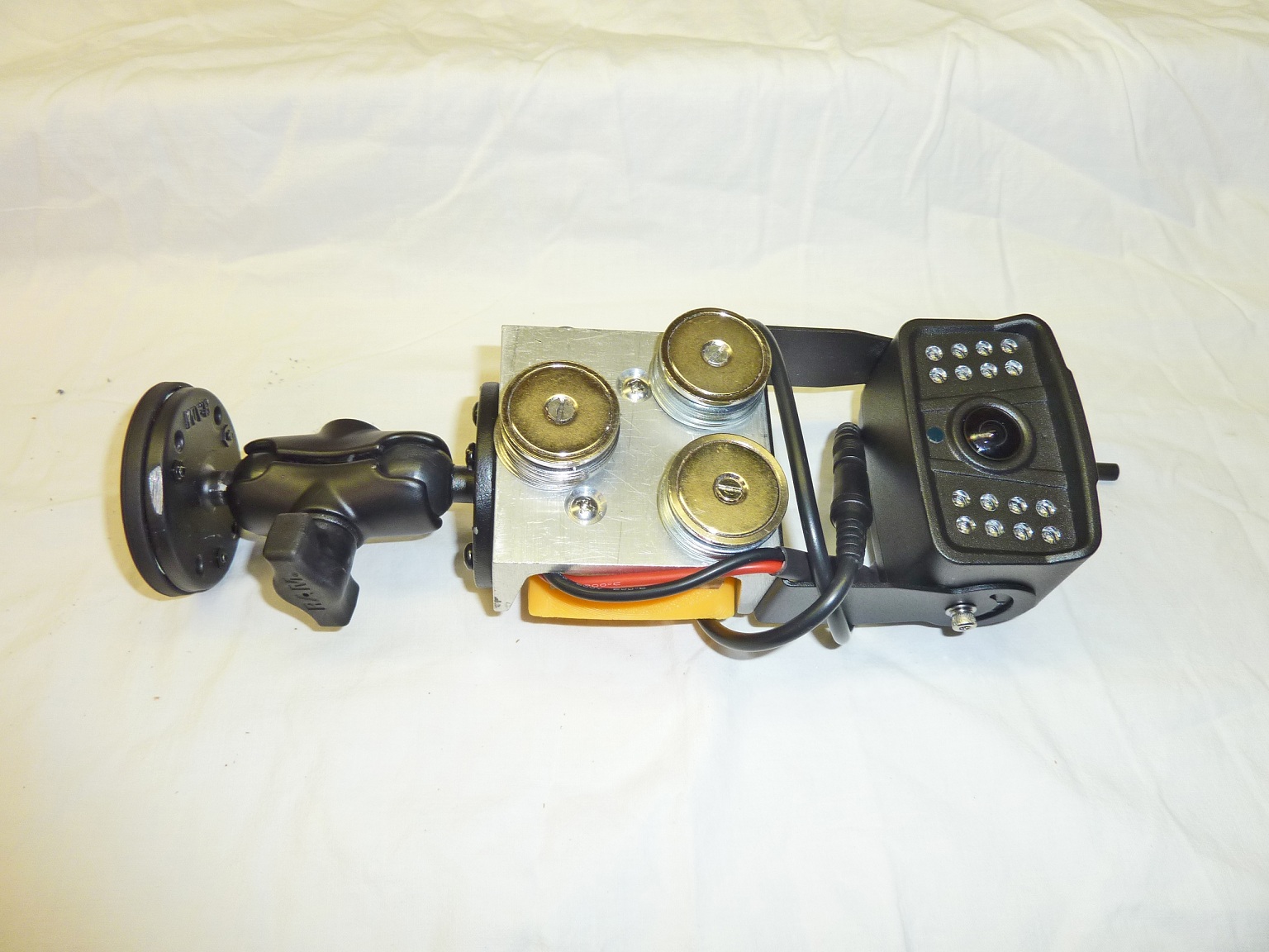

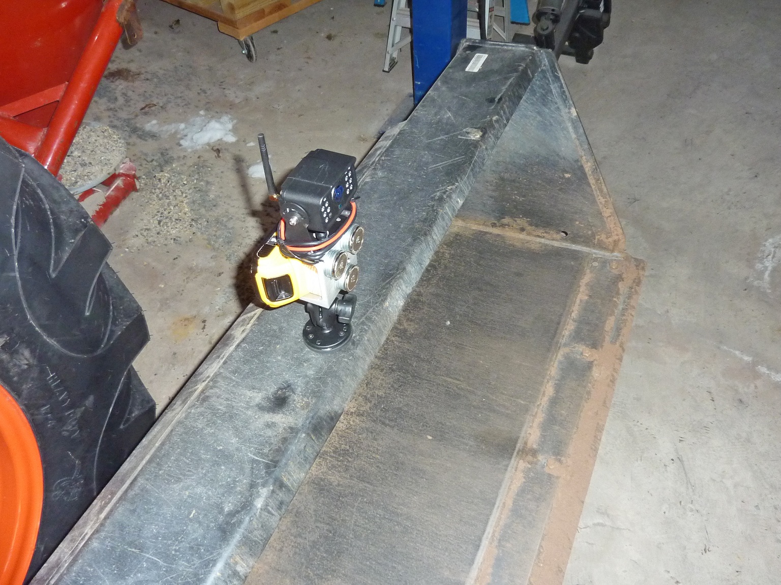

the wireless cam w/magnets may be the answer to my current problem. I could attach cam right to the top of my pallet forks.....to better see when I am trying to lift a pallet of firewood. Tks!

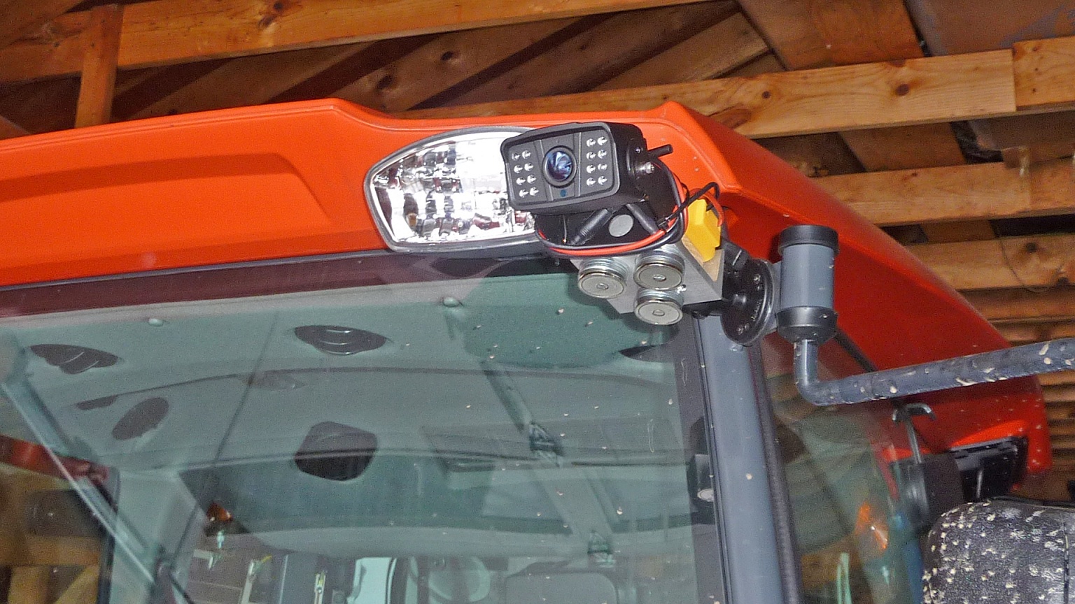

It appears that I probably have the same system as the op. I've got 2 cameras mounted on my dump trailer. One looks straight down the gooseneck so I can hookup by myself without continually jumping in and out. The other looks straight back over the load. When I pick up a load, I have to approach at 90* to the pickup point and back in. The camera helps. There are only 2 problems: 1) The sun shining on the lens washes out the image 2) With the camera on the trailer I really can't tell if both truck & trailer are lined up properly, the camera needs to be on the roof of the truck. A magnetic mount like what's described is what I need, but haven't put it together yet. The display is better than any I've had so far, the system is easy to install and seems to work well.
I'm planning to use a magnetic mount camera on my forks since I can't see them sitting down nor standing up. I just need to get the tips lined up and the blades parallel to the pallet and I'm good to go. The camera will help with that.

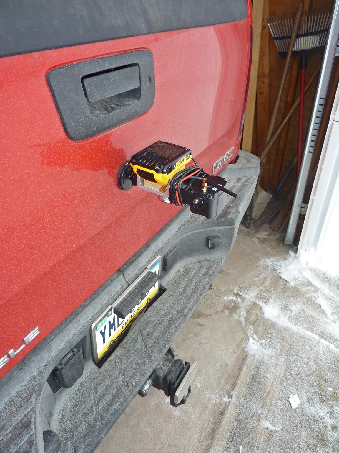

Also, I've found that backup cameras mounted at license plate level are not so great for hooking up trailers. I mounted mine at the top of the pickup tailgate which gives a much better perspective of how close to the trailer tongue.

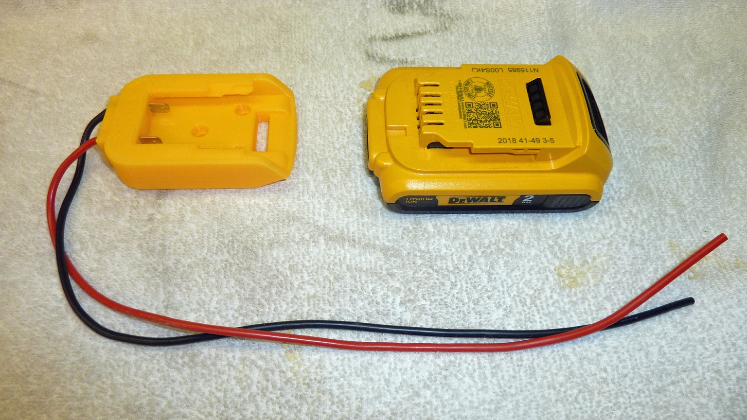

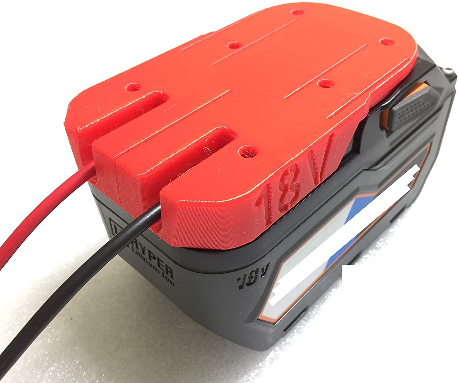

I'm curious - where did you get the "receptacle" for the battery? Is there a DeWalt part number for that? Most of my battery powered tools are Ridgid. I wonder if they have something like that?
/ Portable Tractor Camera System
#27
What a great solution!!
These adapters are usually not available from the battery makers. Most are made by small businesses with 3D printers.
Here is one for the Rigid 18V battery
https://www.amazon.com/battery-adap...+tool+battery+adapter&qid=1614084546&sr=8-2 81GsOLtNm3L._AC_SL1500_.jpg

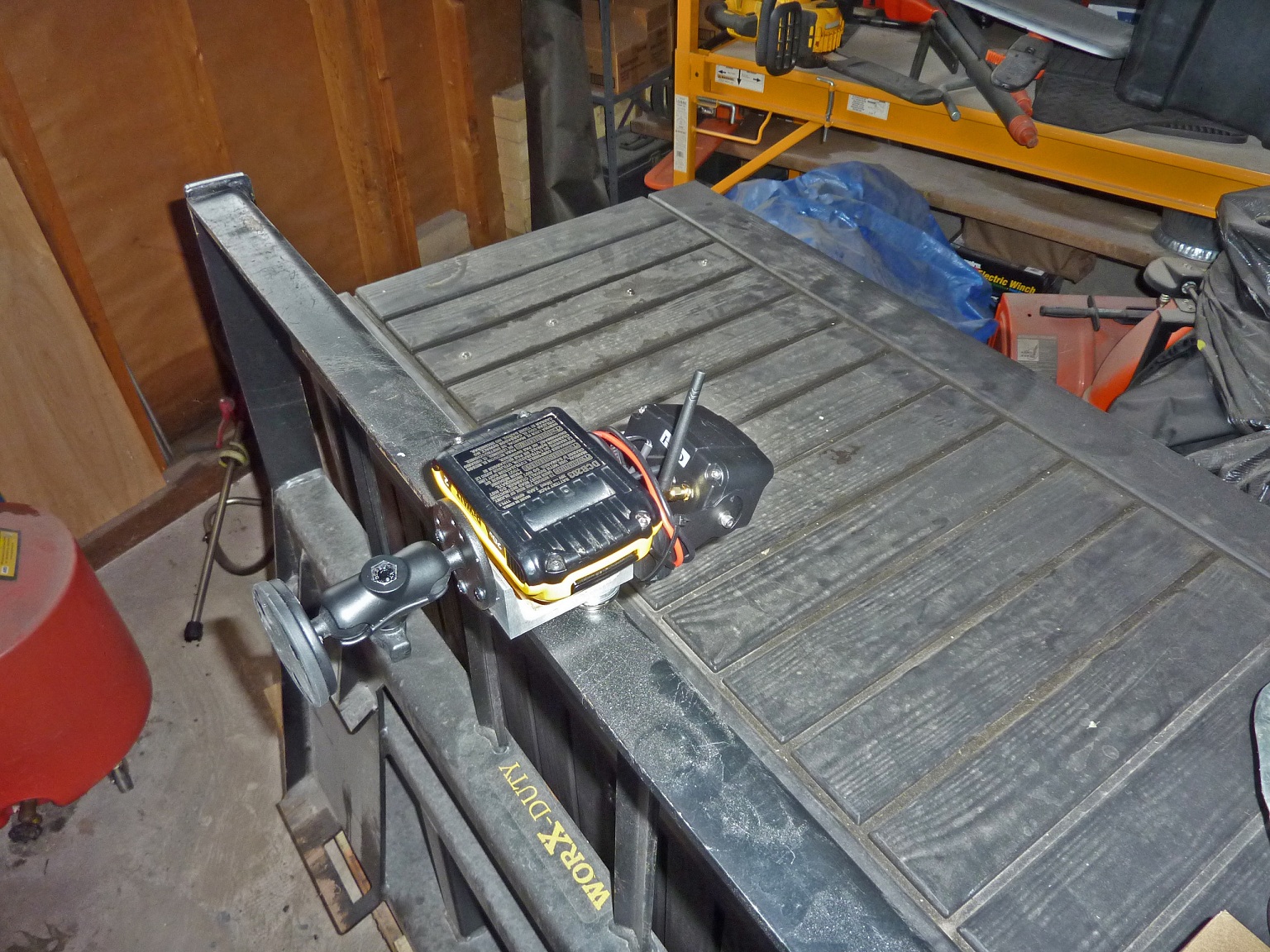

I sometimes use two cameras when working with pallets. I put one on the forks and the other on the ground near the pallet or attach it to the metal support rack holding the pallets. The possibilities are endless unless you "end" the camera by running over it.:thumbdown:

What a great solution!!I'm curious - where did you get the "receptacle" for the battery? Is there a DeWalt part number for that? Most of my battery powered tools are Ridgid. I wonder if they have something like that?
I recently discovered that adapters are also available for using one brand battery on another brand tool.
My old cordless tool set is Craftsman 19.2v. I have recently invested in some DeWalt 20v tools and batteries. I bought an adapter that I can use my DeWalt batteries on my Craftsman tools. It's been very handy to have infinite battery power on hand.
Red Adapter for Ridgid 18V Hyper li-ion Battery Dock Power Connector Rigid - - Amazon.com View attachment 687510
THANK YOU for the link!! I do appreciate it.

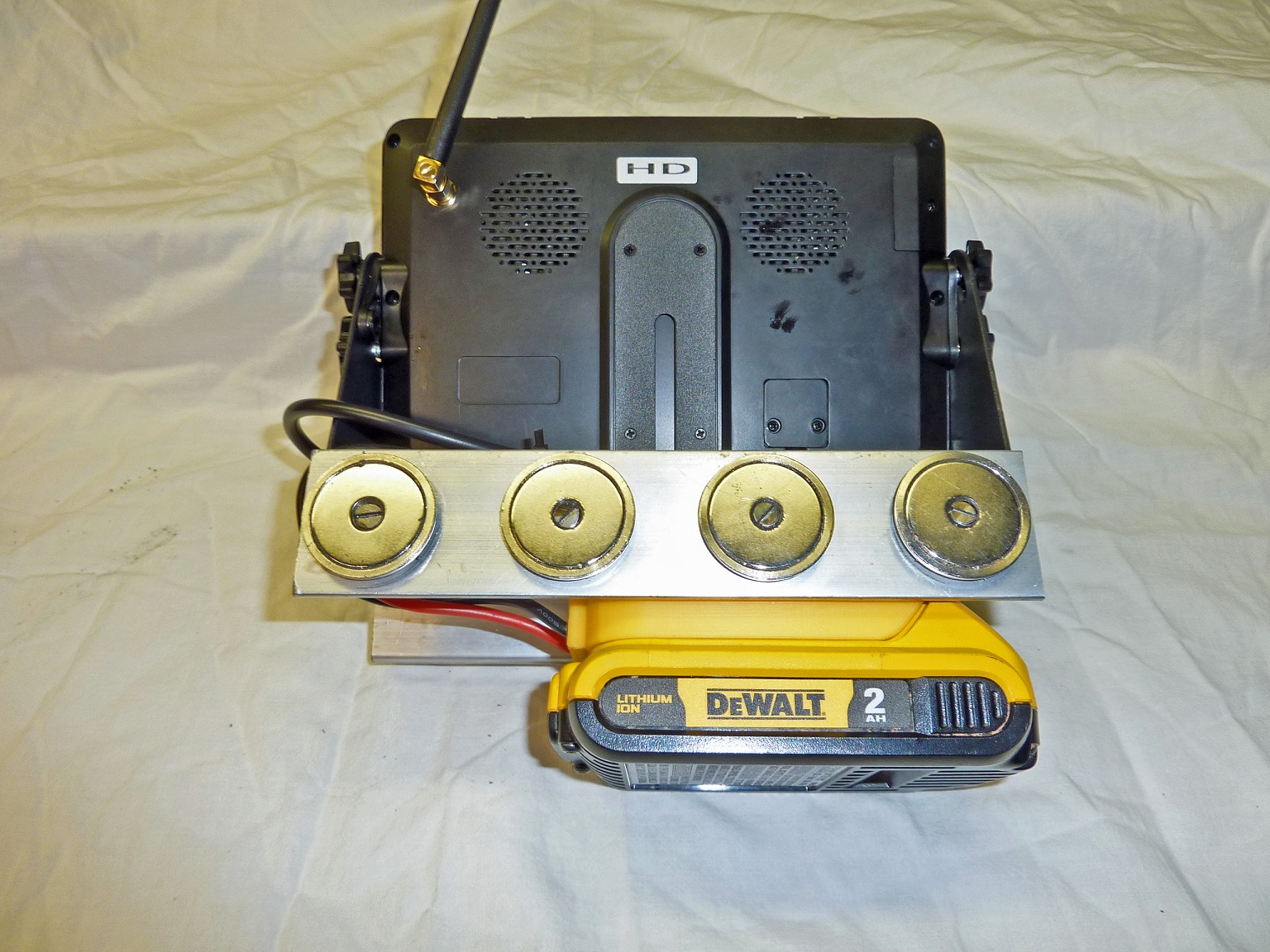

Do you need something to step down the voltage from 18-20 volts from the battery to the 12 volts that the camera is designed for? Or can you just wire it straight to the camera?
/ Portable Tractor Camera System #33
You would have to look at the camera specs and see if it has a voltage range. Most electronic devices do and most have a very wide range.
The Yakry camera system I have will operate on 12 to 24V. Many other systems do as well but it would be a good idea to check before buying one for portable use.

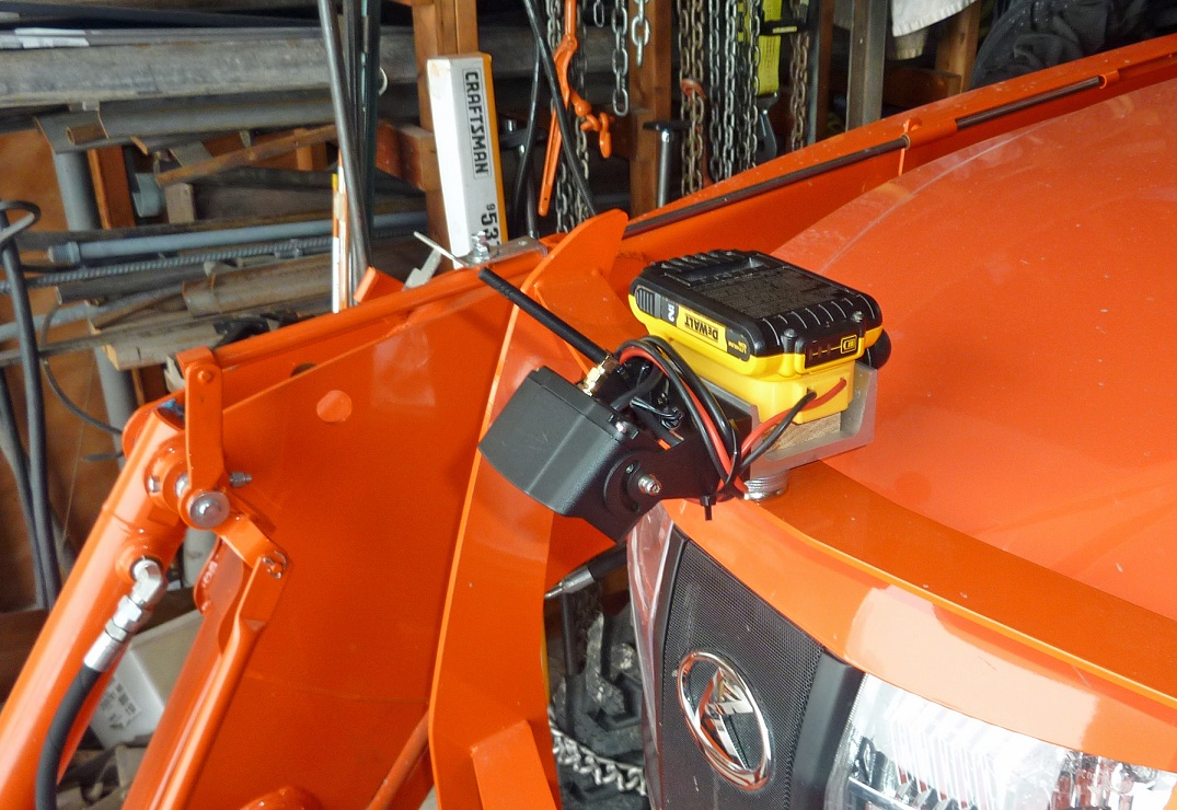

This is a great thread. I am getting ready to purchase my camera and noticed that halo view has a built in wireless camera with a built in rechargeable battery and magnet all in one.
HandyCamera | Battery Powered Backup Camera
It’s a bit pricey...but I just wanted to pass this along in case someone else found it helpful.

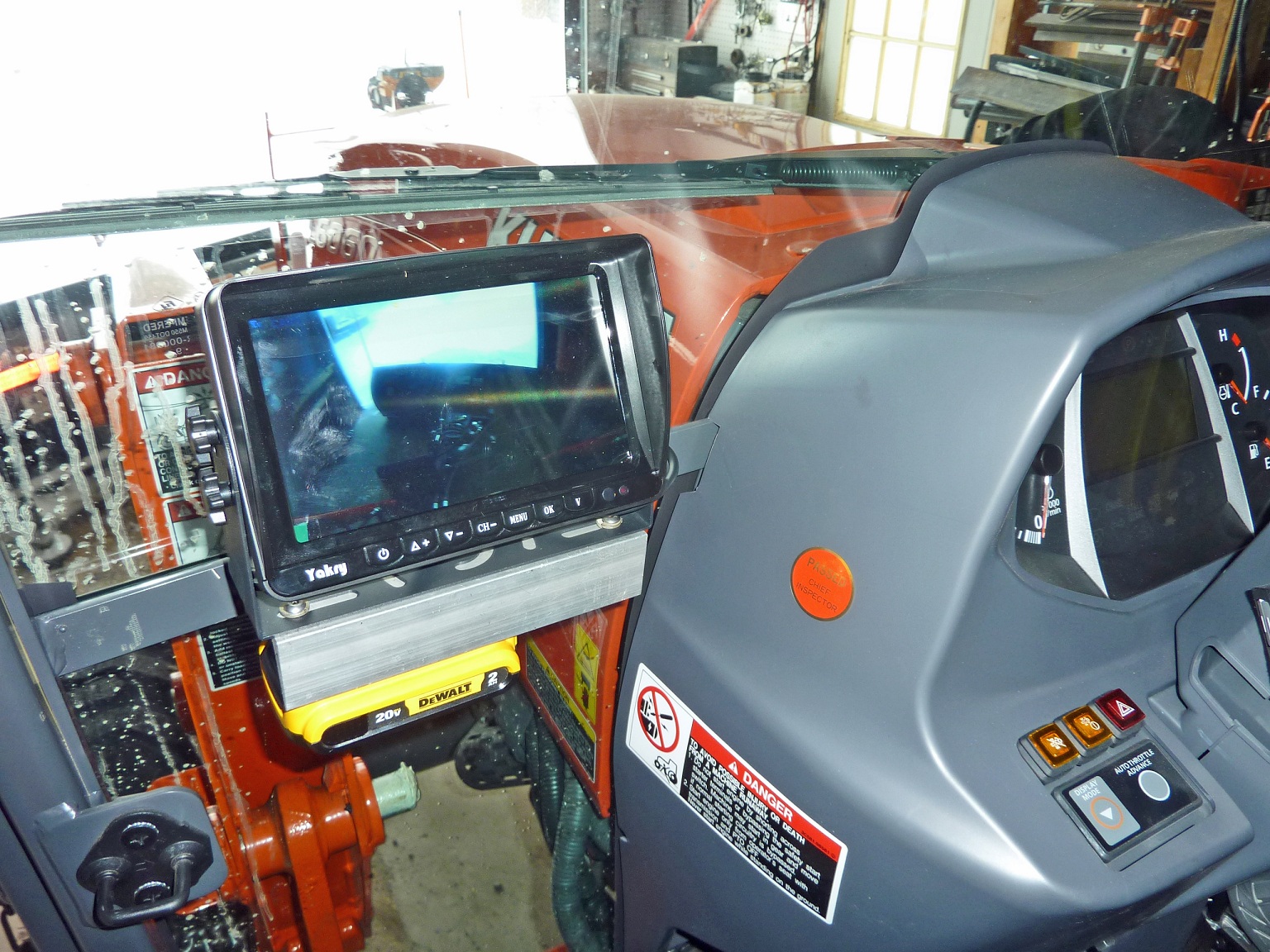

The site mentions compatible monitors/screens, however I've not been able to find any. I wonder are they proprietary?

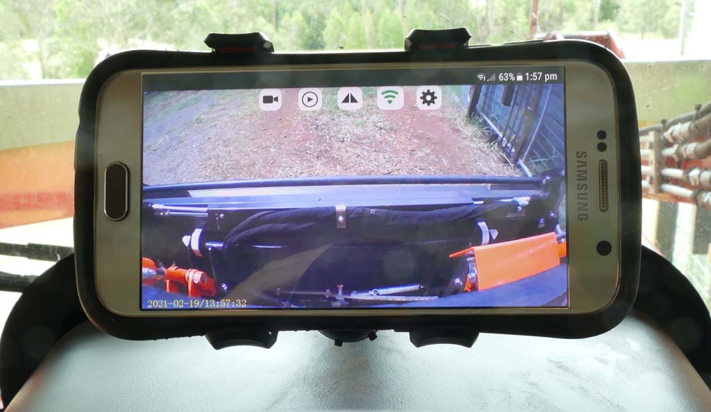

As I posted earlier, my camera acts as a wifi hotspot, with the data hoovered up by an Android app, but of the six Android devices I tried, only one (Samsung S6 phone) functioned as it should - the other five had unacceptable latency at first, followed by a total app freeze within 30 seconds.

I have a Haloview and I really like it. They didn't have that camera when I bought mine. My camera and battery pack are separate but work great. I find more use with the battery cameras than the regular ones so I will likely be buying a couple of those. Another good thing is the batteries last a really long time and I can recharge them right there in my cab.

Be careful on the battery receptacles, I came across one that had a circuit board that covered the whole base so drilling holes for mounting would be a challenge. I chose to stay with ones that have mounting holes already in them.

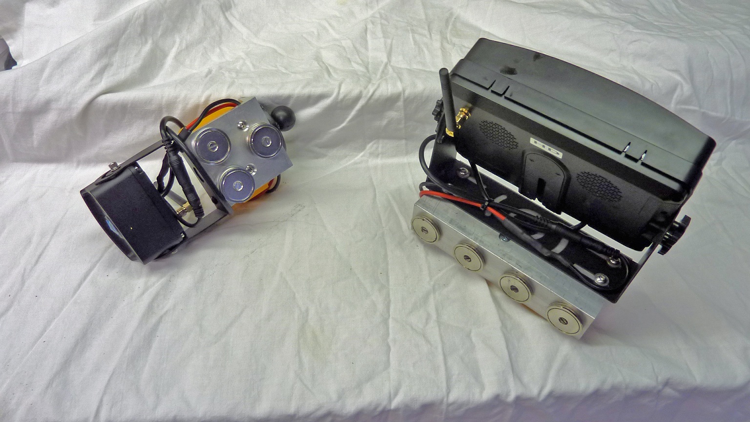

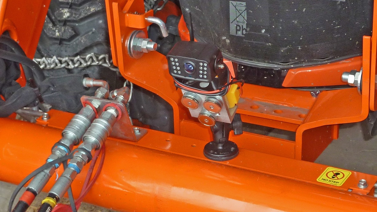

I use neodymium magnets on my wired camera system and move the camera as needed. For $75 is has been a great system. I use IBC totes for firewood and it makes it a snap to get the forks into position, and for moving my 50 gal fuel caddy on and off the pickup. Even handy for attaching SSQA stuff.
I like the wireless battery operated option and may go that route.
