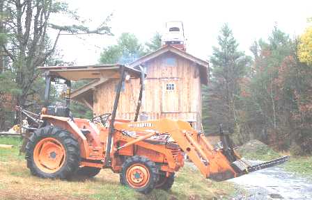

I used the "Big Foot"form on my barn 3 years ago and was happy with them
