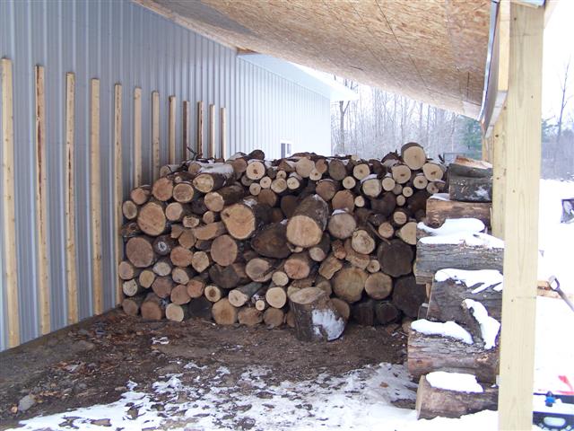

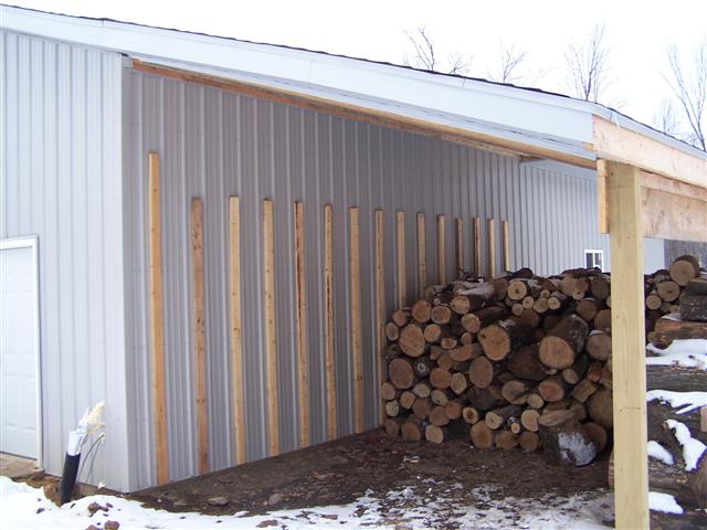

stupid pitures
I give up
/ Polebarn lean-to posts #22
Thanks for the pix, Rex. Thats very close to what I want, except my connection to the barn is to an end wall.

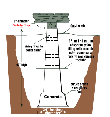

FOOTING TUBE FOOTING TUBE
Please go to foottube DOT cee oh em for a simple, effective post base that will not heave with frost. There is a video that shows how it works. These are Canadian in origin where they KNOW frost, and their building standards are significantly higher when it comes to efficiency. Those who live in soft, relatively stone free soil locations cannot appreciate the problems stoney, boulder strewn soil conditions create. Backhoes and excavators are a necessity. PHDs don't amount to a hill of beans. I have no vested interest in footing tube, they are simply the best solution I have seen in 35 years of building plus I am tiring of reading about concrete embedment and why backhoes don't work. Pressure treated material will rot in some conditions, not always, but not infrequently either. (Cut off a 6x6 and see how far the preservative has penetrated.) Reinforcing steel in the footing tube connected to a steel post anchor and the code built roof will withstand any wind load up to the engineered design limit. Check with an engineer if you have concerns or extremely wind conditions. In my little microclimate we see gusts up to 70, more in the occasional thunderstorm microburst and I am planning on using this system to carry a small barn that I put on wooden piers 25 years ago that has succumbed to soft springtime soil conditions and a persistant south wind. I would never have had this problem had footing tubes existed way back when...
FOOTING TUBE FOOTINGTUBE
/ Polebarn lean-to posts #30
I'm with Sugarmaple on this one. The footing tube will allow the use of the backhoe with minimum compaction. Just dampen the soil it will pack.
The base and vert taper will do the work.
Being in the sign industry we find many post rotted off in concrete. Eddie one posted that he adds a crown to the top of the crete to shed the water away from the post. That work well, but on a building I would not want this. I like the clean look. Short term wood direct buried (no crete )we found last the longest.
Phil
