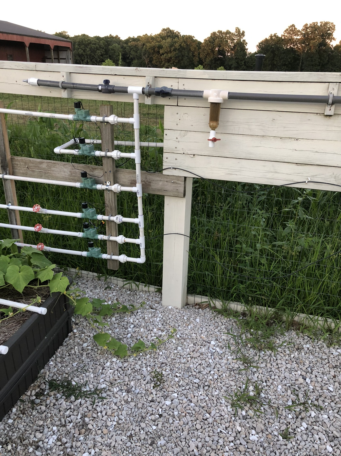

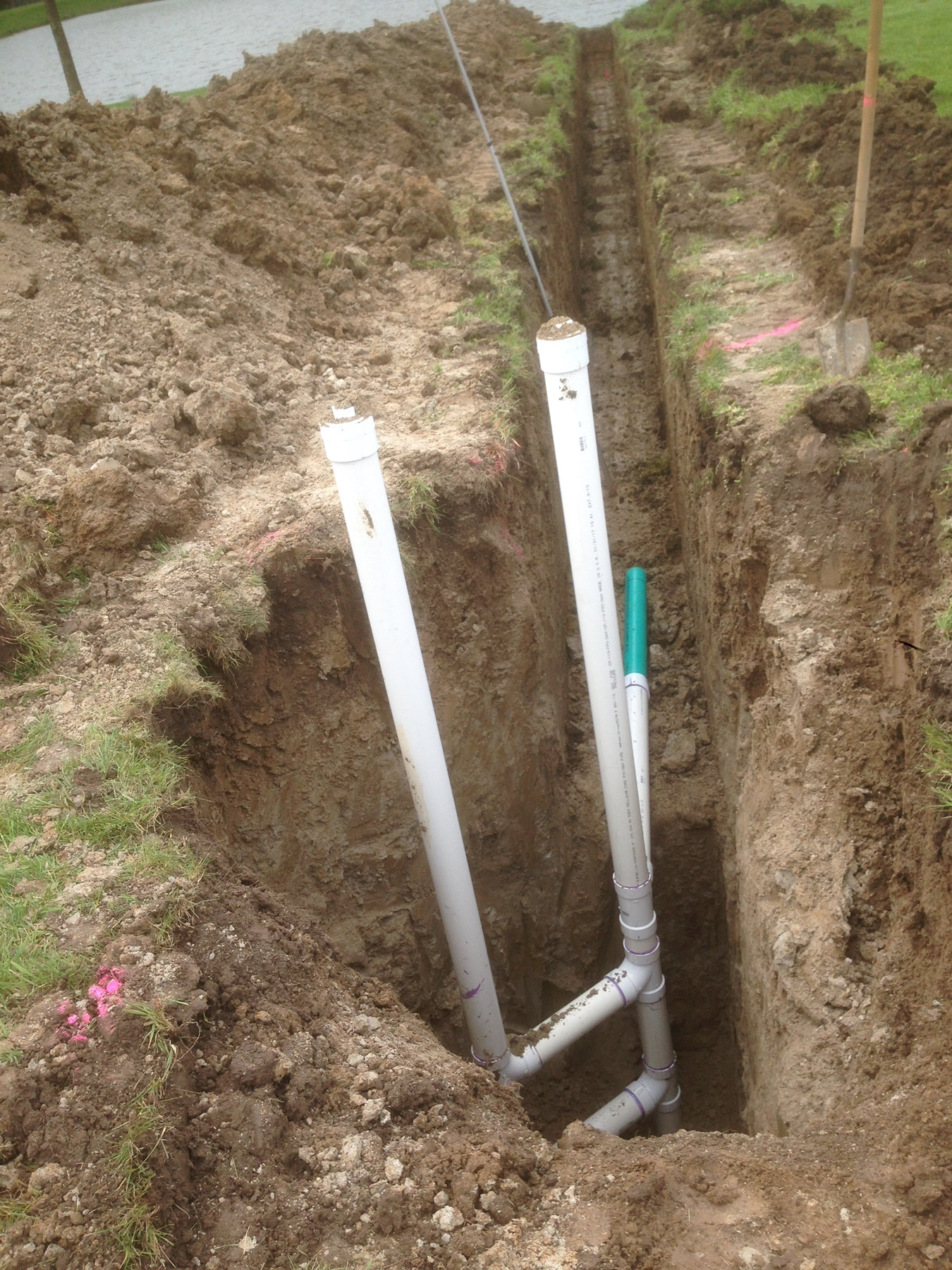

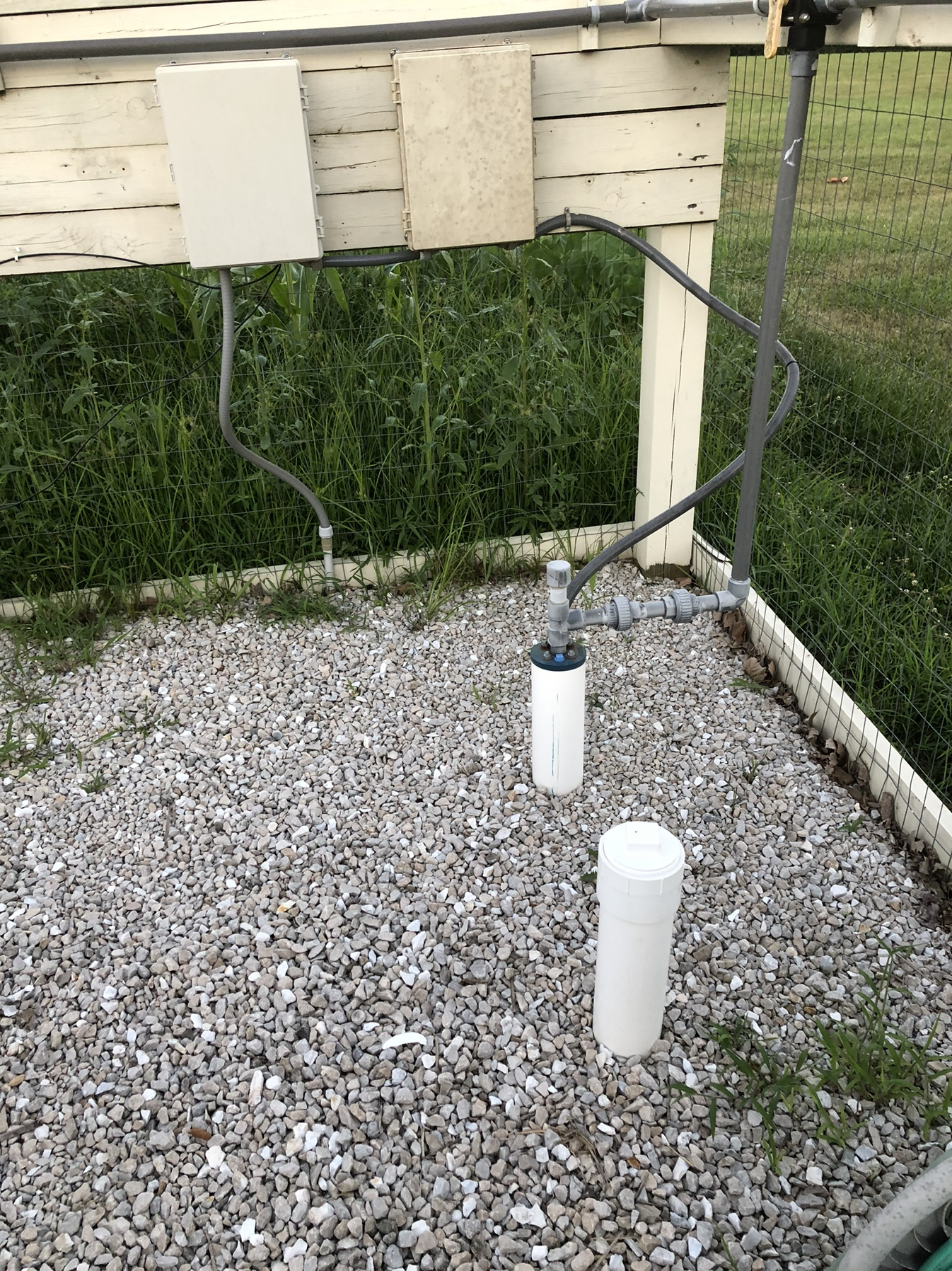

I had a similar situation although I did not have the 30’ elevation change between the pond and garden. I used a 3” 1/3hp 120v submersible pump that I put in a 4” pvc casing that was placed in a 10’ deep hole that was dug next to the garden.
   / Small reliable (low maintenance) irrigation system from pond? #22

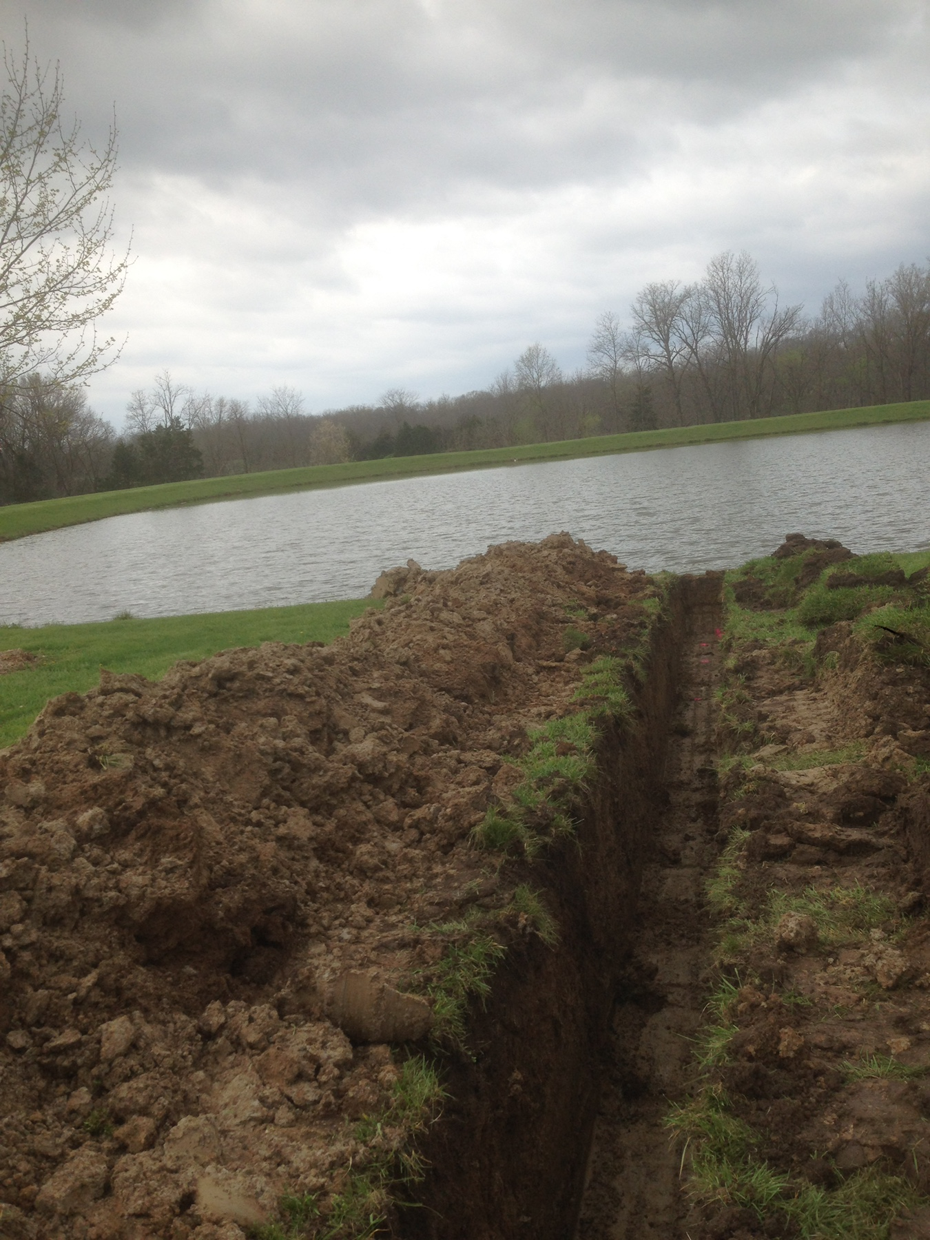

A 4”pvc line connects the vertical pvc well casing to the pond 24” below the normal level of the pond. The 3” centrifugal pump hangs about 8’ deep in the 10’ casing.
It’s been service for 3 years now with no maintenance or freezing issues. An in-line strainer takes care of any debris from the pond.
   / Small reliable (low maintenance) irrigation system from pond? #23
The pump is controlled by an Orbit sprinkler controller using a pump start relay.
Then I have it feeding 6 separate watering circuits.
