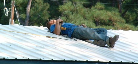

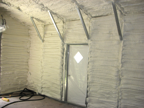

Have you ever considered a steel framed building and save a few grand? That's what I did, so that I could use that savings to put a bathroom in mine. My building is steel framed but it has 20 year warranty's on rust and a 60 lb psf snow load. the Mexicans who put it up were running on that roof while building it. I took photos. I had an insulation supplier locally arrange the foam spray job. I used barns dot com for mine.

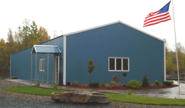

We made a little office building type of situation out of ours. 26 x 50 . We love it.

Gno,
I notice that the supplier did a horizontal spray instead of vertical. Is there a benefit for this, or is this just their technique? I have only seen it sprayed vertically is why I am asking.
Thanks.
   / POLE BUILDING #25
That's a good question, I'm not too sure why he'd done it like that. I think he felt it would work best with our framing arrangement.
Correction, the image I posted with the insulation was from another building we purchased. That building was much smaller, and the sheet metal ran horizontally. They did spray the foam in our office building vertically. My mistake, my images aren't in any order and nowadays the office building has dry wall in it with a drop ceiling, so I thought they matched.

I just heard on another forum, one familiar building builder won't warrenty a roof if it is sprayed on foam directly to the underside of the tin, says the foam will rust the roof through. First time I heard of that, but a few others agreed. Anyone here know anything?
