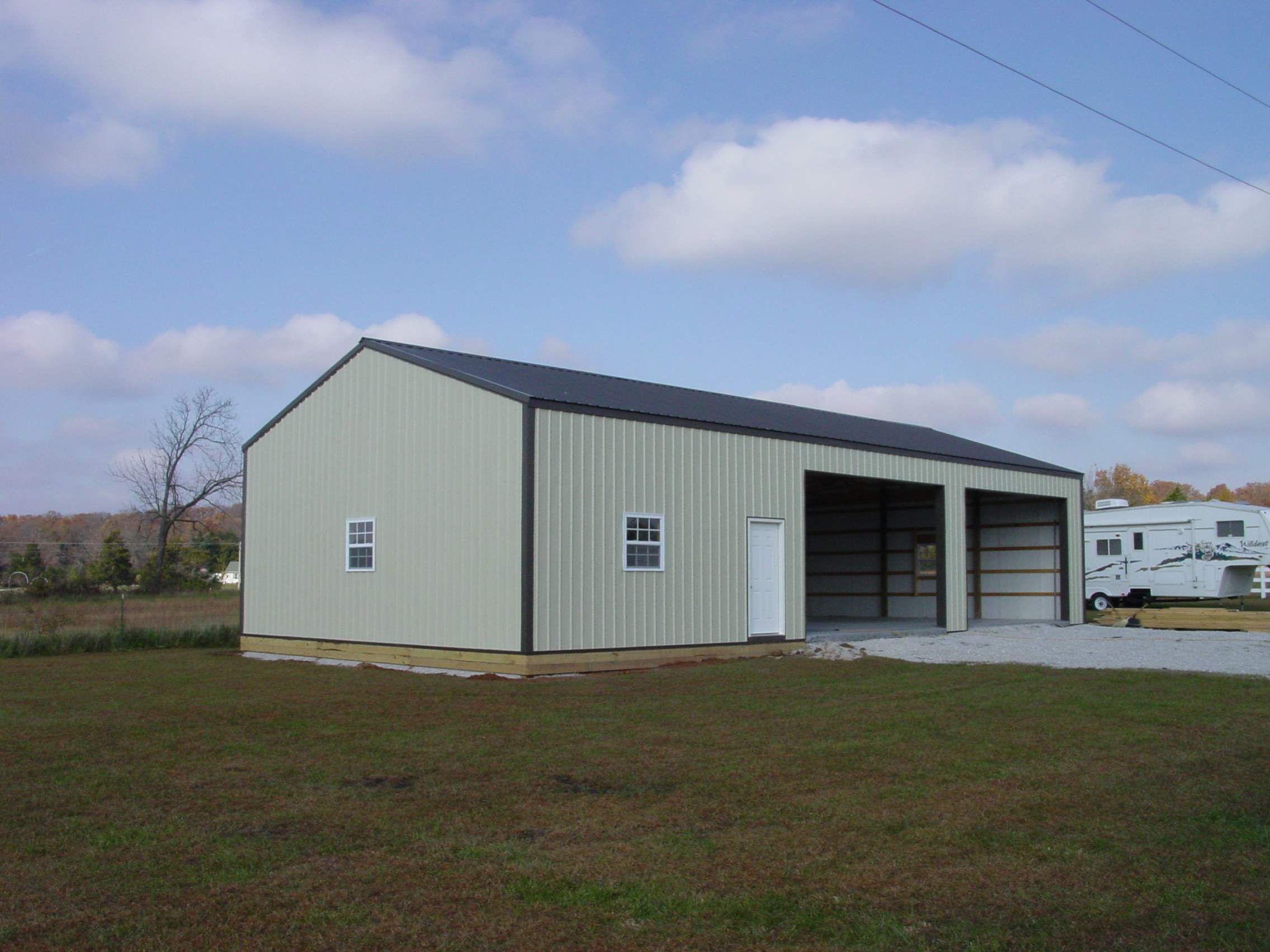

I built my own from a kit at Menards. it is 36x48 with a 10' overhang for the trailer. 12' walls 2 - 12' doors and 3 - 4' doors. One man door and 2 windows for 13,500. So If you are not putting any doors on it and only doing 3 sides you could get away with 8k or less pretty easy.

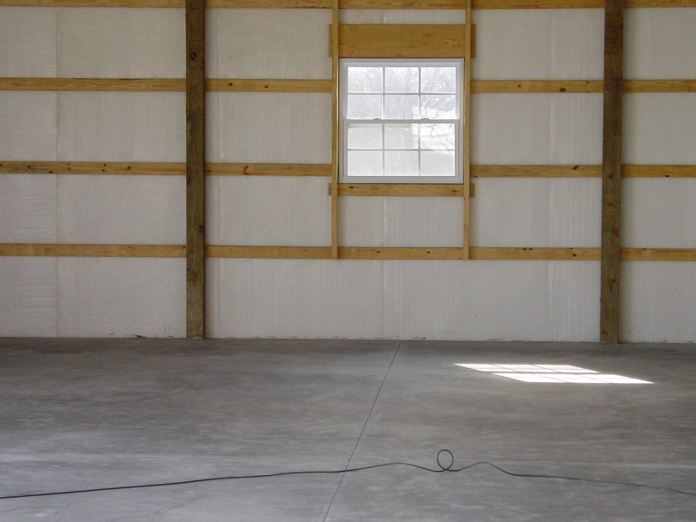

I built a 30X60 pole barn as a workshop, garage, and storage in Oct. 08. What I learned about this process:
1. You can never have too much space.
2. Build the biggest you can afford.
3. Absolutely-- install a concrete floor.
4. Insulate during the build, not later. So much easier and cheaper.
5. Let your builder install as much as possible (think quantity buying).
I know you can save a lot of bucks if you build it yourself. I would have loved to build my shop myself, but realistically & time wise that was not possible. So. I chose to save in other ways such as doing the electrical myself and installing other items as needed (door openers etc.).
One benefit--enough wood left over to build storage shelving across the entire back wall and a 36' corner workbench.
My shop is still evolving, but I like how its worked out so far. Temperatures were about 20 degrees warmer inside during the winter. It should do OK during warmer weather too.
Initial cost came in at approximately $22,000. That's a lot of initial outlay, but worth it for our situation. My wife and I just rearranged our finances to make the project fit our needs. Some other projects will just have to wait longer. Good luck! Mike.

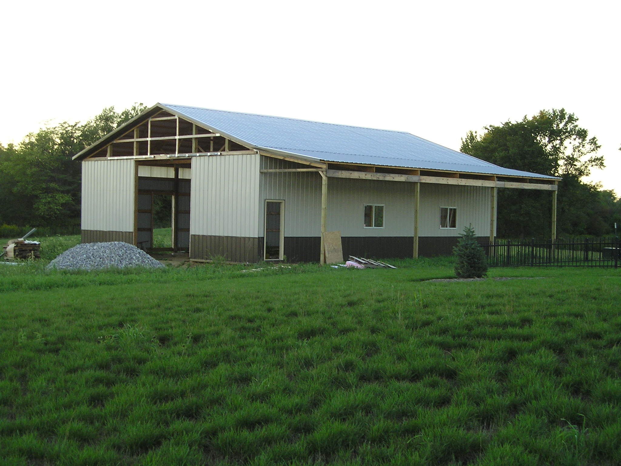

Here's my equipment shed--20x28 ft floor plan, 10'H dropping to 9'H on the closed side.
28 ga metal siding and roofing.
Materials: ~$3500. Labor: about 2 months of my labor.
