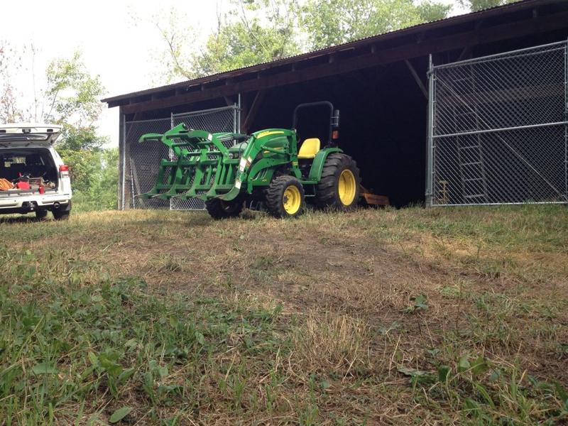

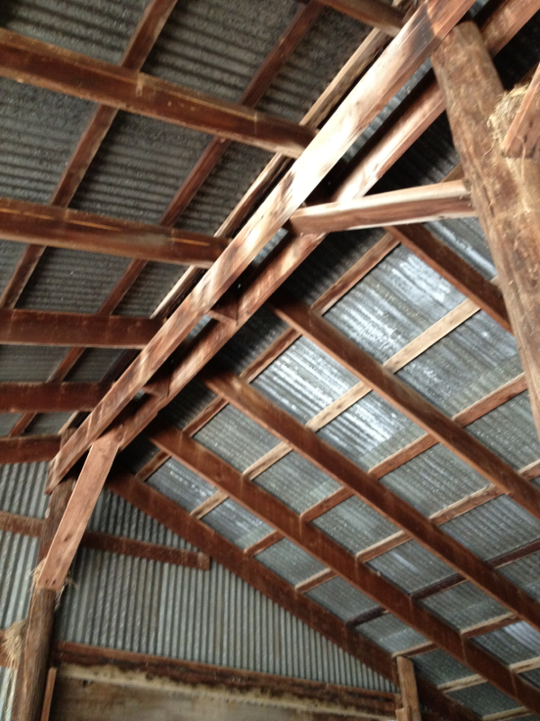

As I acquire more toys, I am quickly running out of storage space in my old pole barn. I am wondering if there is an easy way to lift- up (via winch) some of the lighter items. I keep two John boats in there that are used infrequently. If some attachments need to go outside, which ones are best at withstanding the elements?

I built a lumber rack once by carriage bolting 2X4's from the overhead beam down about 3 or 4 feet, bolting a cross beam and adding planks or plywood across to make a suspended floor..... keep the weight reasonable and it works great.
/ Pole Barn Storage #3
As Boeing says suspend some 2x4s and make a basic frame - good for light stuff like the jon boat aluminum I presume, - you dont need a floor for that.

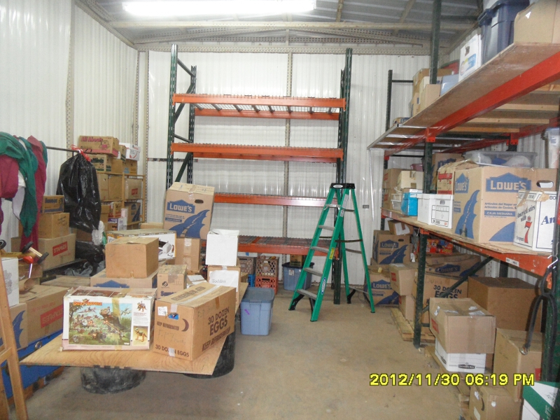

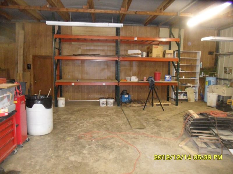

Pallet racking,
Used Pallet Racking.
Sometimes you can get it from the local scrap yard for scrap prices. I've been buying it off Craigs list.
This 3 upright, 12 Beam, 12 wire mesh shelf unit cost me $20 TOTAL. The guy had to get it out of the warehouse quick. I've put a sheet of 3/4 PT plywood topped by a sheet of 3/4 MDF on the bottom shelves for workbenches.
This setup on the right cost me more like the going rate of $40 to $60 per upright and $10/beam.
You could store an engine or two on each shelf, they've got a 3 ton capacity. You can get uprights readily up to 16' and beams up to 12'. Present plans are to line the walls of the shop in the first photo with 12' tall units with shelves at 8' and 10' for lot's of overhead storage. I can then park vehicles underneath.
It's quick and easy to assemble. I put it almost all together by myself. Only tool needed was a rubber mallet to persuade some fitting problems. It's also easy to disassemble and move.

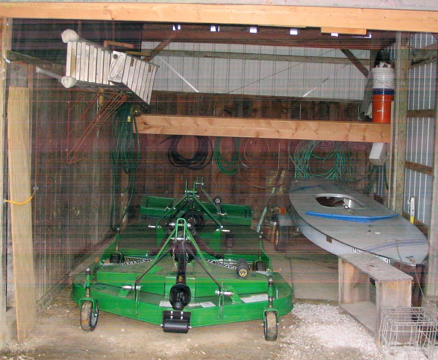

I hoisted a boat out of the way today. Probably spent more on the hoist ($115) than the boat is worth, but I need the space. I am now contemplating lifting the Landscape Rake (400 lbs) or one of the other lighter

I have taken 3/4" plywood and screwed 2x6's around it then put I eye bolts in each corner. Now attach to a boat winch mounted on a beam and run the rope through a pulley and you have a 4x8' area to put light stuff on and can get up and out of the way.

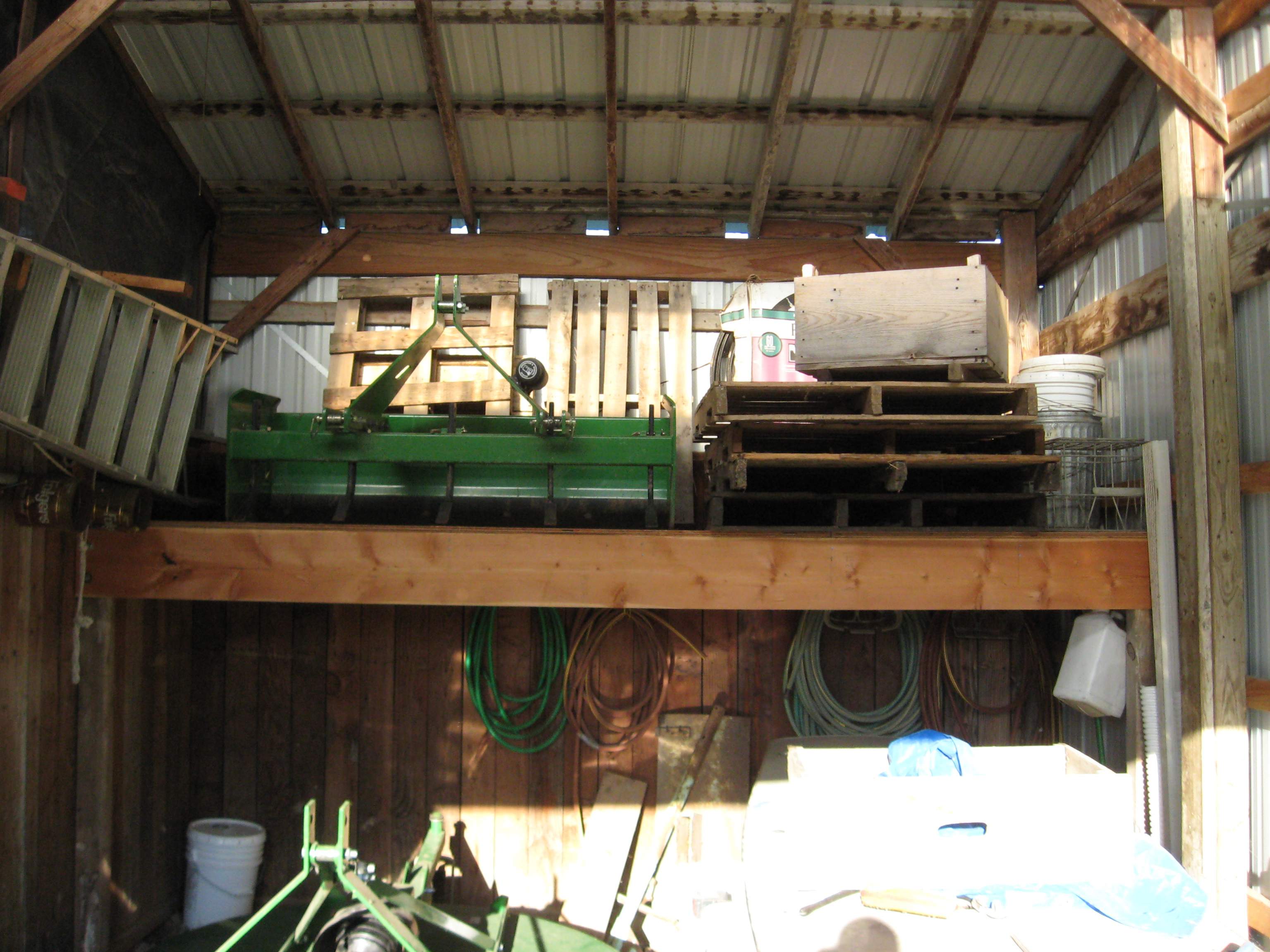

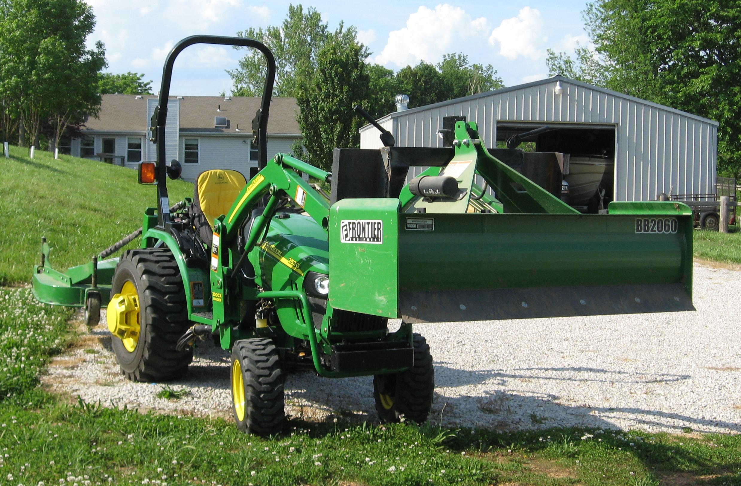

You might think about building a "mezzanine" in the barn. I have the same problem as you and elected to build this structure, a glorified shelf really, about 5 feet above the floor. It is perfect height for storing my box blade and other things. Of course, you have to be able to set them up there with a loader/pallet forks or whatever. In my case, I built a loader-mounted three-point adapter that allows me to pick up the box blade with the loader.100_0910.jpg100_0876 B.JPG123_2336 B.JPG

Looks great. That is the correct way to store an aluminum boat or canoe. Upside down is discouraged by the factories since it can apparently cause a bend in the boat or canoe.
