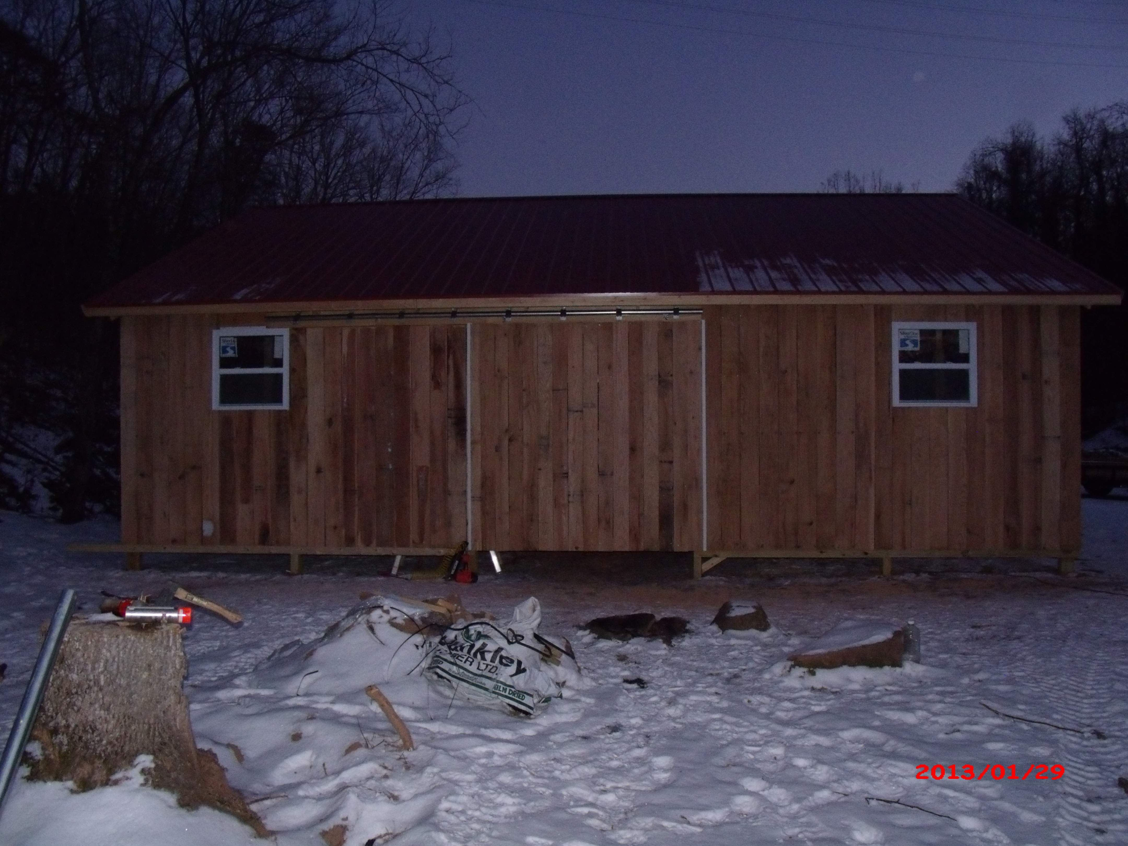

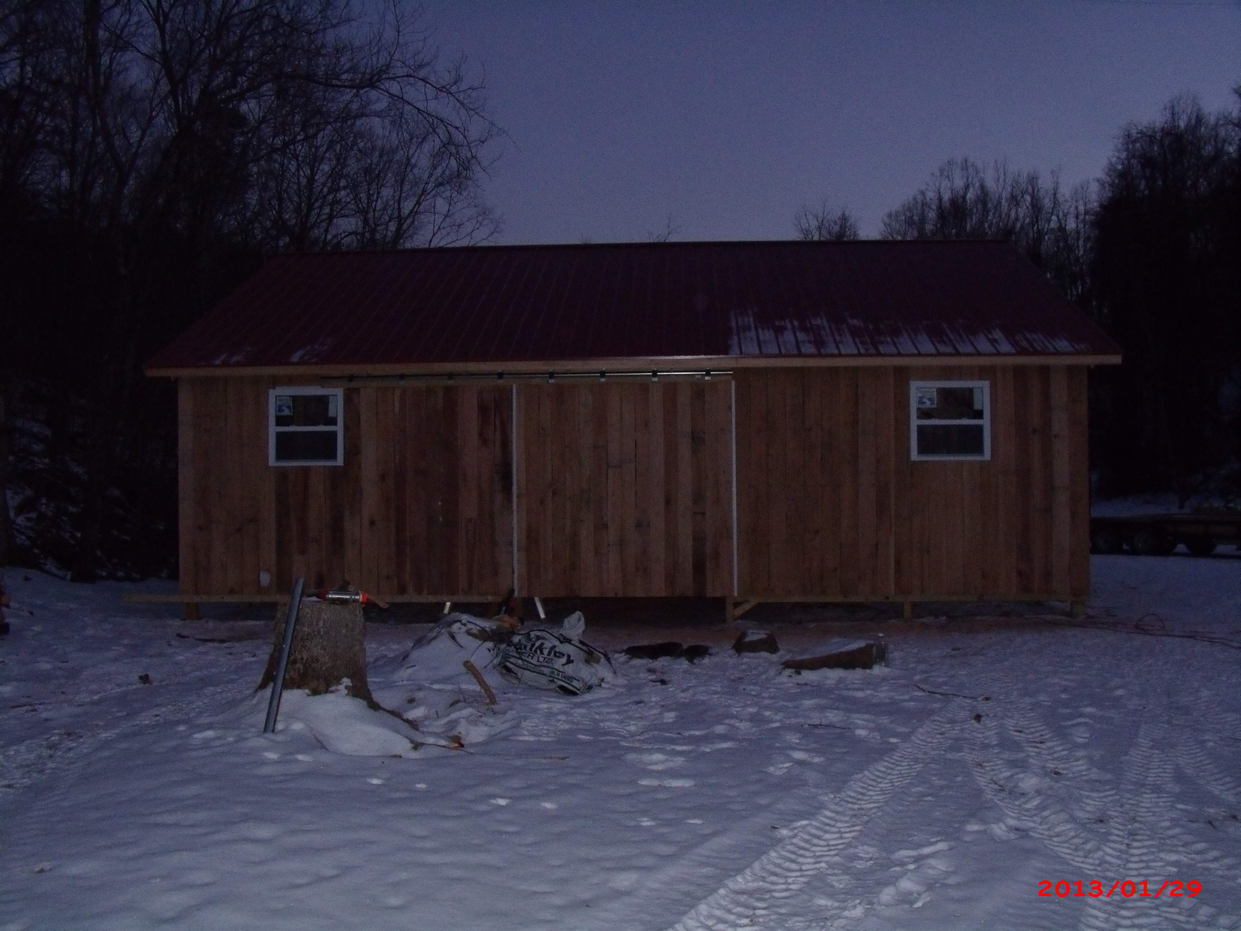

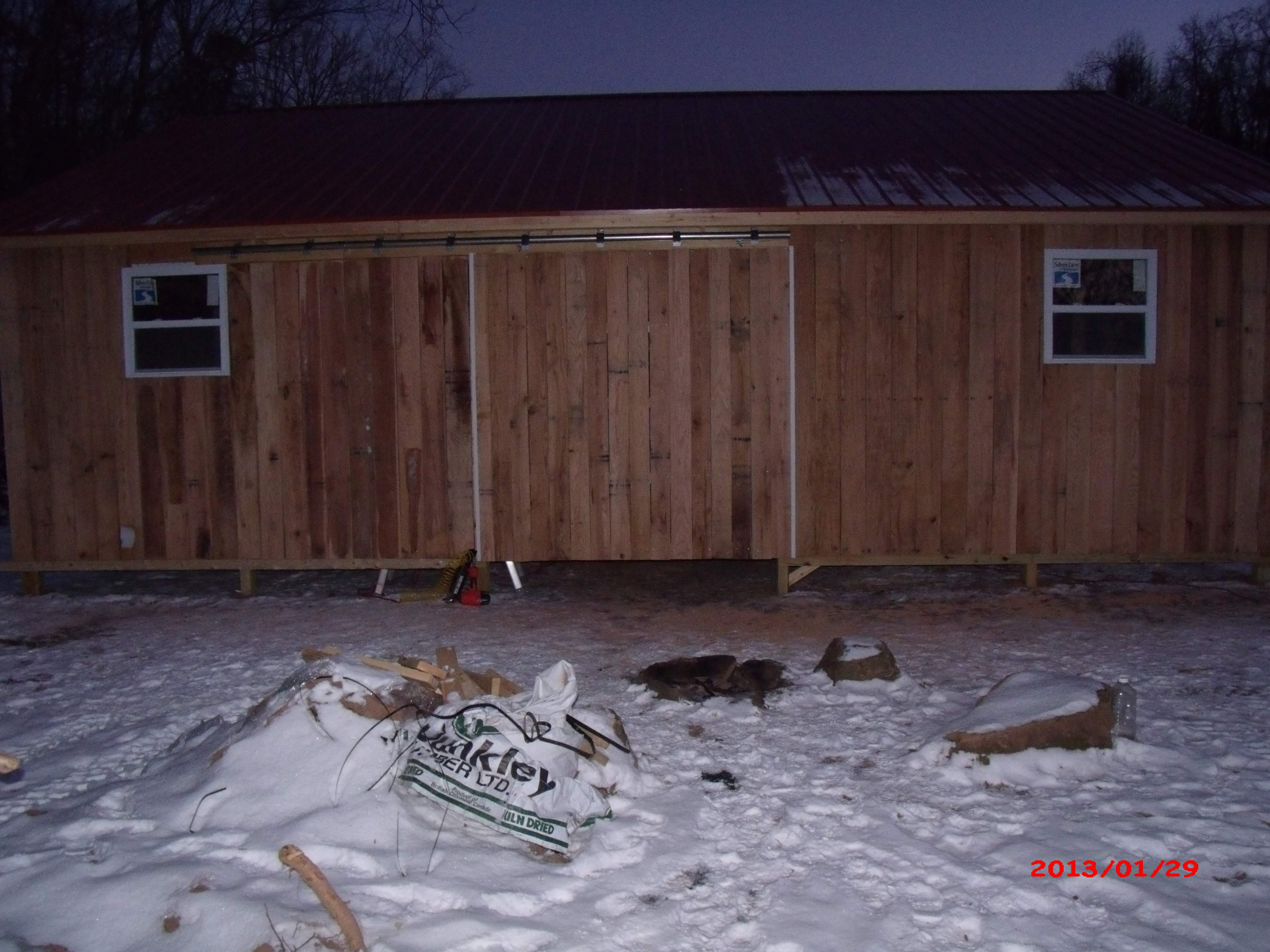

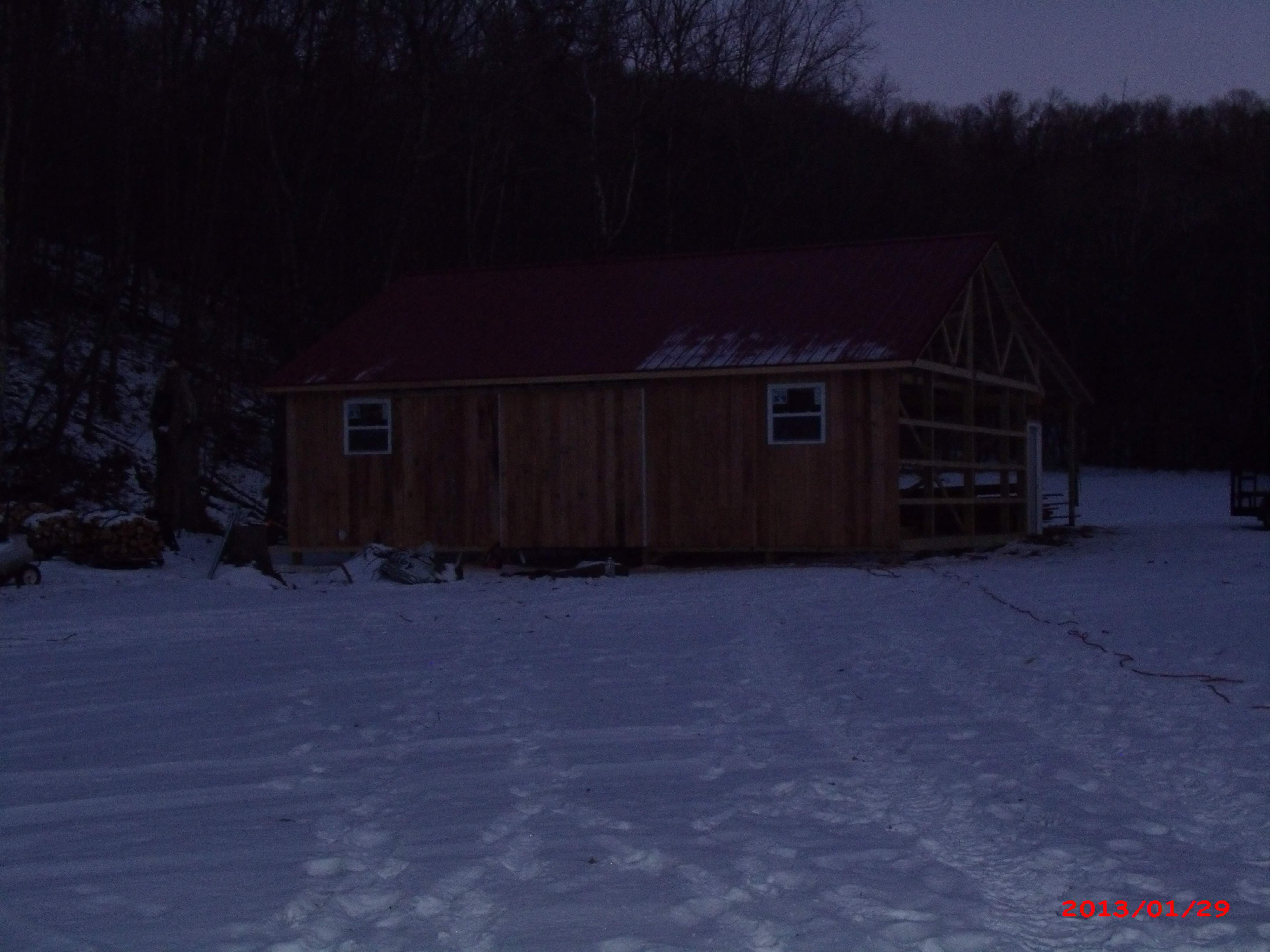

Got one side of the siding up. Took a lot longer than I expected: finding a good piece, cutting it, ripping it, then hanging it. It's worth the effort though. I think it will look good once I get the trim up and stain it.

/ Pole barn started #34
Looking good. You must be working hard if you're taking end of day photos after sunset!
/ Pole barn started #35
I'm curious. It looks like the uprights are sunk right into the soil. Not in or on footings, and I don't see any ant or termite barriers. Is it just me and the camera angle not showing them?

The poles are setting on a half bag concrete then the dirt was tapped around the poles, they were rock solid when they finished. The frost line here is only about 18" so they are well below the frost line. I think if the rest of the siding turnout they same way I will probably put a natural colored sealant on or maybe a red cedar.
/ Pole barn started #38
Looks great. I love the wood siding. Any plans to do anything for a floor at some point, or will you just leave it dirt?
/ Pole barn started
#39
I don't know what an ant or termite barrier is so I won't have those. The floor is going to be brought up to grade with gravel then I will put dirt on top of that. The barn floor is going to be above the surrounding grade so I don't think water will be an issue. If I find a few extra bucks in the budget I might concrete the working side of the barn.
