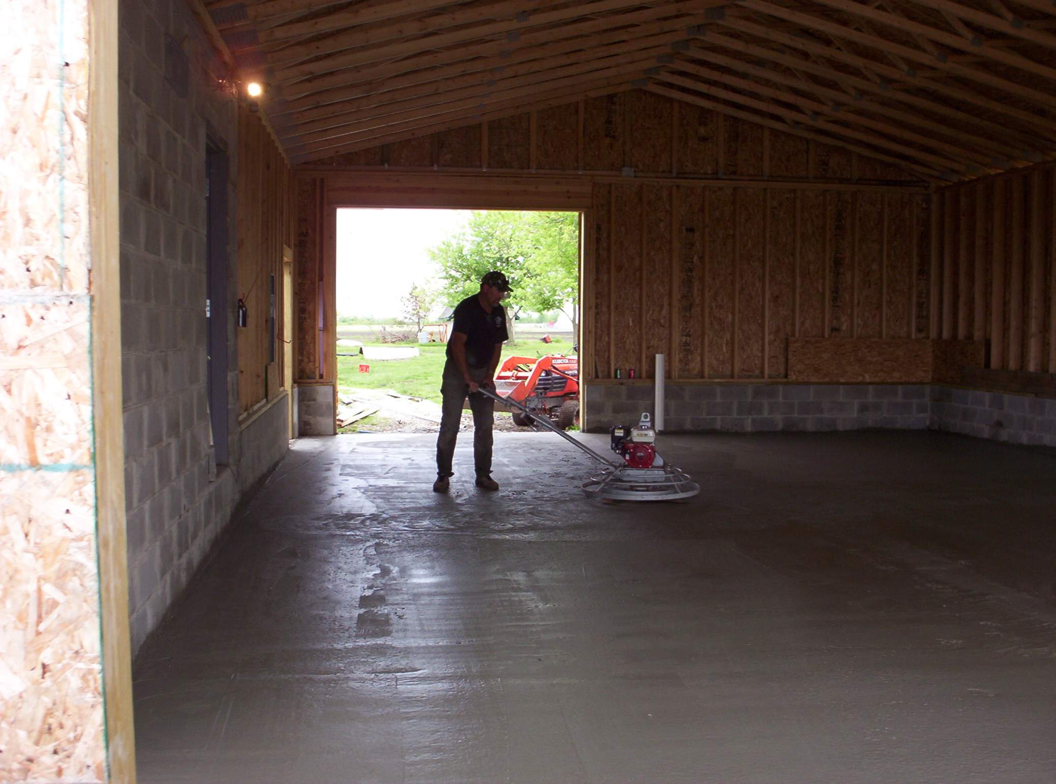

I would check again with Truss Mfg. I got 28' sissor with 5/12 outside and 3/12 inside.
Dave
