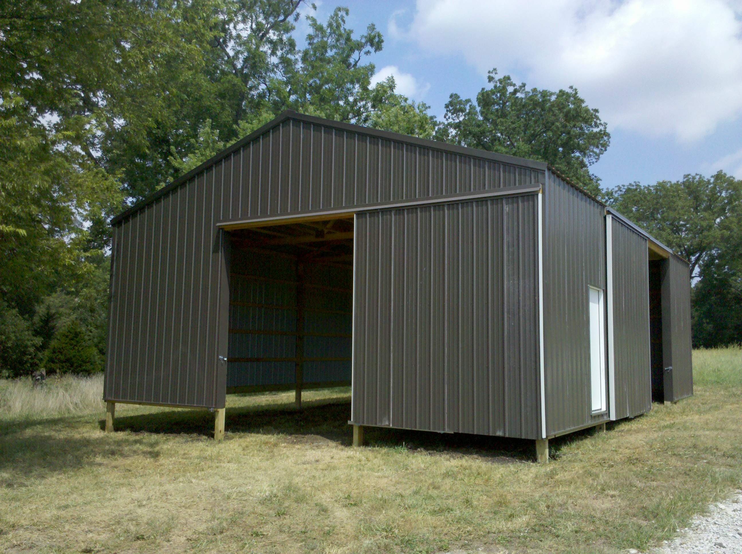

Well, as usual, I put the cart before the proverbial horse. I went out and purchased a 30x40x12' steel pole barn kit from Sutherland's, and arranged for them to erect the building (with a 3rd party contractor). Problem is, I neglected to first level the site.
The Sutherland's sales rep told me that the contractor would minimally level the site, and I incorrectly assumed that the site was just about level. I therefore thought it would be OK to install a gravel floor after the building was erected, and hopefully at a later date, when I recovered from the the expense of the building.
As it turns out, and as can be seen in the picture, the site falls off 22" from one side of the building to the other. From my calculations, I approximate that I will need about 100 cu. yds. of material to back fill the barn. I plan to put in a retaining wall on the low side, using some telephone poles, placed about 2' off the low side. Then I plan to backfill the barn floor with road rock (a mixture of small gravel and fines).
The material will cost me about $1,200 delivered. I am interested in hearing opinions on whether this is a good approach to solve my problem. I could use dirt on site - but I'm concerned that what I have does not have the consistency needed to form a firm floor. It will also take considerable time and effort to dig and move that much dirt. I welcome any input.

I'd use your own dirt (and some tractor seat time) and pack it well. It will be dry so shouldn't be bad for fill. Top it off with gravel after a winter of freeze/thaw and more settling.
But I would put a water run around the upper side so that drains all the roof and water run-off away and around your nice looking barn. That will also help keep your fill dirt dry. No need to fill it all with expensive gravel as it just sets on the dirt that is already there. :)

Fine opportunity for tractor time. You will be able to level your floor with the existing dirt and and boxblade. You can always go back and top your final grade with some gravel. Do not support using gravel to level your floor. Expensive. Nice shed.

What ever you put there it has to have the ability to pack firmly and you no longer have Mother Nature and her rain to aid you. You don't say but do you plan on pouring a concrete floor eventually? It makes a difference because sand would pack well and if it is readily available in your area would work well for a concrete grade base.
If it were mine, I think I would have to forget about the retaining wall and get some more fill to dump outside tapering away from the building. Of course if you expect to drive on this fill you are going to need something with a granular base containing sized or crushed gravel. Don't just dump in 22 " of fill & running off. Pack the base in layers if you plan on future concrete.

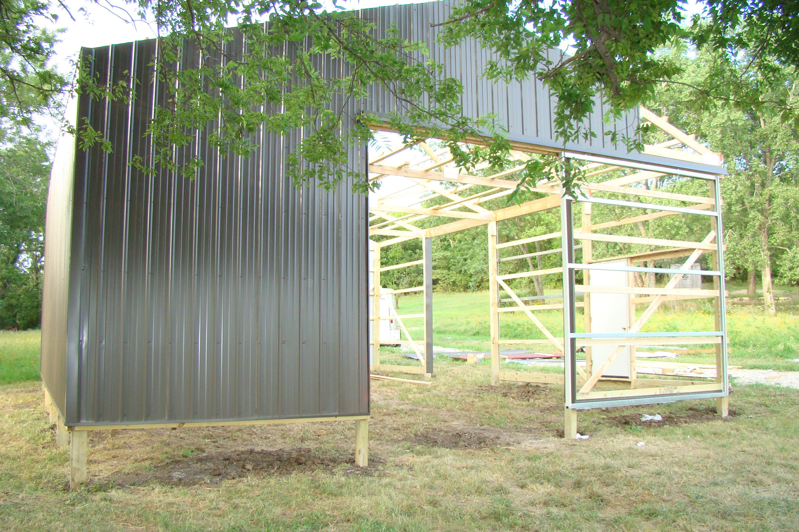

I appreciate all of the responses. I will be using the barn exclusively to store my tractor, implements and Ranger. I don't plan to ever pour a concrete floor. By the way, in answer to previous posts, I do not own a tiller (it's on my list), and yes, there are hills here in SE KS. That was the flattest piece of ground I could find for the barn. As I mentioned in my OP, I under-estimated the slope (a natural tendency, I believe).
I thought over all of the advice. I agree that my tractor is a little large for this work. But, I decided to give it a go. Yesterday I started moving some dirt, albeit very carefully. I will work in short increments, so as not to get fatigued and make a mistake I'll regret. I'm in no real hurry, as long as I finish ahead of the fall rains.
I plan to fill about halfway with dirt from on site. The soil is very dry, and the content here seems to be very high in clay. Once that step is complete, I'll plate compact, and then finish with AB3. I think I will be able to level the entire space.
As a side note, the builder offered to level it for me with a skid steer, but wanted $3500, and that was to use dirt on site. That was just too steep.

I think you will find it to be a mess without compaction. It was suggested to put the dirt in in 2" layers, compacting between each layer. I think that is your best bet. Finish off with a six inch layer of engineered fill and thin layer of gravel on top. I should add you will need to sprinkle water on to help it pack tight between the layers.
The problem with not compacting the soil is it will settle unevenly, You will have ruts where the tractor is and soft spots in the corners and edges.
I suggest you look into buying a good used compactor for about $750 that you could resell after this is over. I bought a used Bomag plate compactor about two years ago for $700 and kept it since I can use it about 10 days a year. That is cheaper than renting or buying a new one. Most rental stores will have all types of decent used equipment for sale at all times.
