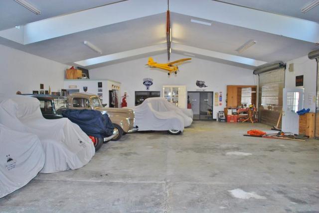

/ pole barn designing 40x64ish #39
2 years ago, we had a 42' X 60' X 14' tall Lester pole barn built by a local builder.
The posts & trusses are spaced 10' on center, It has 2 - 10' X 10' & 2 - 9' X 9' overhead doors.
The posts are full length laminated 2 x 6s.
I built a 19' X 42' loft on one end. The lower ceiling height is 7', the upper ceiling height is 6' 2".
I also added a floor in the truss spaces above the loft floor for storage of light weight objects.
I have not had time to do any interior wiring yet, other then installing the main panels.
The only lights I have at this time are on 2 garage door openers.
/ pole barn designing 40x64ish #40
Nice building and very practical with the loft...
