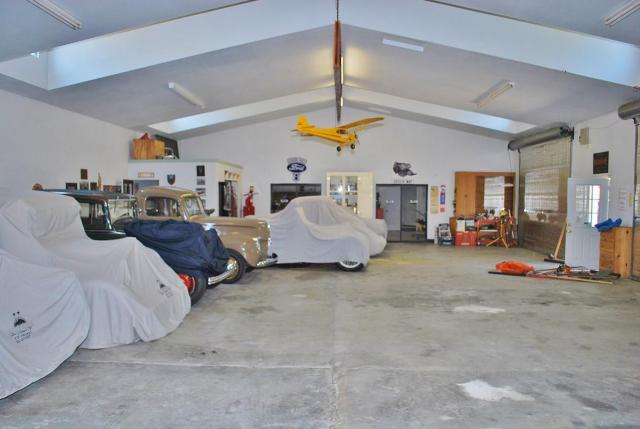

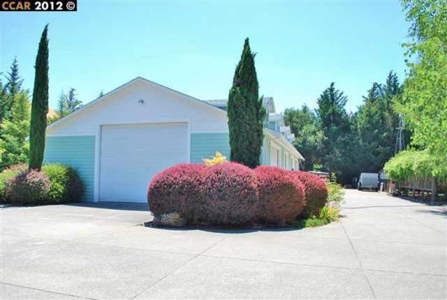

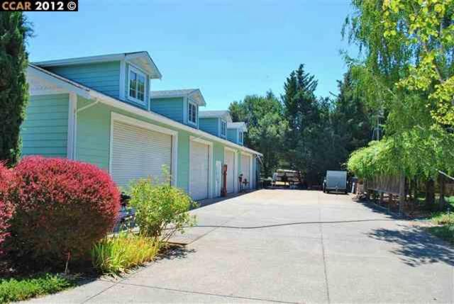

40 x 96 gable palomares shop.jpg40 x 96 side palomares shop.jpg20 x 96 palomare inside.jpg
Here's a couple of pictures of the shop/barn I like that is 40 x 96

Thats a sweet looking shop. Is that yours?
I dont care for the metal trusses/vaulted ceiling. Metal trusses I was pricing are about 4x's the cost of wood, and I dont like heating the extra space of the vaulted ceiling...
Unfortunately no... not a day goes by without thinking about the place that got away... and it's been two years.
No metal... has wood trusses and well insulated... it seldom freezes here or gets above 90... the dormers provide for natural light.
The last bay through the sliding glass door has a hoist with mezzanine and the scissor trusses provide the extra height.
It belonged to a customer of mine... one day I was out his way and saw a For Sale sign... learned he had passed away and called the Realtor and said I want it at full price AS-IS... something I never do... learned they had accepted an offer that morning that was a 100k under.
For the next 59 days I was the backup offer... been two years now and doubt I could afford it the way property went up...
One of the other things I really like is the two circular drives to move equipment/trailers around and never mud since it's all paved with 7.5" concrete with double re-bar.
