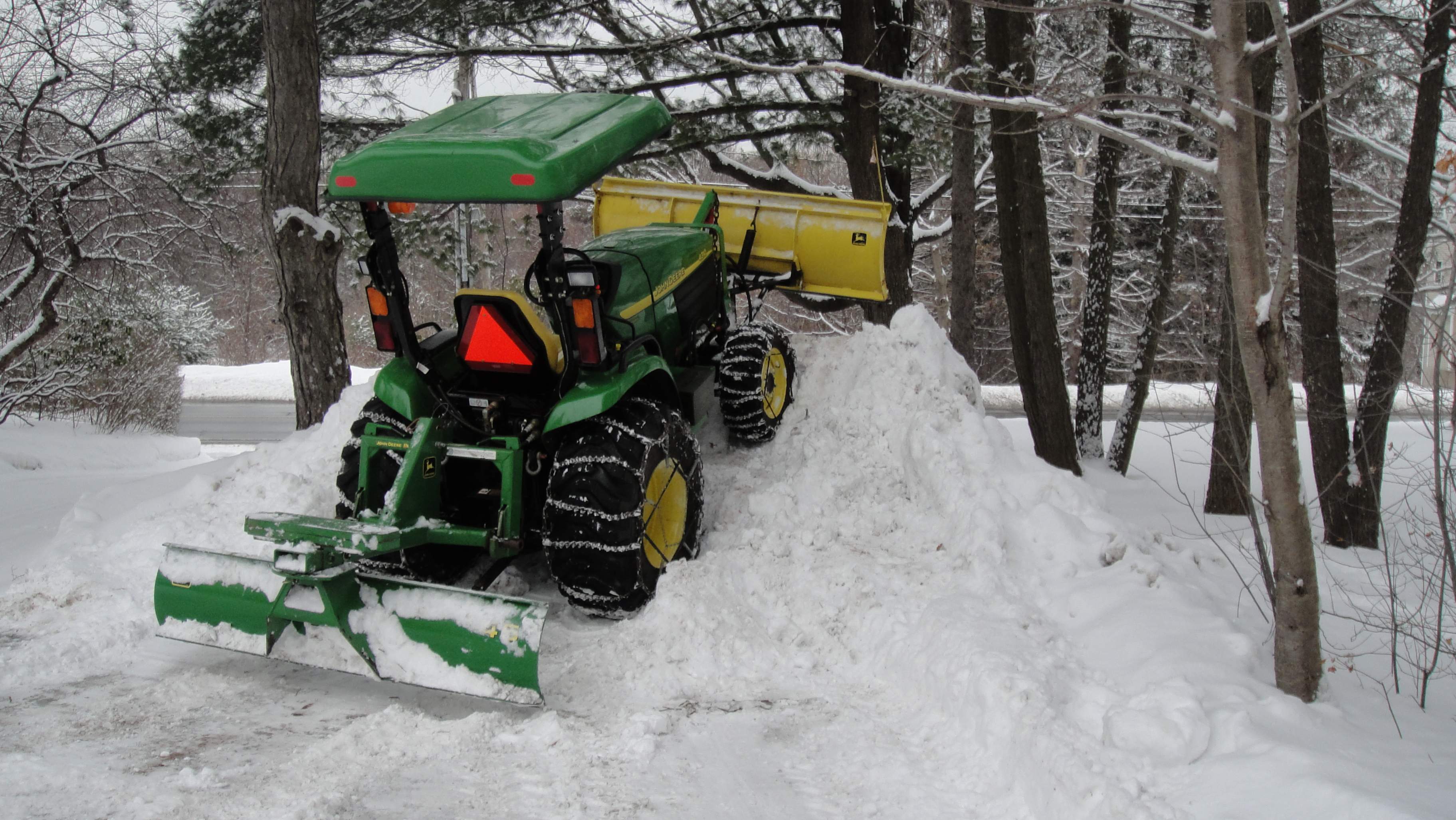

Mine is chain but it is also very heavy 8ft. on a 7000lb tractor.It also is set up with a pivot point so it can follow the contours.It also is on a QA plate so easy to reinstall the bucket if needed.

I use a 72" rear blade for pulling snow from in front of doors, no down pressure (except the extra weight I put on it) but the blade is in the correct position, not like when back dragging. Plus with the HTL I can manipulate the cutting angle and really tear up any ice I have encountered so far.
JB

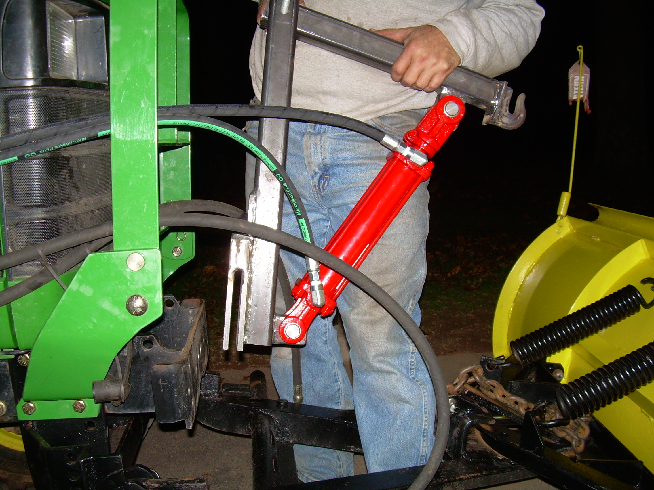

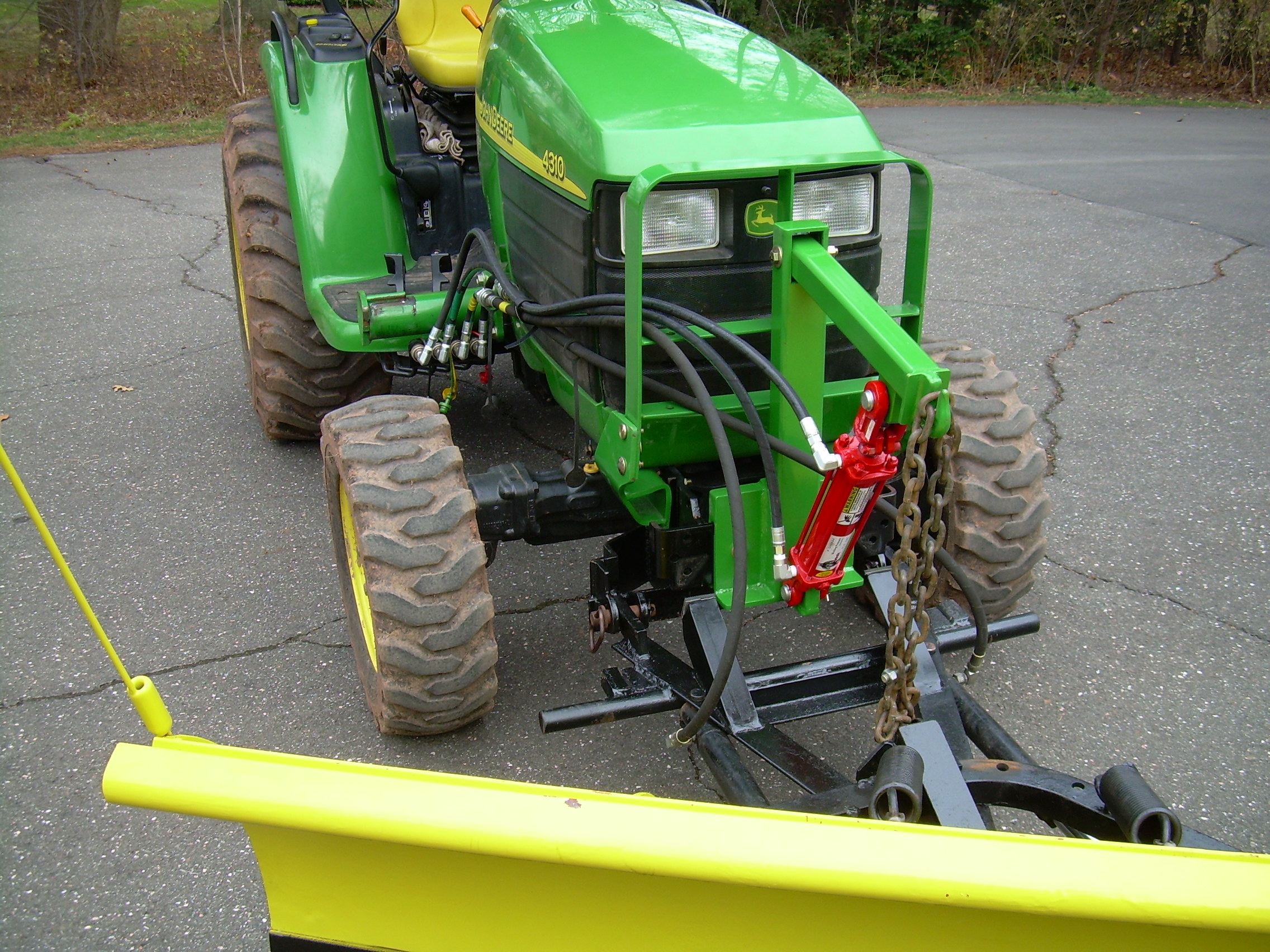

I would like to see the pics. The 2 in receiver is a good idea, just use the thickest wall you can find. I Lucked out with mine and have just enough room to leave the undercarriage on the tractor and still be able to mount the loader. My lift slips on the weight bracket and just clears the grill guard as well. I put 2 bolts in the lift frame thru the weight bracket just to stiffen it up, but they really are not needed for chain float/ no down pressure.
Those are the only 2 bolts I need to deal with to go from plow to loader.
2 bolts, 2 pins and 4 hyd lines that's it. I could change the bolts to pins so it would be no tools needed. but I can still change over in 5 - 10 minutes.
JB
