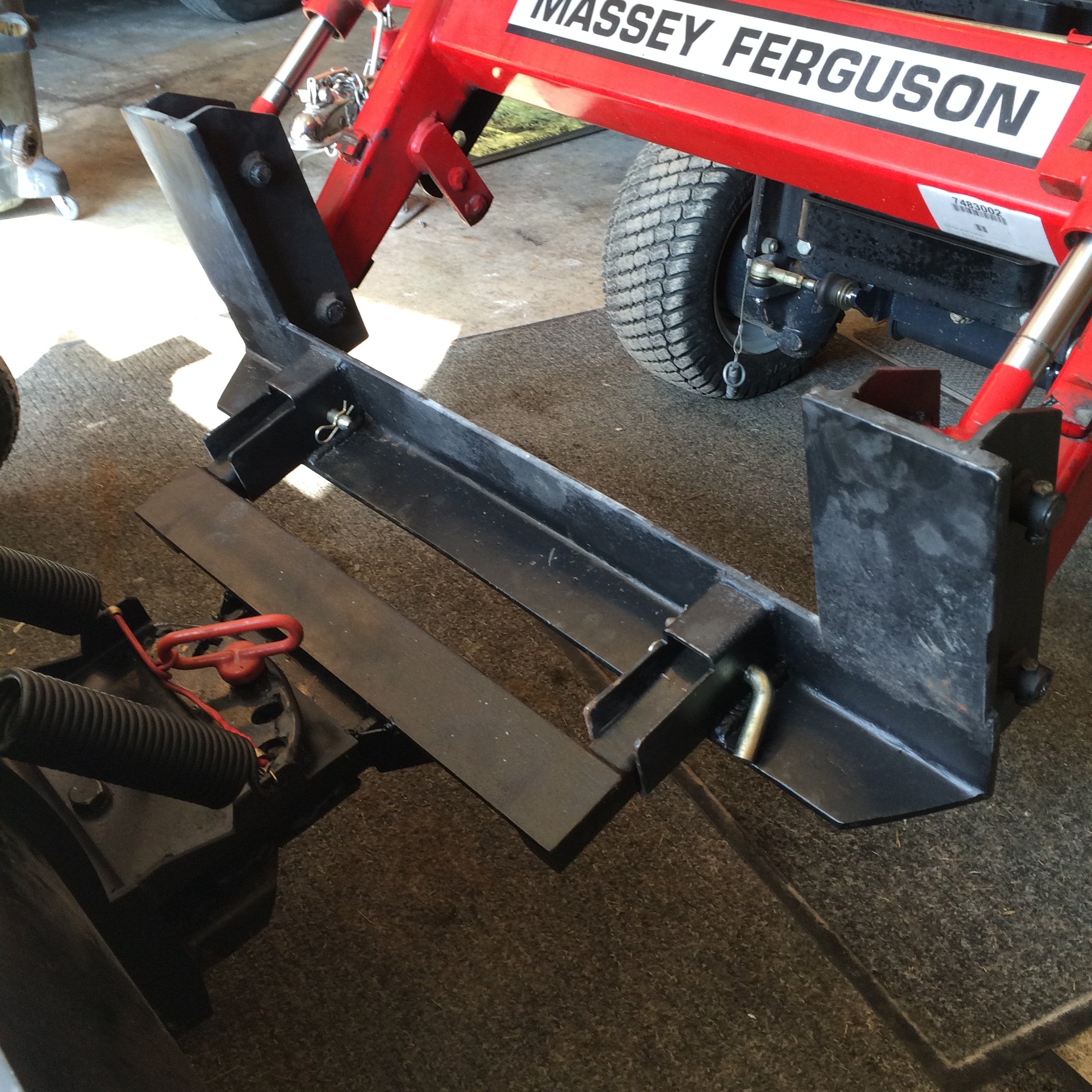

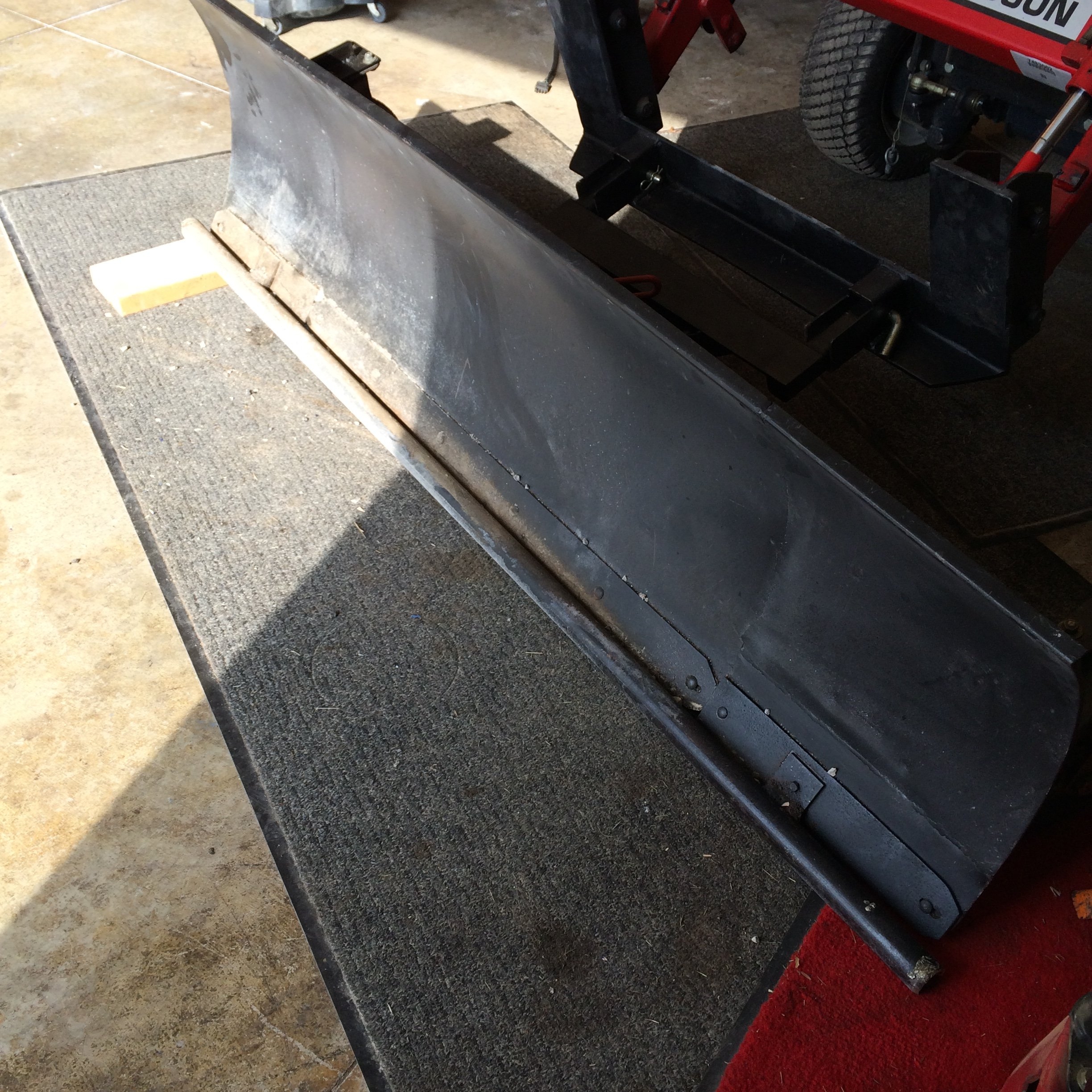

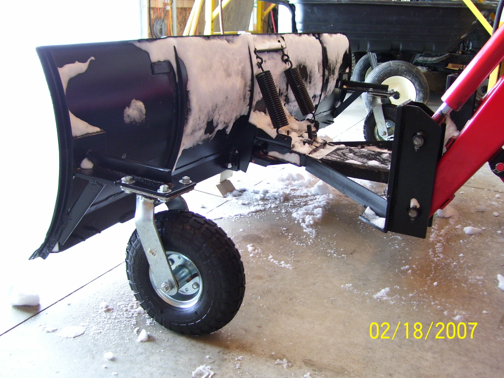

I would think casters would just dig into the gravel. Unless it’s frozen of course. That’s the problem in northeast Ohio, freeze thaw is constant throughout the winter.
The casters actually work great.
I can set the blade height anywhere from all the way down, to 4" above the ground, with the bucket tilt cylinders.
I plow over 300' of gravel driveway. And, I move less than a 5 gallon pail of gravel off the driveway, each winter.
Ideally, with gravel, you want to pack down a few inches of snow. Then, it's easy to avoid moving the gravel.
My plow hinges have a stop on the bottom, so it can't go down, just up. No chain necessary. And, I have a pipe attached to the front of the cutting edge.
