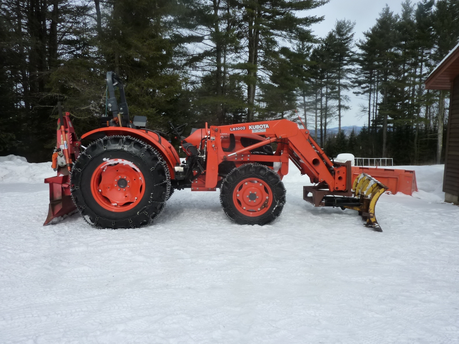

Like this maybe.... I realize my plow and what you need are probably 2 different animals but I got mine cheap at a local road commission auction and I have to run tire chains on the front wheels or it will tend to 'plow steer' me in deep snow. I did have to replace the bottom wear steel, but that wasn't a big deal and I've since added wheels on the plow instead of the original skid shoes because with the skid shoes on a gravel driveway, they tend to tear it up. It's a heavy bugger but my tractor is well capable of handling it.
I'm a little worried about how the plow will act since my driveway is all gravel also. I have been using a rear mounted scrap blade with a heavy piece of rubber mounted to the bottom for several years now. It gets the job done, but it's literally a pain to use. I'd like have the plow in front of me.

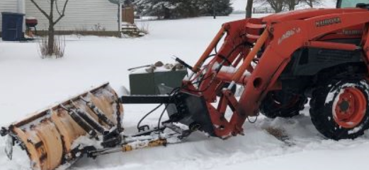

Not sure about a JD plow, but lots of people adapt a SSQA plate to accept a standard plow. Just use the 3rd function to angle the blade and tip the loader back to lift the blade. This lets the blade float just like it would on the front of a truck.
I had one that was welded solid -- with no chain -- the weight of the loader broke it within a few hours. Just puts way too much weight on the blade. This pushes the blade out pretty far, but used plows without the truck mount, lights, and pump are plentiful and pretty cheap.
Yeah, building something is an option. These things do cost a pretty penny.

Several people on TBN have built them like this. Mounts a standard truck plow but gets the plow back closer to the SSQA plate to minimize the side torque. Plow floats on chain like a truck plow but you can get down pressure while back dragging if wanted by dumping the SSQA a little. And you can stack snow a mile high and push back banks easier/better compared to a frame mount. More complicated to build though.

It works the same as a truck mounted plow on gravel. As long as you let the blade float and don't add the loader to that weight.
I think on gravel the main thing is to have the plow A-frame down low, so the angle of attack of the blade isn't overly downward and aggressive. I still move a little gravel with mine and have to spend some time pulling it back into the driveway in the spring.
