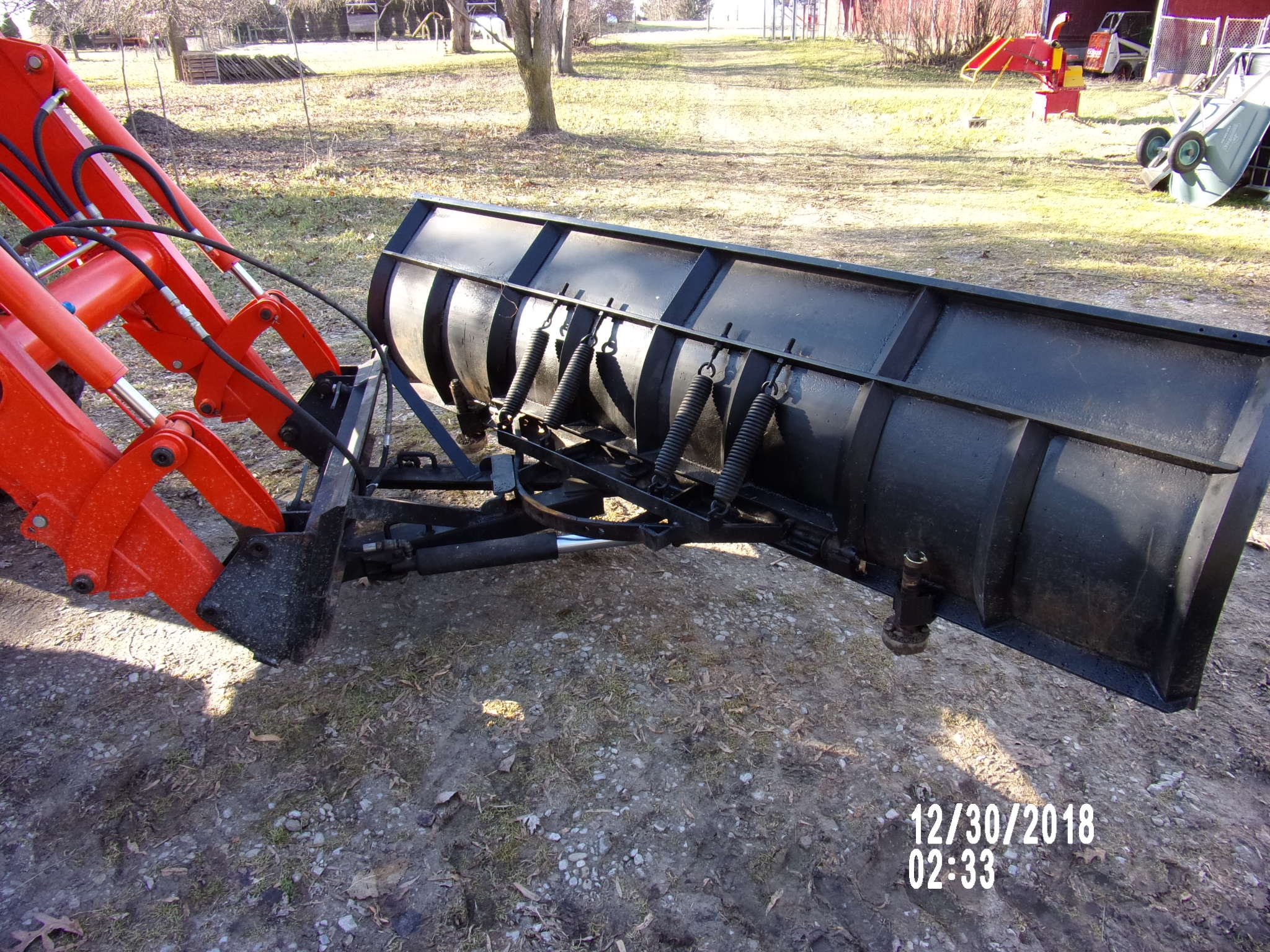

I made one. No big deal. It's a Western 7-1/2' rig on JD QA plates and some square tube.

Chain all the way. (y) I would recommend shortening the plow frame so the blade can be mounted as close as possible to the SSQA plate.
Having a rigid mount and using the float function on the loader arms tends to lift or at least lighten the front wheels.
It's more work, but I think mounting the plow to the tractor frame, like you would on a truck, works best.

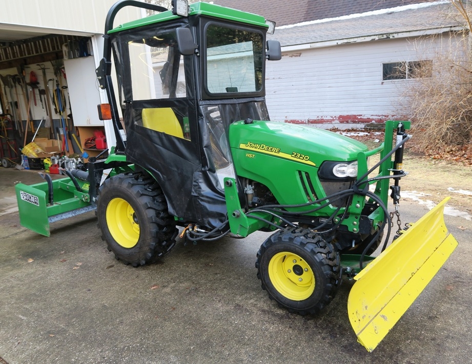

Chain works well and +1 on frame mounting. It minimizes the side push and keeps the overall machine shorter and easier to maneuver. My JD has a front subframe that is used for the mower mount and front blade mount that was easy to use for a snowplow mount.

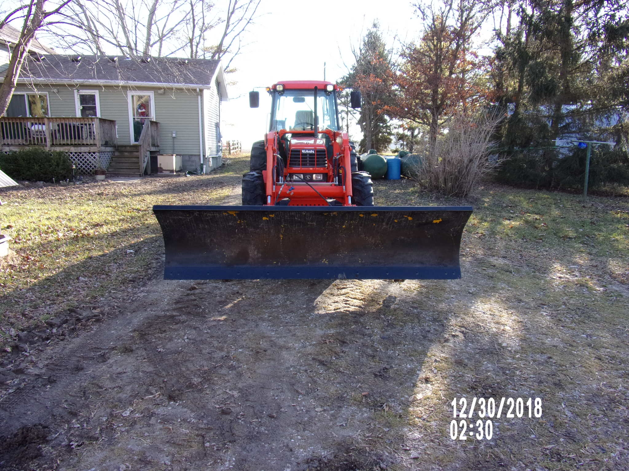

Like this maybe.... I realize my plow and what you need are probably 2 different animals but I got mine cheap at a local road commission auction and I have to run tire chains on the front wheels or it will tend to 'plow steer' me in deep snow. I did have to replace the bottom wear steel, but that wasn't a big deal and I've since added wheels on the plow instead of the original skid shoes because with the skid shoes on a gravel driveway, they tend to tear it up. It's a heavy bugger but my tractor is well capable of handling it.

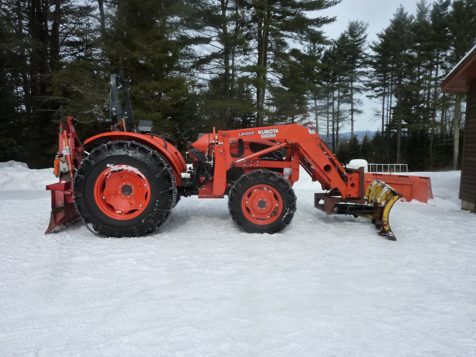

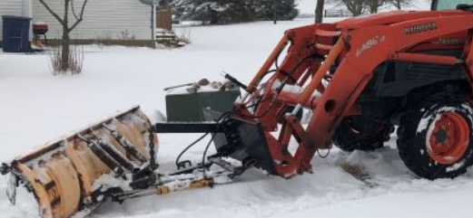

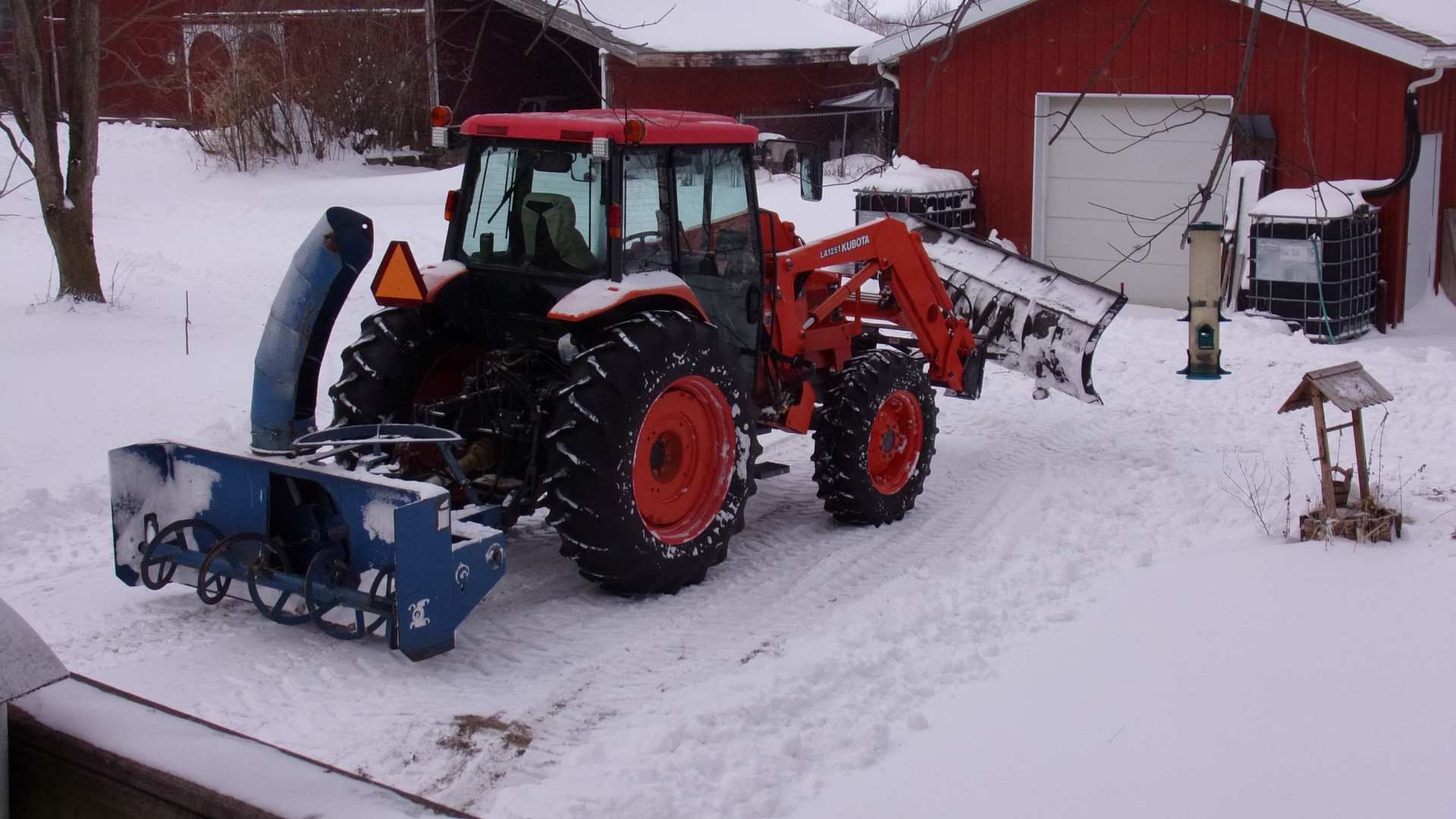

Several people on TBN have built them like this. Mounts a standard truck plow but gets the plow back closer to the SSQA plate to minimize the side torque. Plow floats on chain like a truck plow but you can get down pressure while back dragging if wanted by dumping the SSQA a little. And you can stack snow a mile high and push back banks easier/better compared to a frame mount. More complicated to build though.

Several people on TBN have built them like this. Mounts a standard truck plow but gets the plow back closer to the SSQA plate to minimize the side torque. Plow floats on chain like a truck plow but you can get down pressure while back dragging if wanted by dumping the SSQA a little. And you can stack snow a mile high compared to a frame mount. More complicated to build though.

I had seen a setup a few years back a fella had made, he said it worked great but I neve saw it in action. He mounted a braced plate to the front of his tractor that had the two ears similar to the mount on a truck for a snow plow. He left the bucket on the tractor and used a chain from the bucket to the plow to lift it. All the push was against the tractor frame, he had the float of the chain connection to the loader plow and there was no impact on the loader arms.
