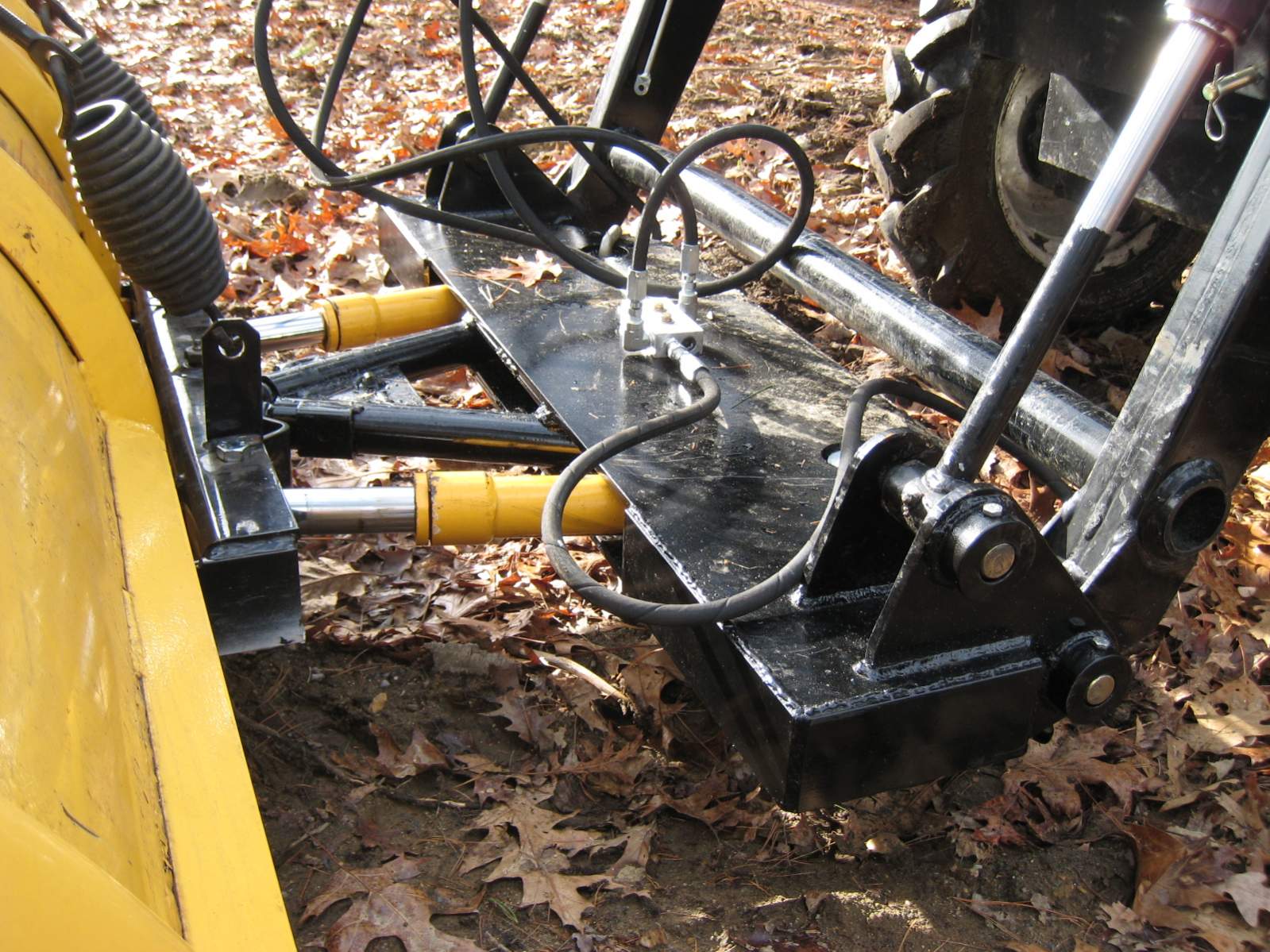

I've had a few winters now with my own Meyer swap as shown. When using float, the entire weight on the two shoes is the moldboard plus the A-frame plus the loader arms. With a chain float the weight on the shoes is less I think the float will be easier.
I felt there was too much weight and never felt quite comfortable with allowing it to float, especially on gravel. The Meyer, bought new, was previously on a Nissan Pathfinder and had fairly small shoes. This year I replaced the two small shoes with much larger ones.

Gizme - yes it's the same. Nice job on your part!
By preserving the original tubular A-frame, lift arm, and chain you've maintained the OEM float.
Once I tore off a Meyer shoe last spring, I decided to beef them up. We welded on larger tubes right next to the old ones, and simply inserted the much larger shoes.
There are benefits to having no chain because I can control the moldboard angle of attack and I can pile it really high. I guess it's six of one or half dozen of another.

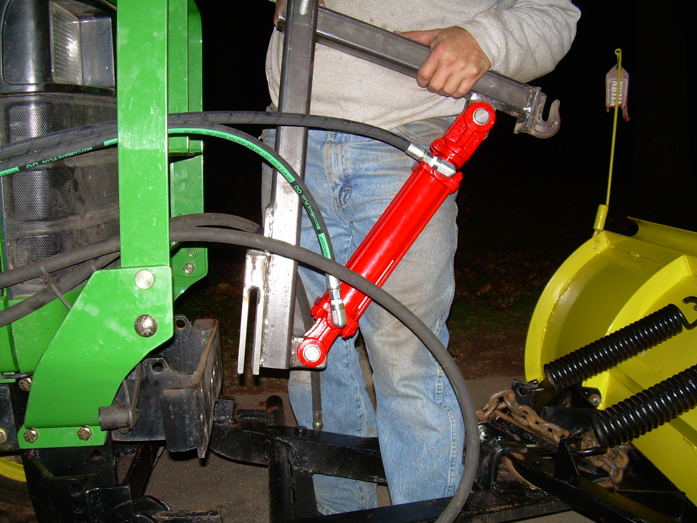

Mine is chain lifted, never tried it the other way, but as I suspected, according to others here, using the valves float feature does not react fast enough to allow the plow to freely follow the contour of the ground.
So my recommendation would normally be chain float. But only because you say this a secondary tool to bust drifts etc. You may want to go with the rigid lift link. I've personally never felt the need for it (well maybe occasionally), but the main advantage is the ability to apply down pressure, so in your case that could come in handy, plus ramming snow drifts with a plow in a fixed height could be an advantage as well, prevent it from riding up.
It would be fairly easy to swap between a chain and a rigid link, I've thought about it myself since I'm using a DA cylinder, but like I said no real need for me.

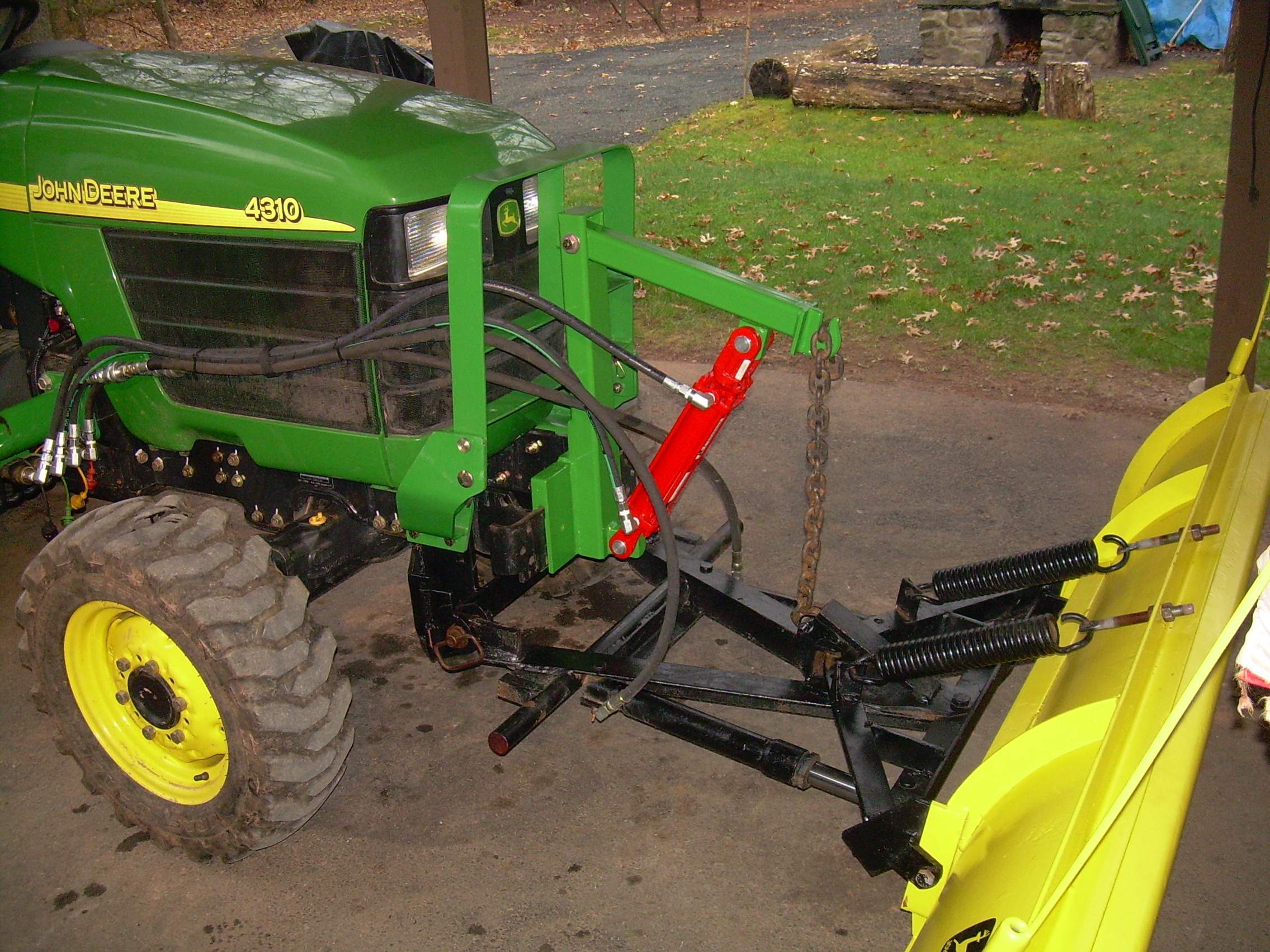

Mine is chain but it is also very heavy 8ft. on a 7000lb tractor.It also is set up with a pivot point so it can follow the contours.It also is on a QA plate so easy to reinstall the bucket if needed.

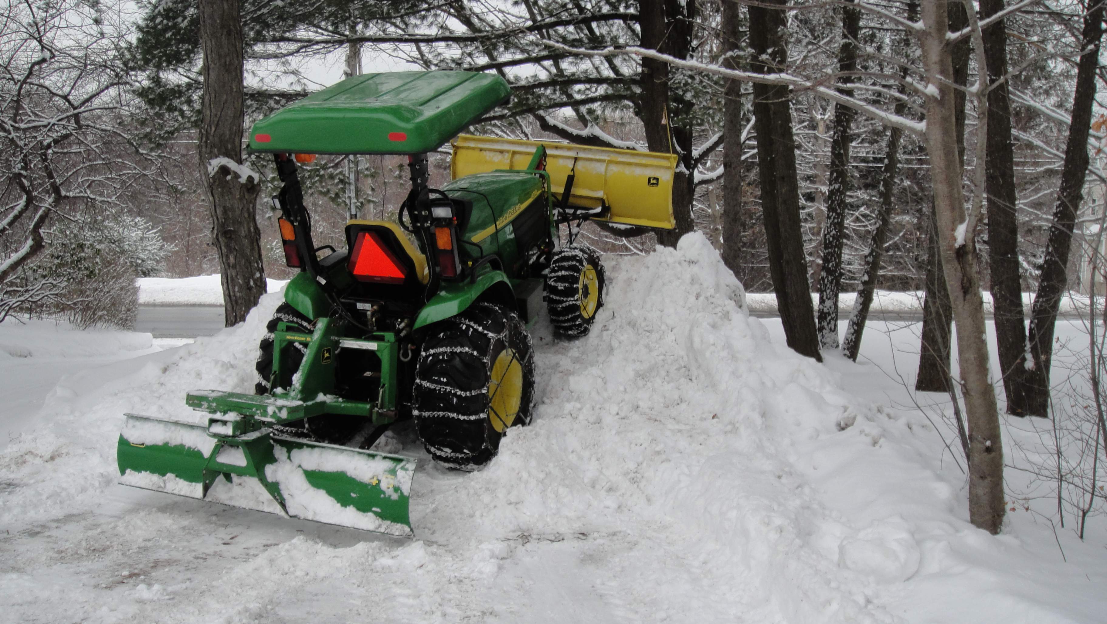

I use a 72" rear blade for pulling snow from in front of doors, no down pressure (except the extra weight I put on it) but the blade is in the correct position, not like when back dragging. Plus with the HTL I can manipulate the cutting angle and really tear up any ice I have encountered so far.

I would like to see the pics. The 2 in receiver is a good idea, just use the thickest wall you can find. I Lucked out with mine and have just enough room to leave the undercarriage on the tractor and still be able to mount the loader. My lift slips on the weight bracket and just clears the grill guard as well. I put 2 bolts in the lift frame thru the weight bracket just to stiffen it up, but they really are not needed for chain float/ no down pressure.
Those are the only 2 bolts I need to deal with to go from plow to loader.
2 bolts, 2 pins and 4 hyd lines that's it. I could change the bolts to pins so it would be no tools needed. but I can still change over in 5 - 10 minutes.
JB
