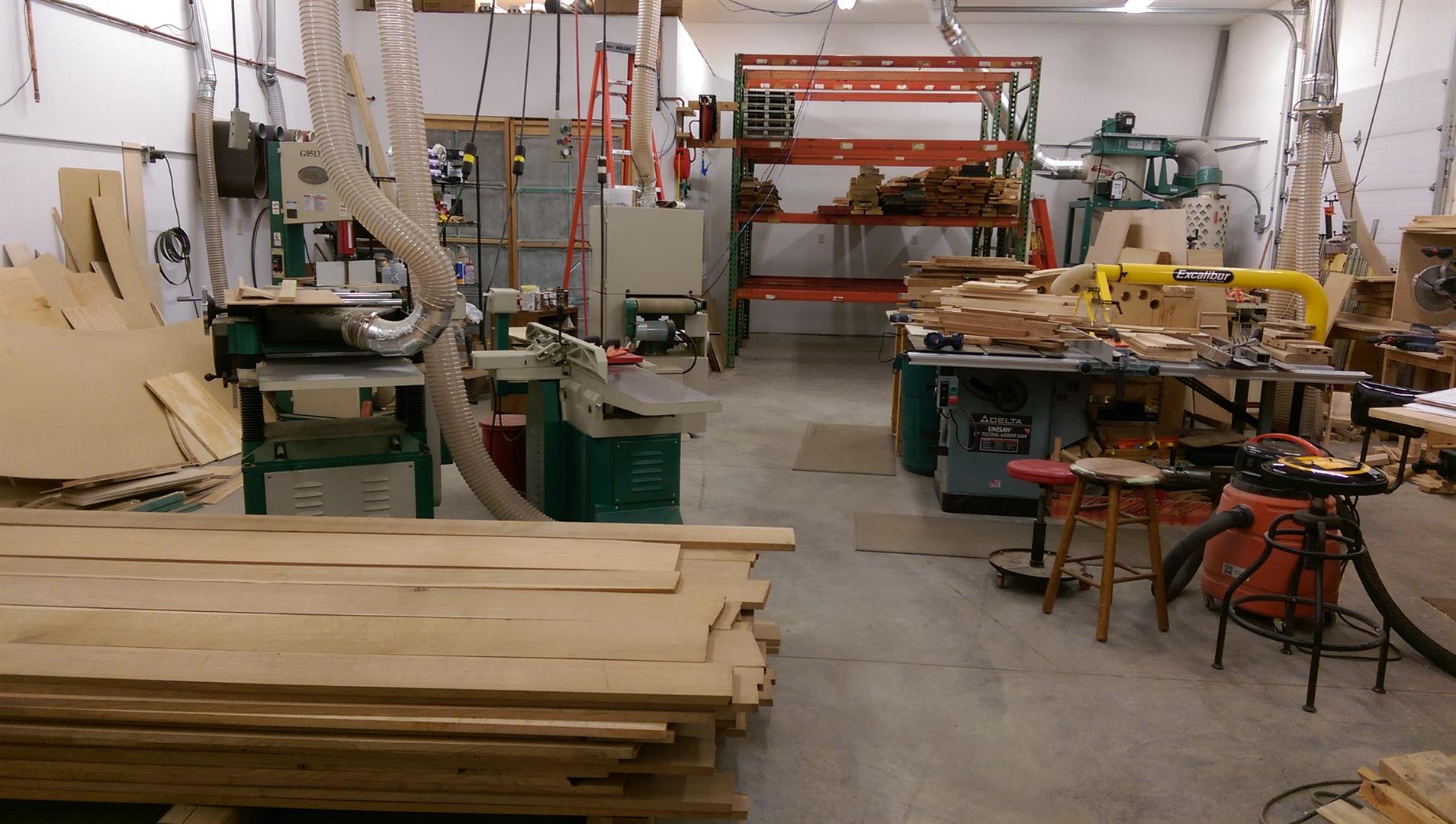

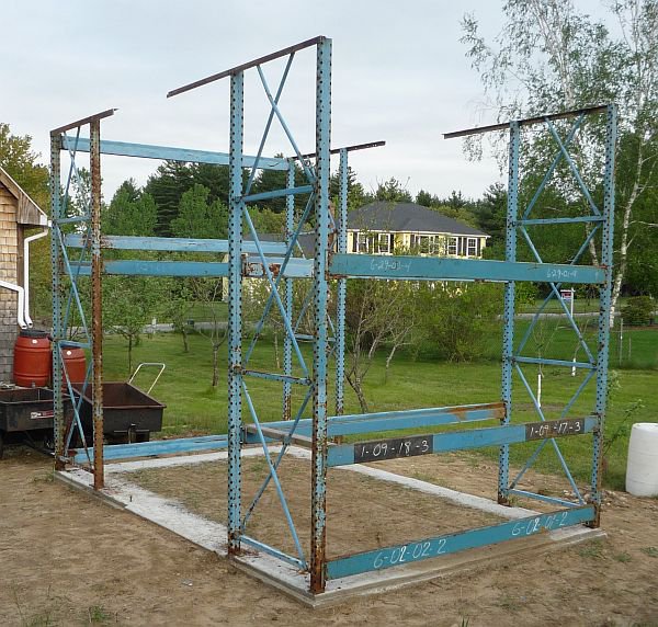

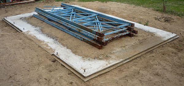

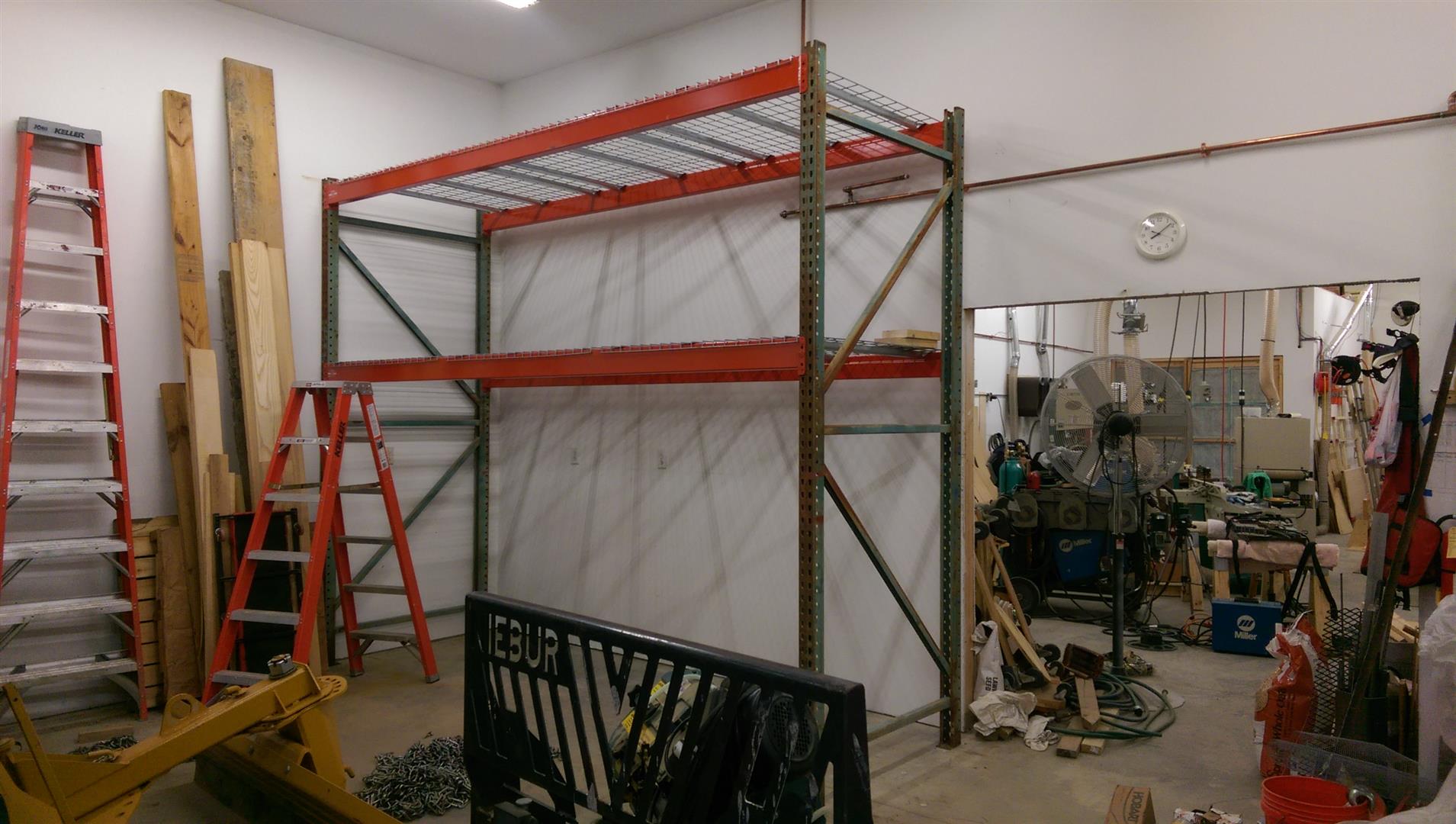

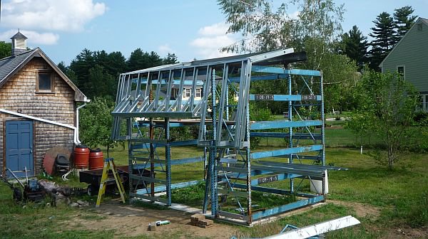

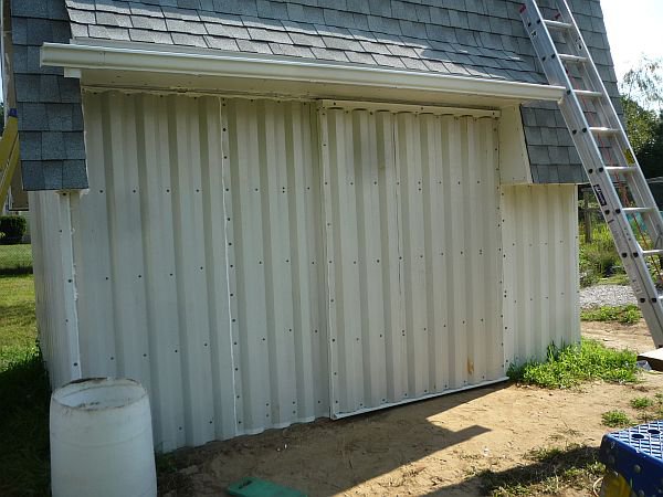

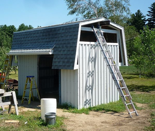

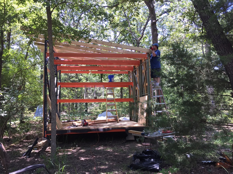

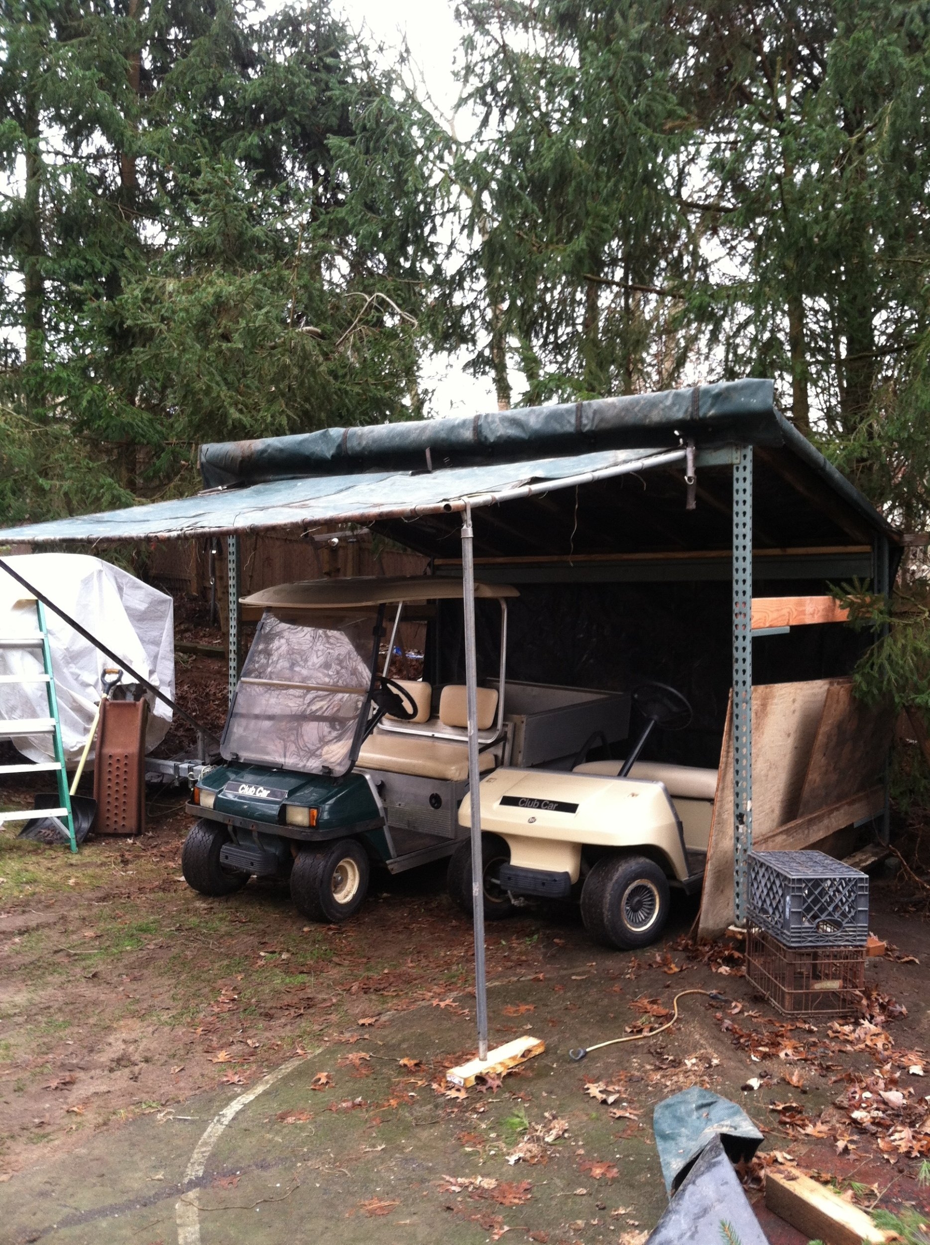

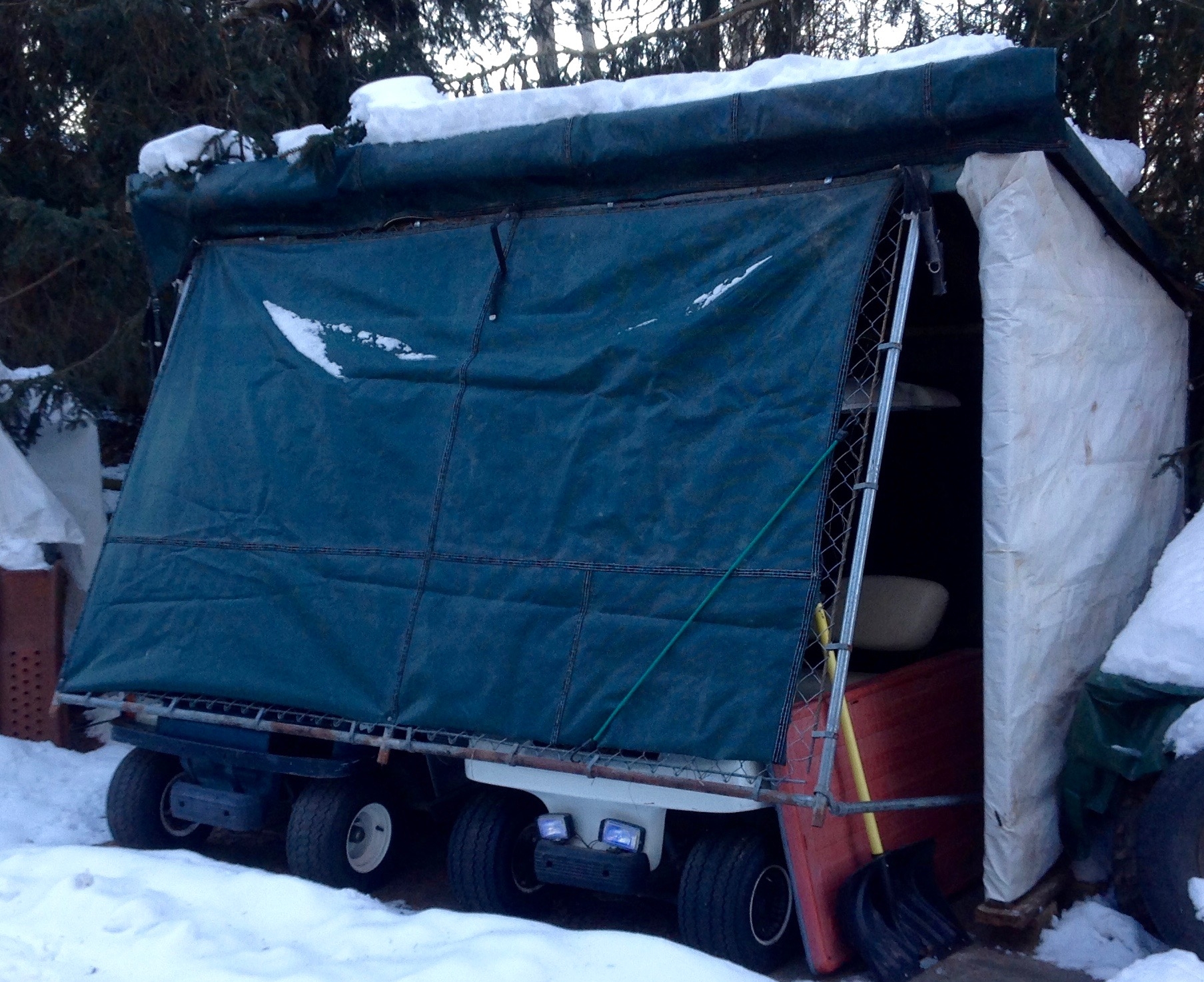

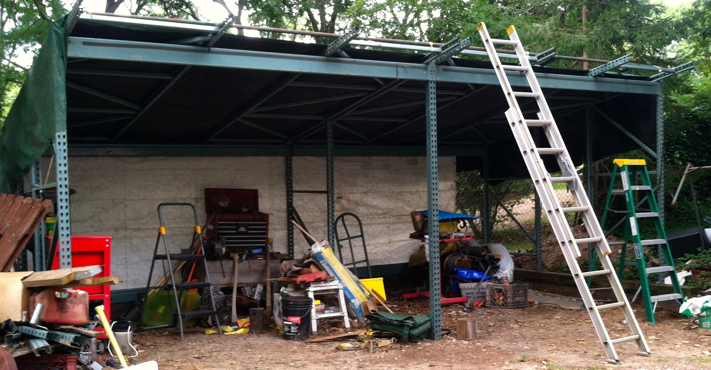

Some things I made using racking
the 2 sections with red circle are 11 ft wide and 8 ft deep

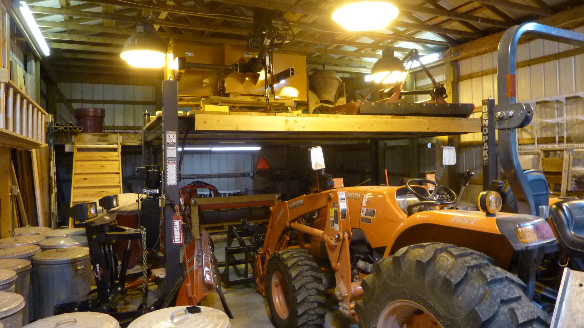

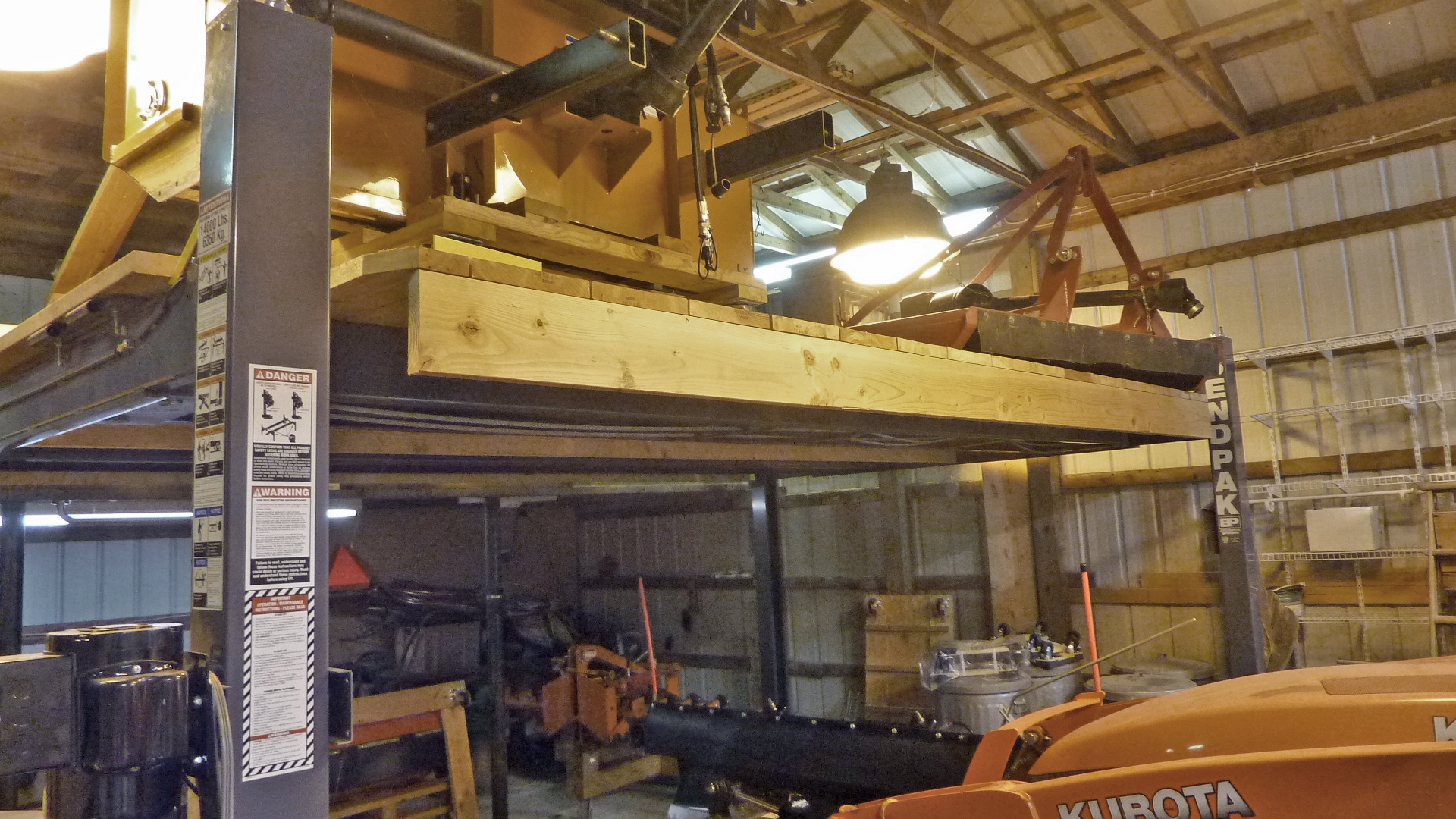

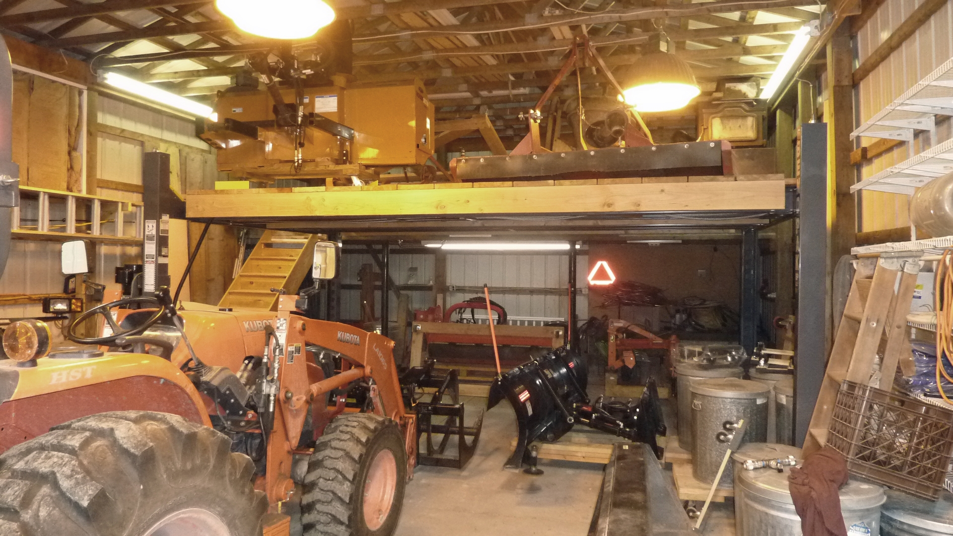

In my barn, the rack itself would take up too much valuable floor space. Instead, I use a truck service lift to store implements. I can either take them down with forks or lower the rack to the floor. I can even park the tractor underneath.
I haven't priced lifts lately but when I installed mine, it wasn't much more than a steel racking system.

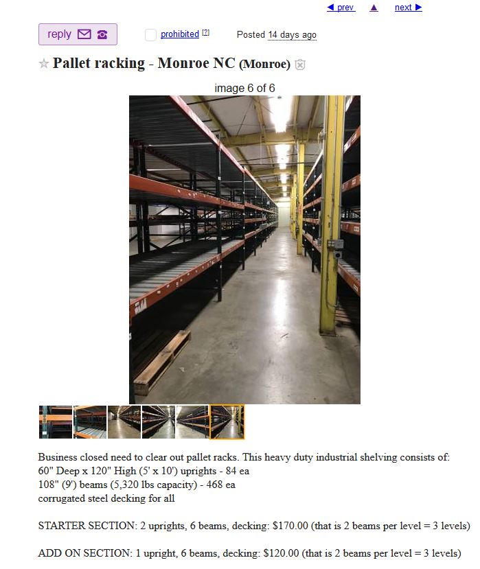

I very frequently see industrial pallet racking for sale on local clist. Lots of flexibility there with overall height, rack spacing. Way less $, super strong, and ready to bolt together and use. A lot better and cheaper than anything I'd make on my own :)
This is an example: Pallet racking - Monroe NC - business/commercial - by owner - sale <$300 for six 9' locations 5' deep.
I was buying used pallet racking and discovered I can get new delivered for the same price. They are sold certified, un-damaged, un-repaired. If you have employees it isn't worth the headaches buying used.
