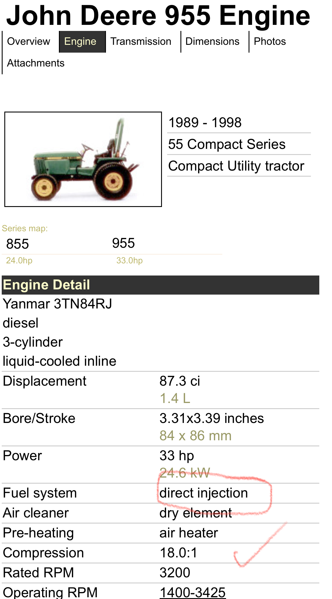

I am not aware of any Diesel cycle engines that do not make use of direct injection. The pressurized spray being required to atomize the heavy fuel being necessary I suppose.

There are many diesel engines that use a pre chamber in the head firing deck. It gives them a tighter area to burn the fuel at the beginning of the firing event. Direct injection sprays fuel directly on top of the piston on it's way up and they are shaped different to allow for this. The larger the engine the less use of pre chambers you find.
