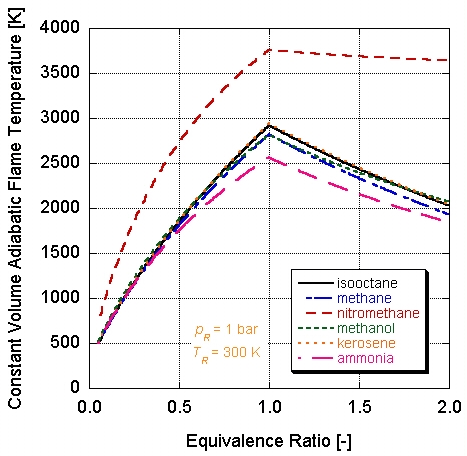

The original OP's question which can be paraphrased as, "Why is a lean burn hotter?" - shows that sometimes the difficulty putting an answer together is partly because of how the question is worded.
In post # 73, Rancher Ed shows a "fuel versus air" temperature & burn chart that explains that both lean and rich burns are actually cooler. We only get max heat when the ratio of fuel to air is perfect - which is when all the fuel is burned by all the air - i.e. a perfect stoichiometric ratio
But since engines are normally designed to run a bit rich, when we start adding more air we may think we are burning lean, but what is actually a happening is the temperature goes up because we are moving our rich mix closer to a perfect air/fuel burn ratio. Once we pass that perfect ratio and really do start burning lean the temperatures drop again.

Your statement above makes some sense. I'm gonna need to think about it and learn about how diesel burns compared to gasoline. I think the way the fuels burn is the reason, or main reason, for the differences in temperature. You also stated that when the diesel is injected it starts to burn when the right (stoichiometric) ratio is achieved. I think you are partly mistaken. I think the fuel starts to burn as soon as it can and doesn't care about the stoichiometric ratio. I still am trying to learn why the very lean burn condition of a diesel engine doesn't lead to the very hot conditions that very lean burning gasoline engines experience. And just to be clear, I am not talking about diesel engines with electronic controls, but instead diesel engines with mechanical injection. Like the engine in my 43 year old Yanmar. As near as I can tell even gasoline engines with fuel injection still burn too hot when running too lean.

The reason a gasoline engine will run hot and potentially melt pistons when run "lean" is that a diesel engine generally operators under a different portion of the "lean" spectrum. As shown below, peak flame temperature is achieved at the ideal air/fuel ratio (stoichiometric ratio), with the flame temperature being lower at both richer and leaner conditions.
In a gasoline engine, the goal mixture for maximum power is actually slightly rich. Visually this means the engine is operating somewhere on the sloped line between 0.5 and 1.0 in the above image. Adding air to the original "goal" mixture moves the air/fuel ratio closer to 1.0, which increases the flame temperature. This new condition is leaner than the original "goal" but is not actually "lean" in the absolute sense. If you continued to add air past the stoichiometric ratio the flame temperature would come back down and the engine would run cooler again on the right side of the peak.
This article from Summit Racing shows some common ratios for cruise, idle, and Wide-Open-Throttle relative to the stoichiometric ratio: Summit Racing - Air/Fuel Mixtures
Diesel engines operate on the opposite side of the curve: At idle they are way past 2.0 on the right side of the peak flame temperature with a very high air/fuel ratio. As more fuel is added, the air/fuel ratio gets richer and richer, moving the ratio closer to 2.0 and eventually 1.0 where the peak flame temperature occurs.
To summarize, they respond to becoming more rich or more lean differently because they operate on different sides of the peak flame temperature. WHY gasoline engines run slightly rich instead of designing the engine to handle the peak flame temperature is another topic, and likely has to do with engineering/control of the process, cost, emissions, and/or all of the above.
