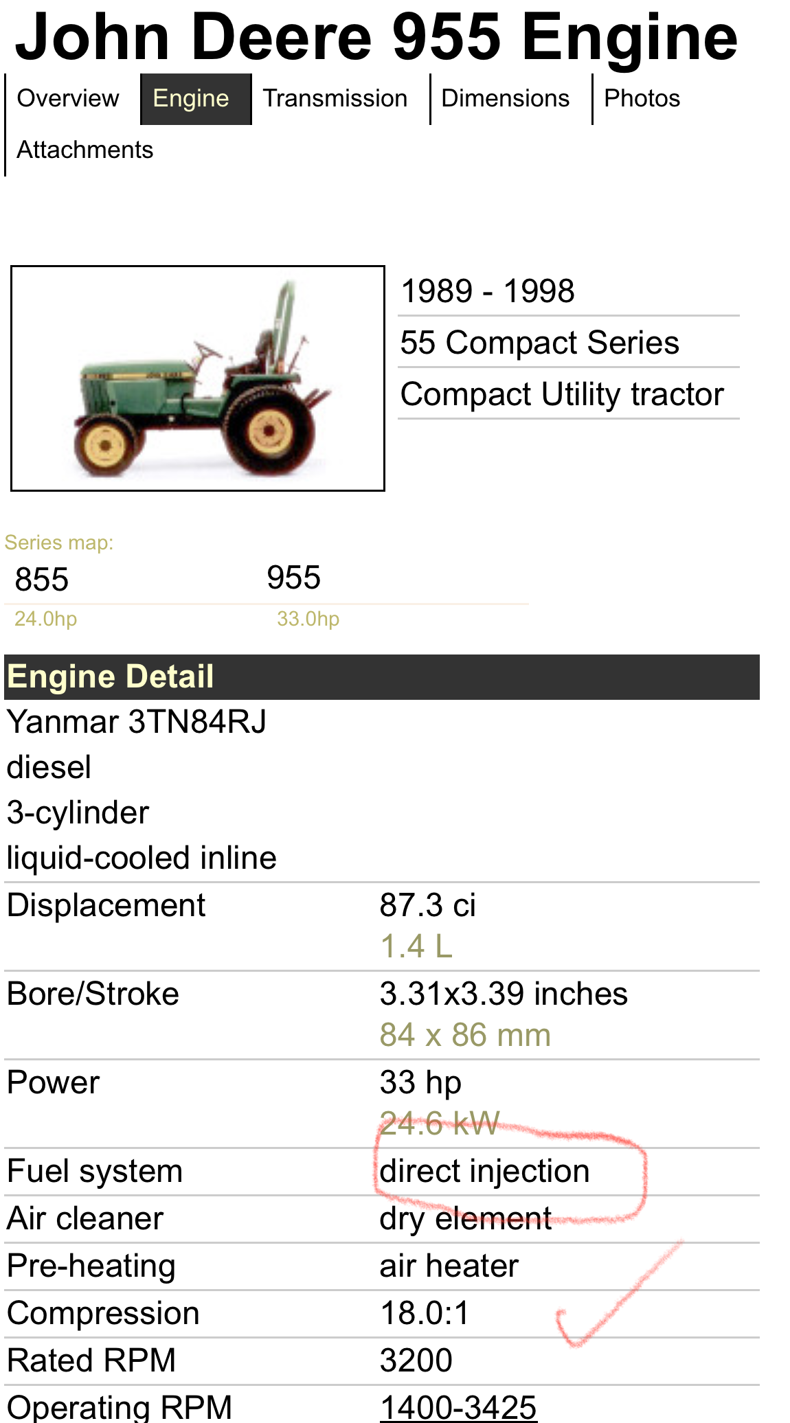

Looks like you have that backwards. Direct injection diesel, tends to have a lower compression ratio, not higher
My old John Deere 955s (Yanmar 3-cyl port injected) were only 18:1 compression ratio. If I recall, all of my 3-cylinder Kubotas were DI and in the low 20s CR.
   / Please explain this difference between diesel and gasoline engines #104

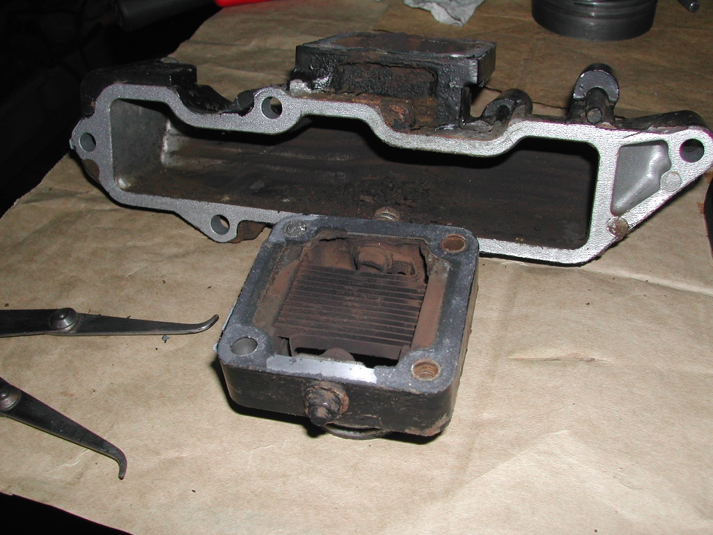

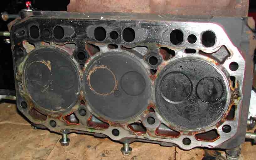

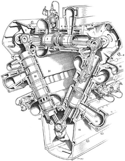

Why are the newer diesel engines a lot quieter than they used to be? Because some electronic engines atomize the fuel in as many as 6 times before the final event where they make the power. With different amounts of fuel. Comparing diesels to gasoline engines is like comparing apples to oranges, except intake compression power exhaust. Unless it is of course a two stroke diesel engine. Or, an opposed cylinder diesel engine. As in the Napier Deltic engines.
