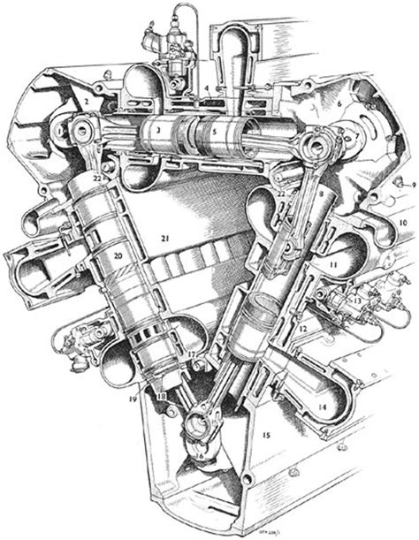

Why are the newer diesel engines a lot quieter than they used to be? Because some electronic engines atomize the fuel in as many as 6 times before the final event where they make the power. With different amounts of fuel. Comparing diesels to gasoline engines is like comparing apples to oranges, except intake compression power exhaust. Unless it is of course a two stroke diesel engine. Or, an opposed cylinder diesel engine. As in the Napier Deltic engines. View attachment 2726359
Actually, they are closer than you think, now that Direct Injection is Widely Used in Spark Ignition Gasoline Engines.
You are correct about Multiple Injection Cycles though making the Diesel Compression Ignition Engine quieter.
So main difference is Spark vs Compression Ignition, and the Build Strength to Handle either, and Potential Energy Found in either Fuel, I believe Diesel has 25% potential energy, weather the Engine design can harness the extra or not is another topic.
