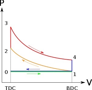

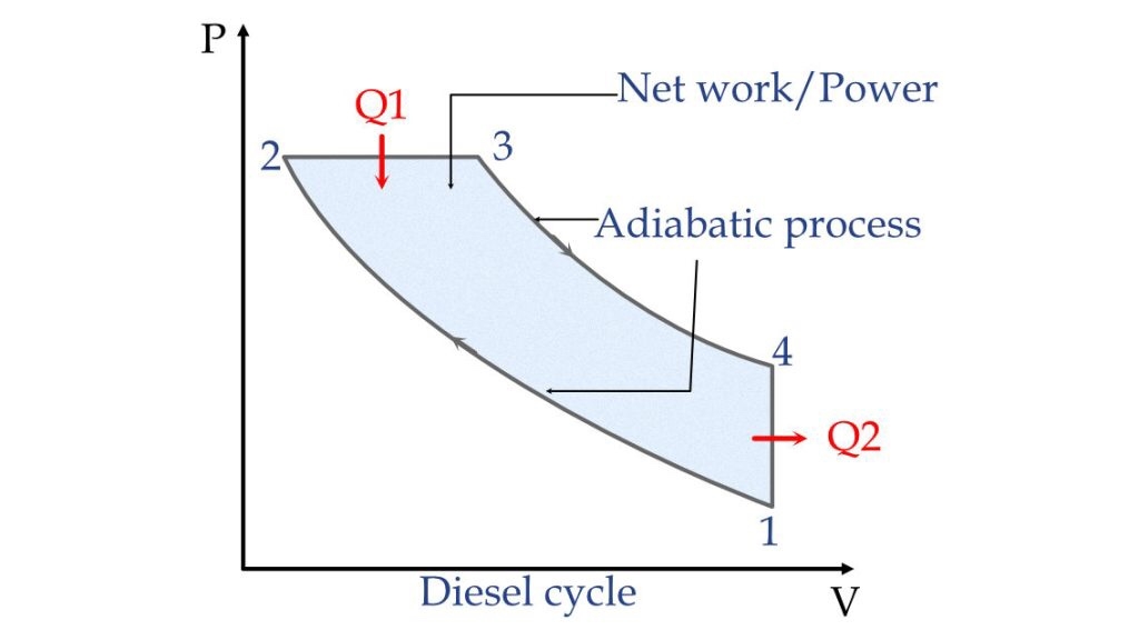

Carnot cycle teaches us how higher compression ratios produce greater thermal efficiency. That is why the Prius runs up to 13.5:1.

Some people refer to diesel engines as "Compression ignition engines" and petrol engines are referred to as "Spark Ignition Engines".
A diesel engine initially compresses air, the process of compressing the air generates large amounts of heat, when the piston is nearing the top of its stroke
we then inject very high pressure atomized fuel into the combustion chamber, when atomized fuel is injected into the high pressure/high temperature air, combustion occurs.
