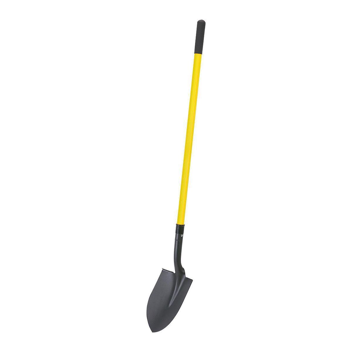

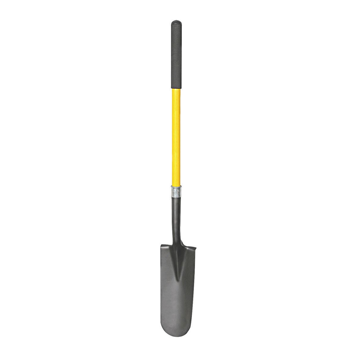

I'm thinking drain spade and a regular spade to clean out the hole. Yes. Those are Harbor Freight images. That drain spade is $15 compared to Lowe's which is something like $54. I can break a couple and still be ahead buy from HF.
View attachment 754970View attachment 754971
If you don’t currently own a shovel, skip the Harbor Freight shovels and get a good, heavy, quality shovel that will last you a lifetime. I bought one when we got married in 1985 and still use it. I have my dad’s shovels as well.
But, yes, I have on occasion purchased Harbor Freight tools and figured them into the cost of the project, and if they survive the project, then, yes, I’m ahead! (y)

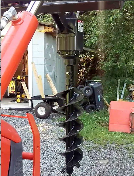

You say New England and your picture shows a lot of rocks.
My limited experience with 3 pt mounted augers in rocky ground with hardpan is that they are just about worthless.
Every time you catch a rock 4" or larger they jump all around digging an oval hole and then it starts just bouncing up and down.
If I was going to try and auger the holes I would rent a SSQA mounted hydraulic powered unit, if your tractor
can't power it rent the skidsteer that can.
future_vision,
You mentioned chain sawing aggravated your wrists so digging by hand ( shovels, clam shell post hole diggers, or manual augers including posts 23 and 24 ) are all going to be hard on the wrists due to lifting and torque when you hit rock and New England has lots of rock unless you are working in river bottom silt/ sand and your pictures show upland and lots of rock.

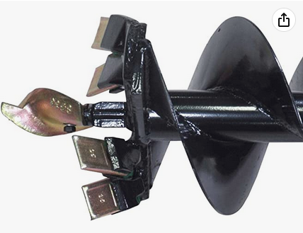

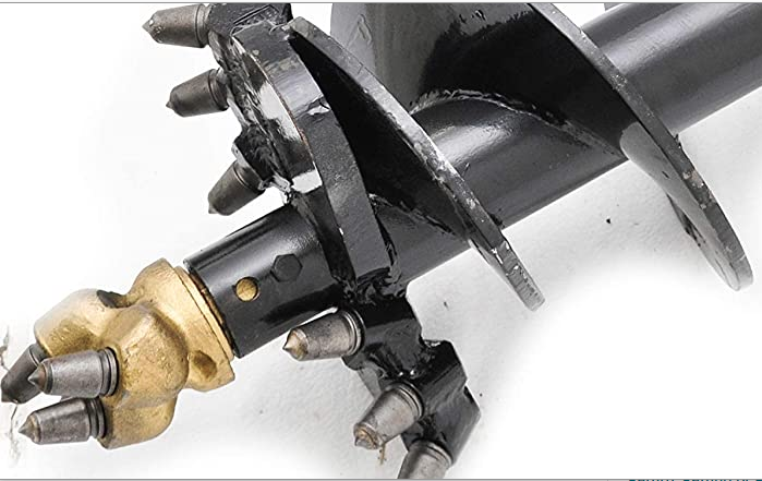

LouNY is correct about 3 pt augers. They only spin in one direction and get easily bound up by catching the cutting edge on buried rock. Auger heads come with two types of cutting edges, spade and rock or bullet teeth. Spade teeth tend to bind easily on large roots and rocks that the torque won't bring up out of the hole.
That leaves you with a SSQA mounted onto a small riding skid steer/trackhoe or a walk behind skid steer. The SSQA mounted augers can be run in clockwise for digging and counter clockwise for unbinding an auger that catches rocks or roots. There are plenty of mentons in TBN of people using 3 pt augers that had to hand dig an auger out because it got too bound up to pull it back out of the hole.
I live in the mountains of NC where you can't put a spade into the ground without hitting rock. Digging holes with backhoe means moving rock and boring holes requires a rock auger.
If you really want to do this yourself then consider the skidsteer and SSQA auger option or hire a landscaper or fence installer to dig some holes.
pics. rock auger, spade bit auger, SSQA McMillen auger on FEL of M59 tractor
