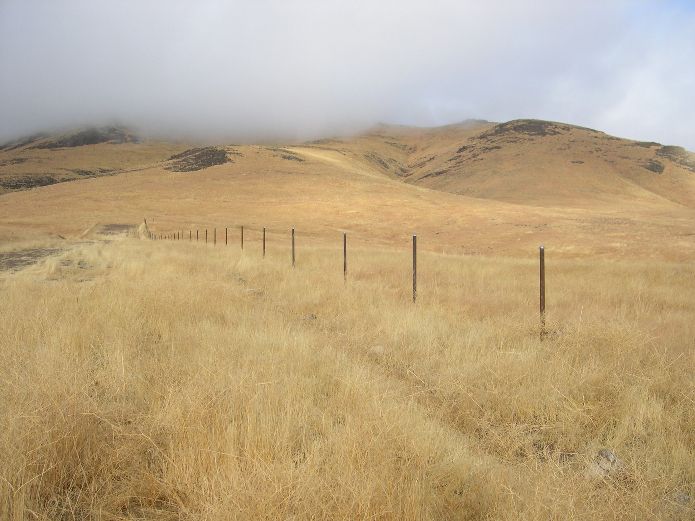

Brad, If you use your backhoe the hole is going to be too big and it will be hard to pack the dirt back around the post. If you are setting them in concrete you will be using an unforgiveable amount! I had a three point post hole digger and got rid of it because my hand held one person earthquake digger is faster and easyer for me to use on slopes and rough terrain. My posts are only 2 and 7/8 inch in diameter and a 3 inch auger bit is easy to drill with. I also have a 6 inch auger bit I use when I am setting them in concrete. If I do get a post hole digger for my tractor in the future it would be a hydrolic one that attatches to the front bucket. This is just my opinion and what has worked for me. Attatched is a picture of some of the posts I have set in concrete and drilled with the one person earthquake digger.
