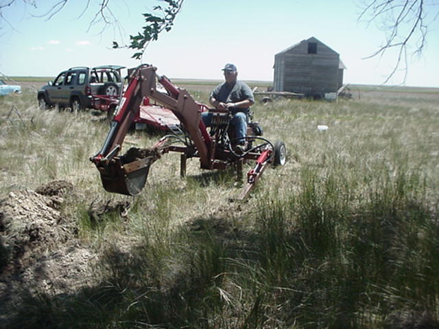

I just bought this one for $2100. It is homemade from plans I suppose. Don't have it yet home so I can't tell you how it works. I bought it primarily to put in about 1200 ft of irrigation ditch to increase watershed of my pond. I will report how it works when I get it home sometimes by the end of April.

That's pretty nice Redneck. And less than half the price of the DR, plus hydraulic legs. That's very nice. I want one (lol). Seriously, if someone by me made those, I'd have one in a heartbeat.
Forgot to add above; Without stringing a line and measuring, I think I'll be lucky if I can get 18" deep. I'm running the drainage into a ditch, so I can't get too low or I will have to run uphill to stub it out of the ground.

He is in Hudson Valey area. The URL says that. But I didn't read his add right. He is not selling but looking to buy one. There was one very nice self propeled factory made for sale on ebay last week. Sold for $4180. I called the factory and they were asking $20000 for new one. They also told me that they have several used for sale. Here is the link to the factory site.

I think the biggest drawback is their low weight while trying to break in the ground. But once you get down deep the weight doesn't matter much I think. I will post my experience after I get some work done with my machine. It will always beat a shovel I suppose.

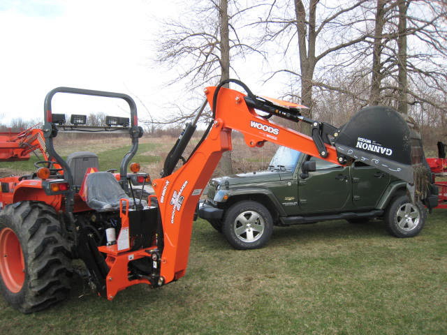

Well just to update, I bought a backhoe today.
It'll be nice always having one always available without having the constrictions of renting. At least that's what I keep telling myself :rolleyes:
