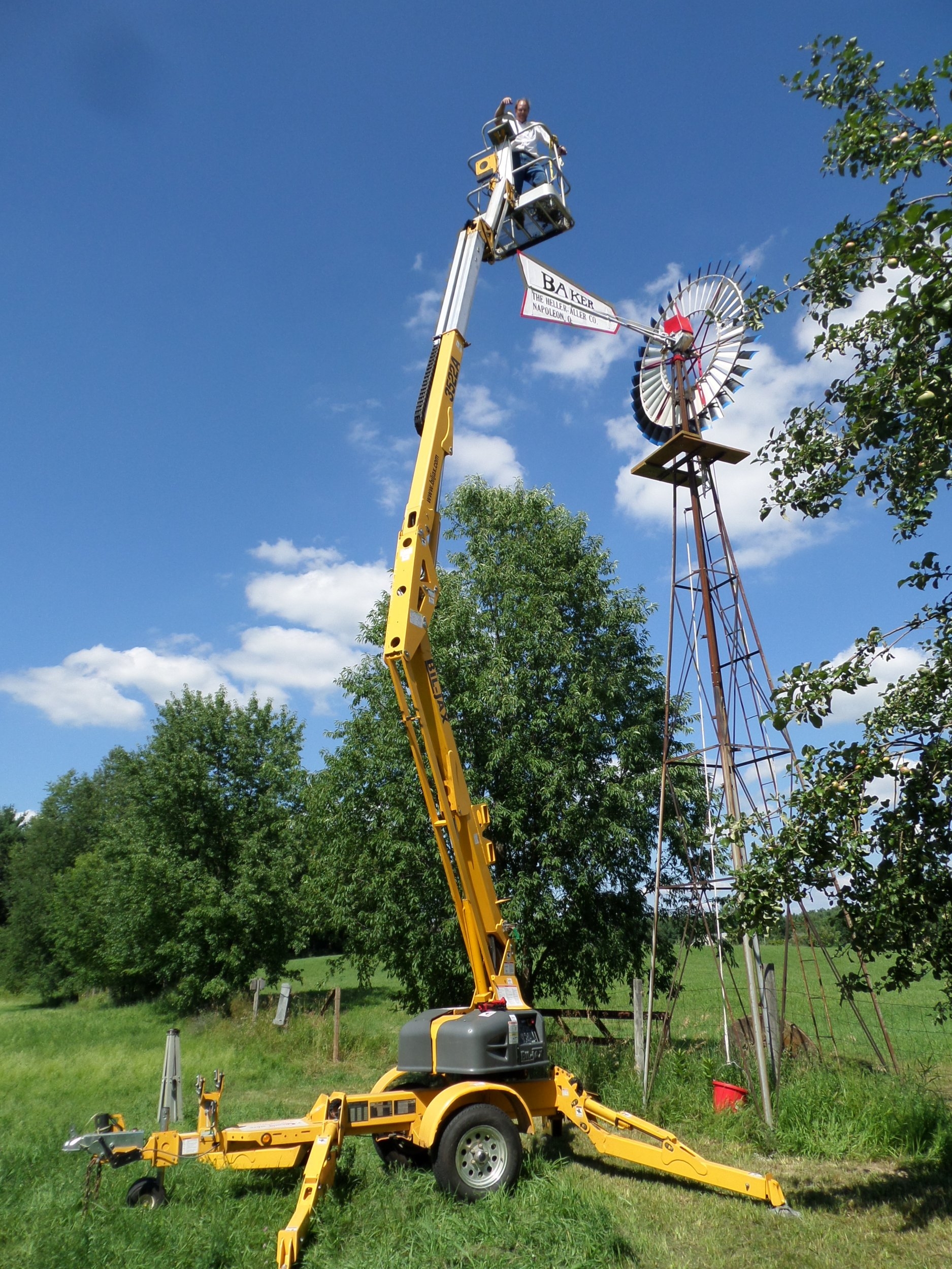

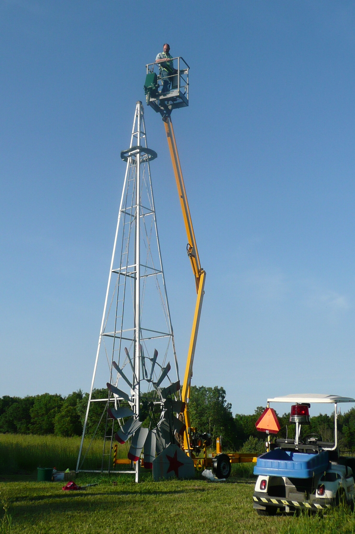

I have a JLG T-350 battery powered towable lift. It certainly changes the way you work by giving you safe access to heights. I use mine for installing & servicing my collection of old farm windmills. Tree trimming, even to repair flags stuck up on a 30' pole. Painted the barn, etc.
Mine has auto leveling so it rocks & rolls until the pivot is vertical. It also has safeties which prevent you from unloading any outrigger. My bucket disconnects so I made up a jib crane boom that hooks onto it. It has ground station controls as well as a bucket control panel. It's pretty heavy and as such requires a title here in Michigan. Mine was a used one from Home Depot as a rental unit. I had used several other brands as well as the JLG and liked battery units because, in working with others on the ground, you can talk in a normal conversation voice. Plus it has surge brakes. Hook it up to any vehicle or tractor (don't use a golf cart, you can't steer it very well with the front wheels off the ground).
Be sure to carry a spare tire ! When it sits for a long time tires can get brittle and blow out. I found out on the expressway and was glad to have carried a spare tire for it, a jack, a battery impact AND the correct driver socket, AND a flashlight !
BTW: when your neighbors find out you have one, you'll be hanging Christmas lights for 2 weeks straight for them.
