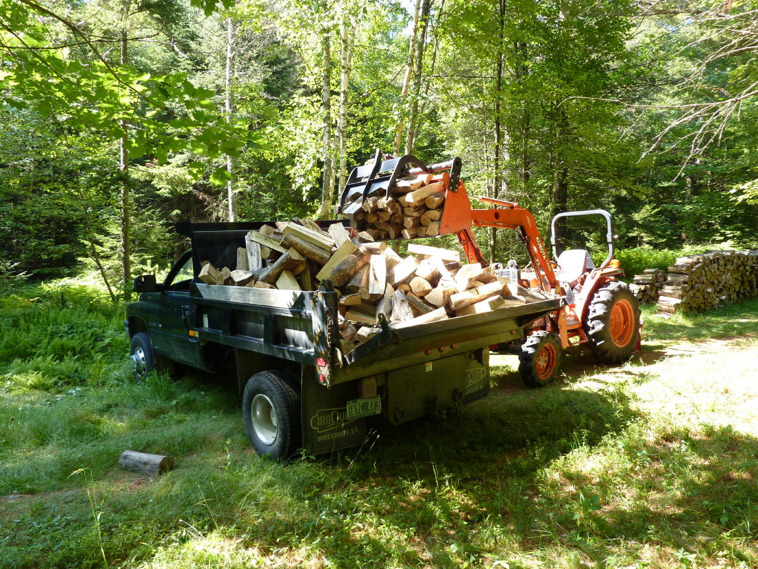

I have an ATI bolt on grapple. Fits a wide range of buckets. My bucket is 5'.
I couldnt make the link to Millonzi work so I dont know exactly what you want. Maybe something like the ATI will work for you.

I have been trying to decide between a bolt on grapple like yours and a dedicated grapple. It looks like your bolt on works well.

It does. It is not as good as a dedicated unit but for me it was a good trade with my semi-perminent mount bucket. I did add some teeth to the grapple fingers to give it more bite. I cut some short pieces of 1/2" rebar and welded them on. You can see them in this picture I think.

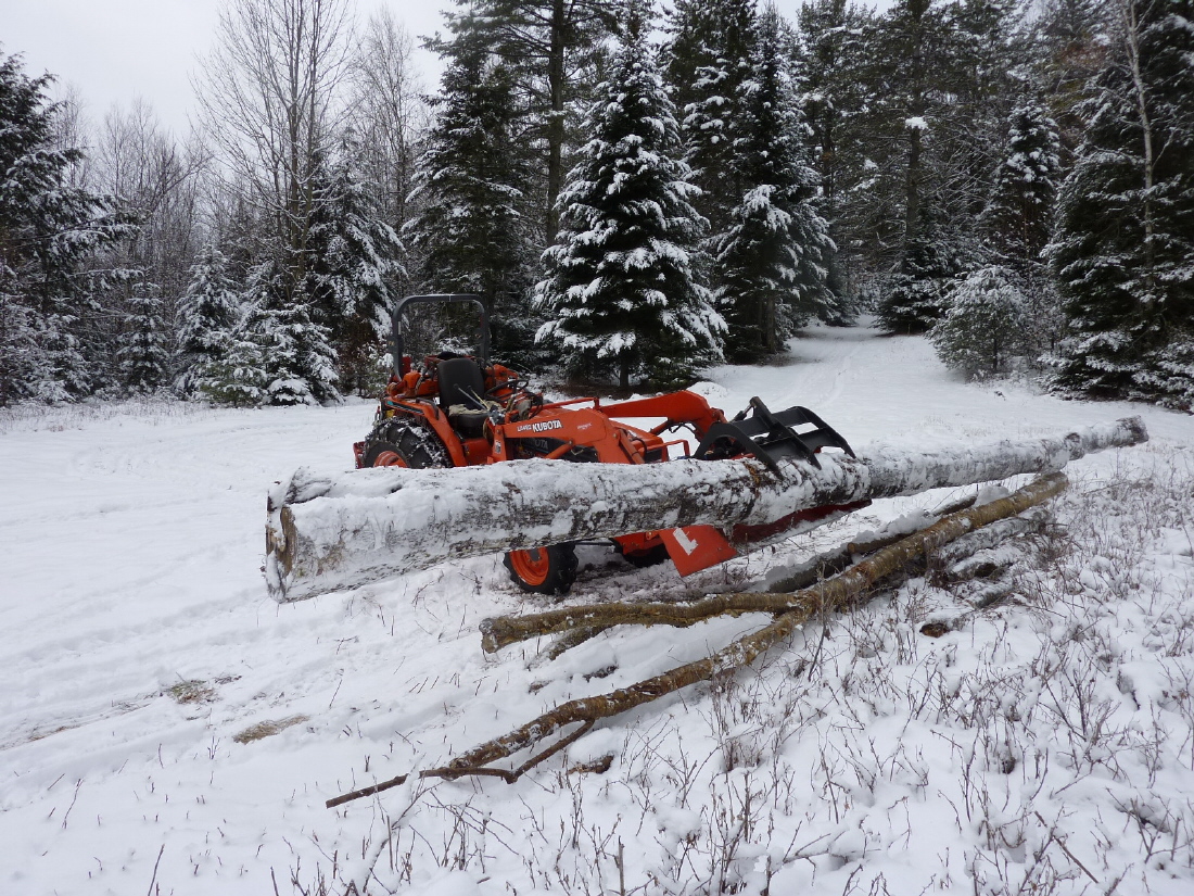

Using the bolt on grapple is hard to see what you are picking up?

It is hard to see. But it is no different than using the cutting edge of your bucket which you cant see either. After a while you get a feel for it and just know what angle and height your bucket has to be in to do what you want. Like I said, it is a trade off you have to make. It is plenty strong though. One of the big plusses for me is that I can go out to work and use either the bucket or grapple, switching back and forth as necessary. I have them both there and ready all the time.
