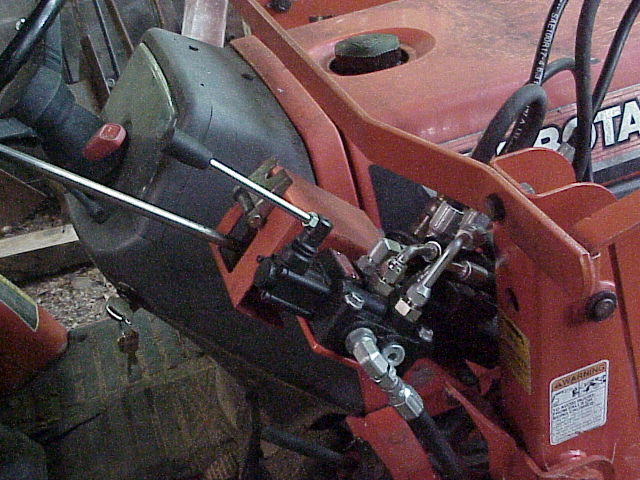

I wanted to install a new valve to control my grapple and get it off of the rear remotes so I can use them for TNT. I wanted the valve control to be near my FEL lever. Last Nov teg posted a very nice discription of a similar project he did. I stole alot of his ideas. THANKS teg. This is a link to his post
http://www.tractorbynet.com/forums/...7948-instructions-add-extra-spools-l2800.html
I started by buying a single spool DA 8 gpm Prince valve fropm Surplus Center.
Prince # MB11B5C1 DA.

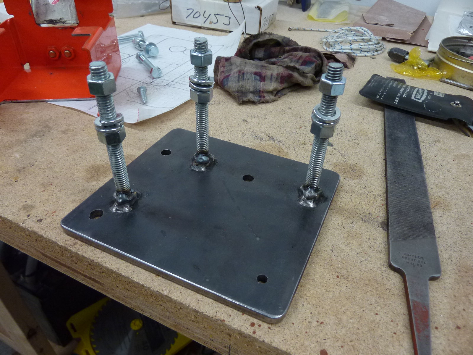

I built a mounting plate for the valve from a piece of 5 1/2" X 6" 1/4" plate.
I drilled and tapped 3 holes for 3 3/8" mounting studs. Jam nutted and welded them.
Drilled 3 5/16" holes to mount the valve, and one hole in the corner for a heavy sheet metal screw to attach to the orange cover. I am going to mount the valve and plate on the FEL linkage cover. Photos: Linkage Cover, Cover Removed, Base Plate.

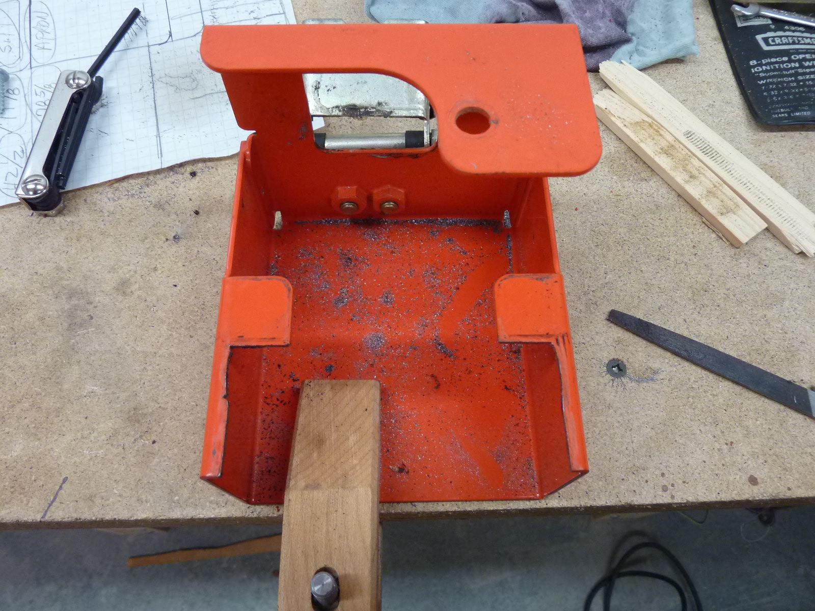

I wanted to be able to remove the linkage cover when I was done in case I had to get in there. So I cut off the two rear mounting tabs and cut a chunk out of the top. I used the two rear cover mounting screw holes in the FEL bracket for 2 of the the 3/8" studs. The bottom cover screw is still used from under neath.
Photos: Cover Cuts.

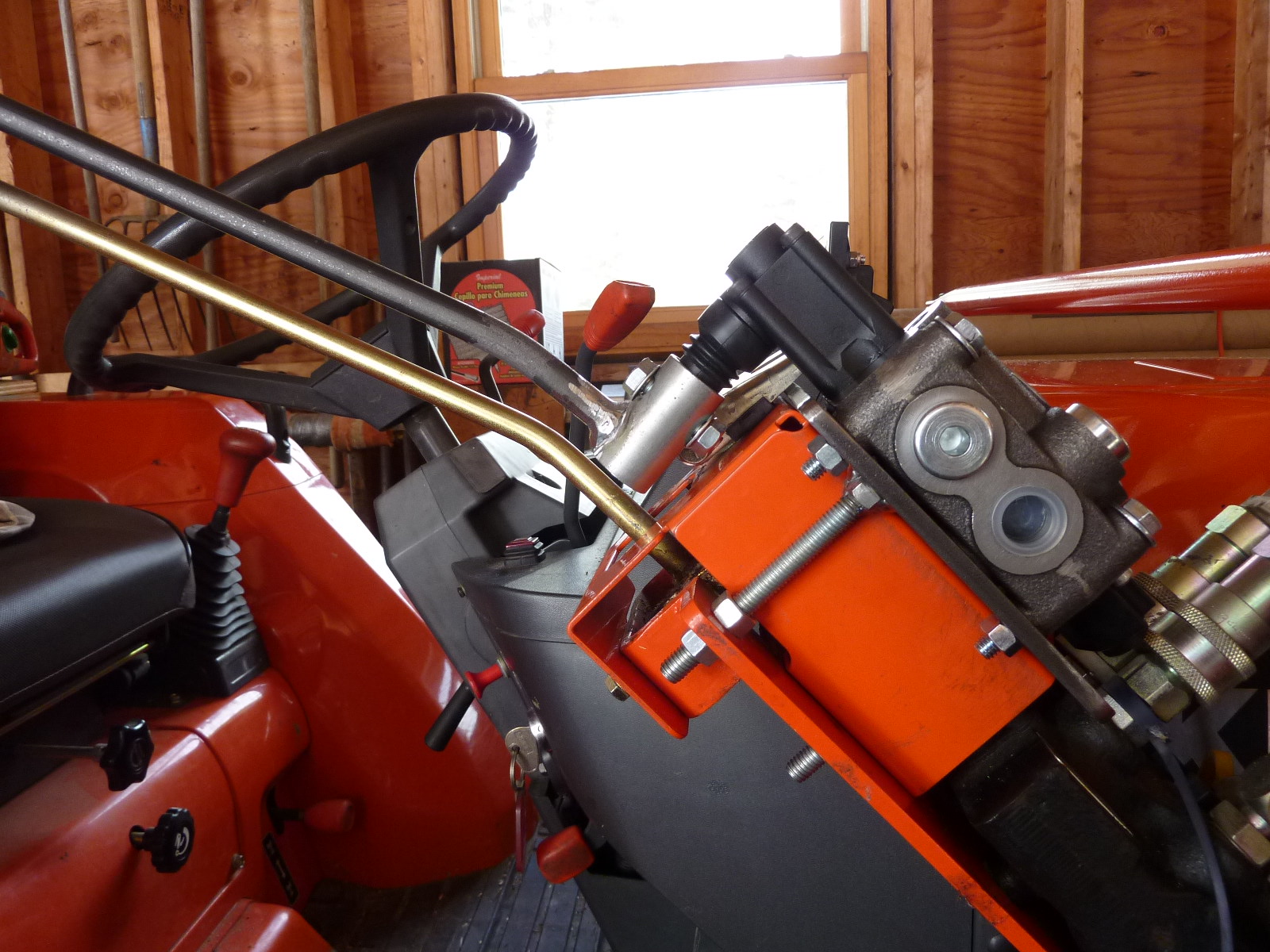

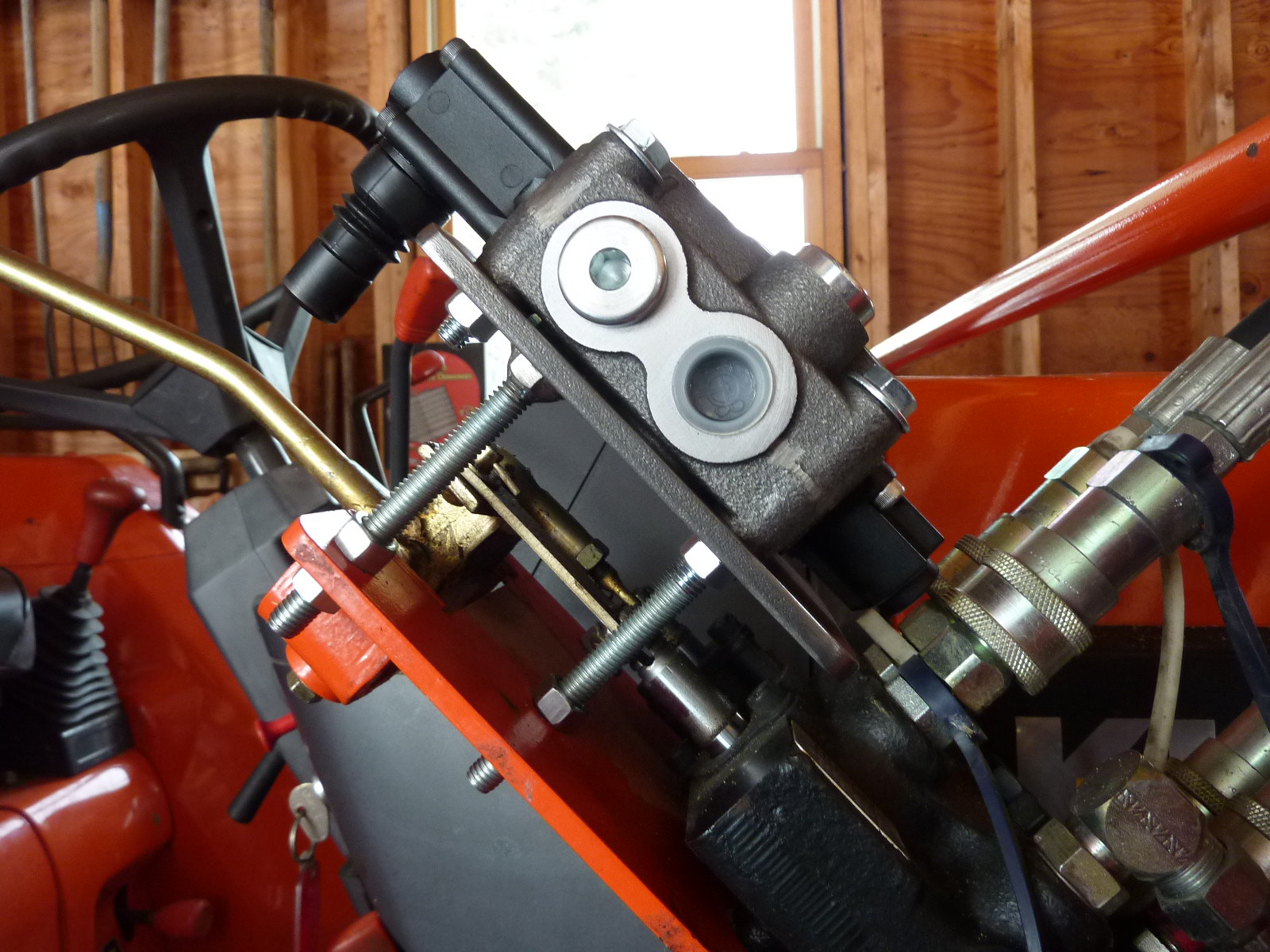

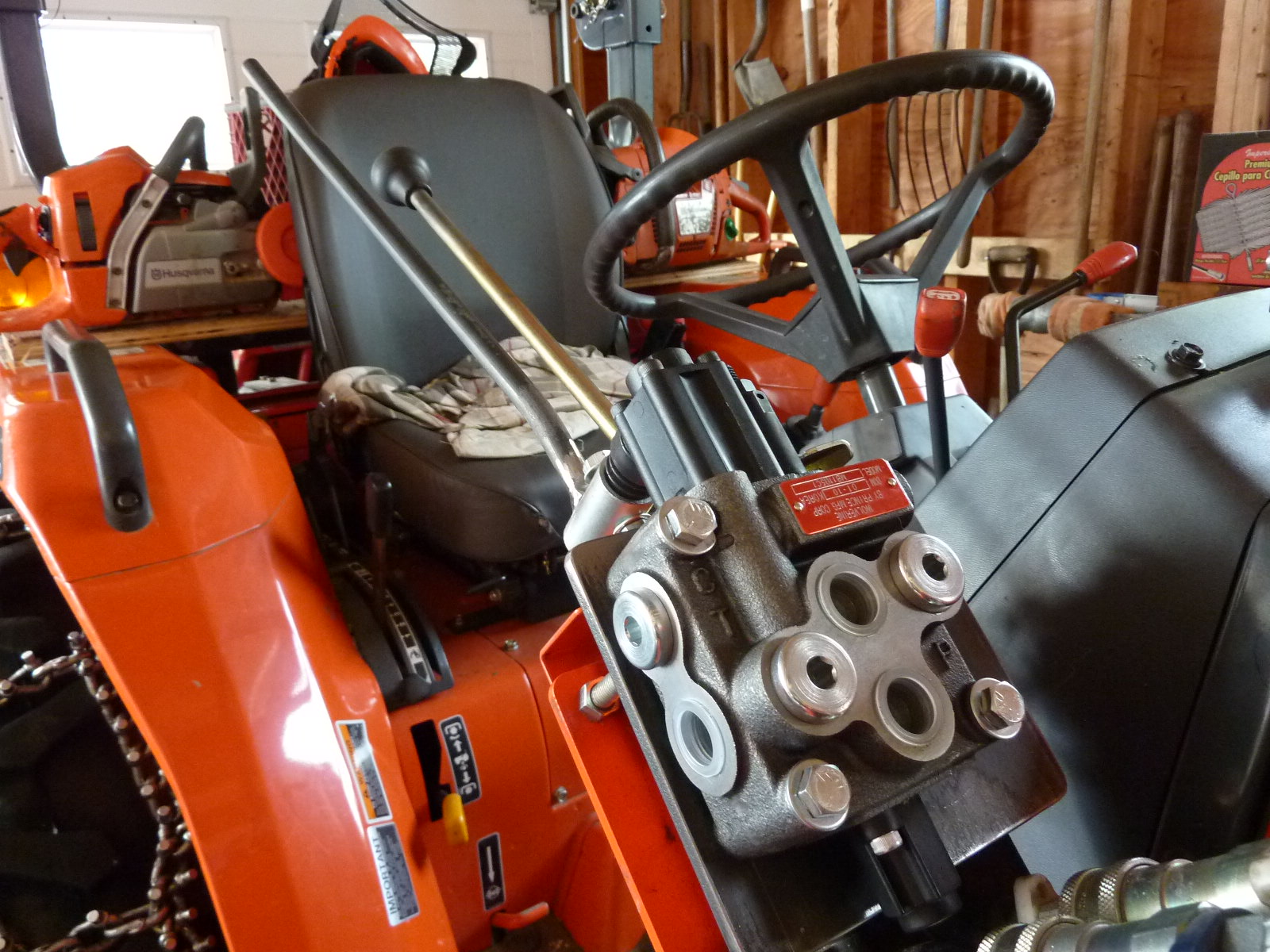

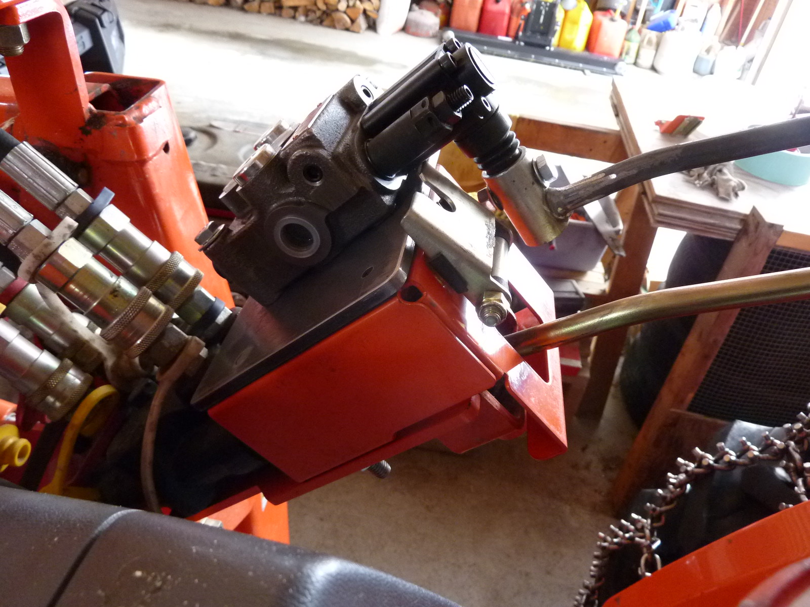

I turned the handle housing on the valve around 180 degrees so that it was pointing downward. Mounted the valve on the base then put the assembly on the tractor. Two of the studs go into the rear cover holes, the third goes into a hole I drilled in the outside corner of the FEL bracket. Photos: Valve, Housing 180, Valve & Plate, On Tractor

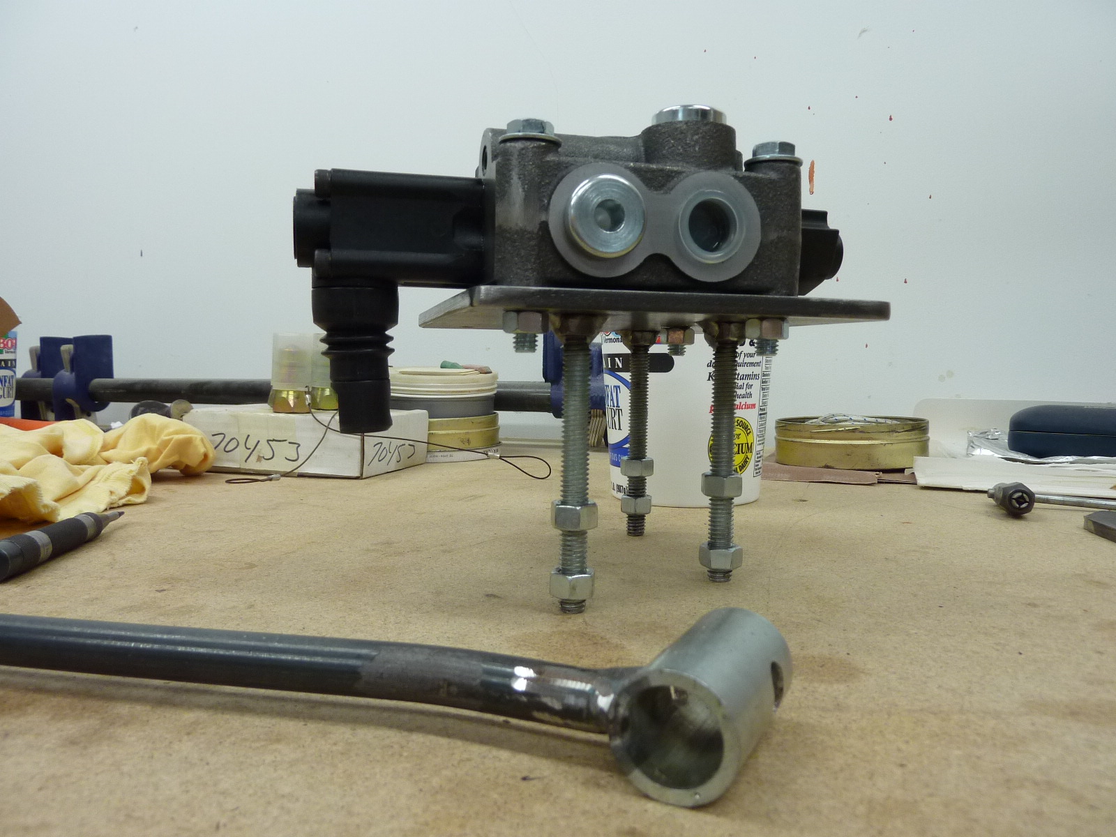

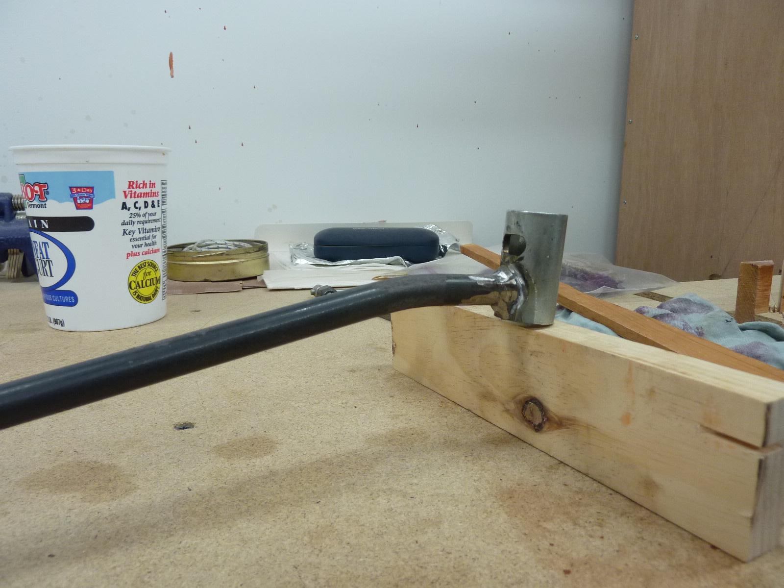

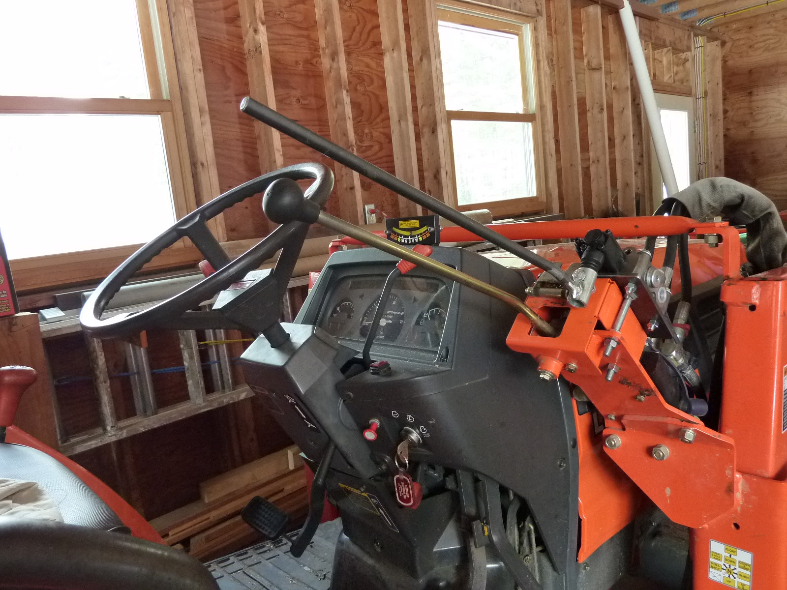

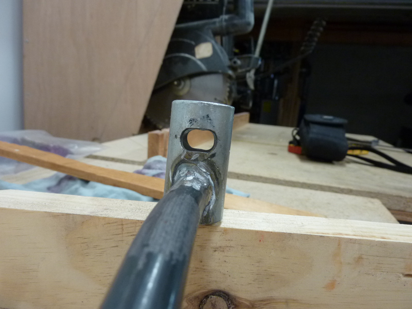

I made a lever arm from a 3/4" X 1" bushing and a 18" length of 1/2" rod. I put an oblong hole in the bushing to allow side motion to the lever. This way it can move left and right to follow the FEL lever when I curl and dump. I bent the rod to match the angle of the FEL lever arm.

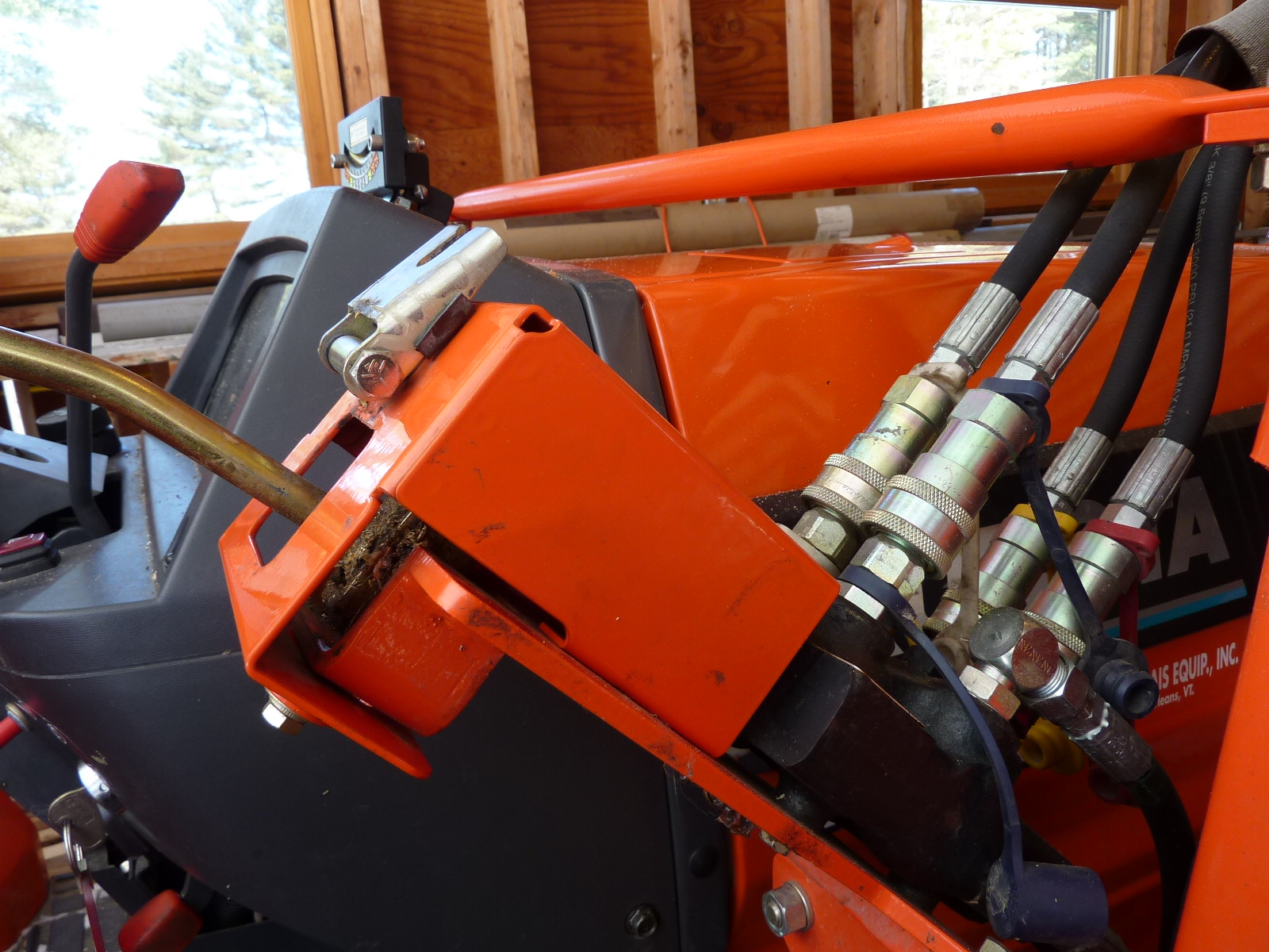

I put the whole thing together on the tractor. One note: In order to slide the orange cover under the valve mounting plate you have to remove the valve handle housing ( 4 cap screws ). Next I need to cut off the lever arm when I receive the knob I have on order from Missicks. Then I need to take it all apart for painting and reassemble using locking hardware. Then I get to do the plumbing and figure out the mystical maze of hydraulic couplings. That empty hole in the corner will have a 1/4" sheet metal screw down into the cover. Here is what it looks like so far.

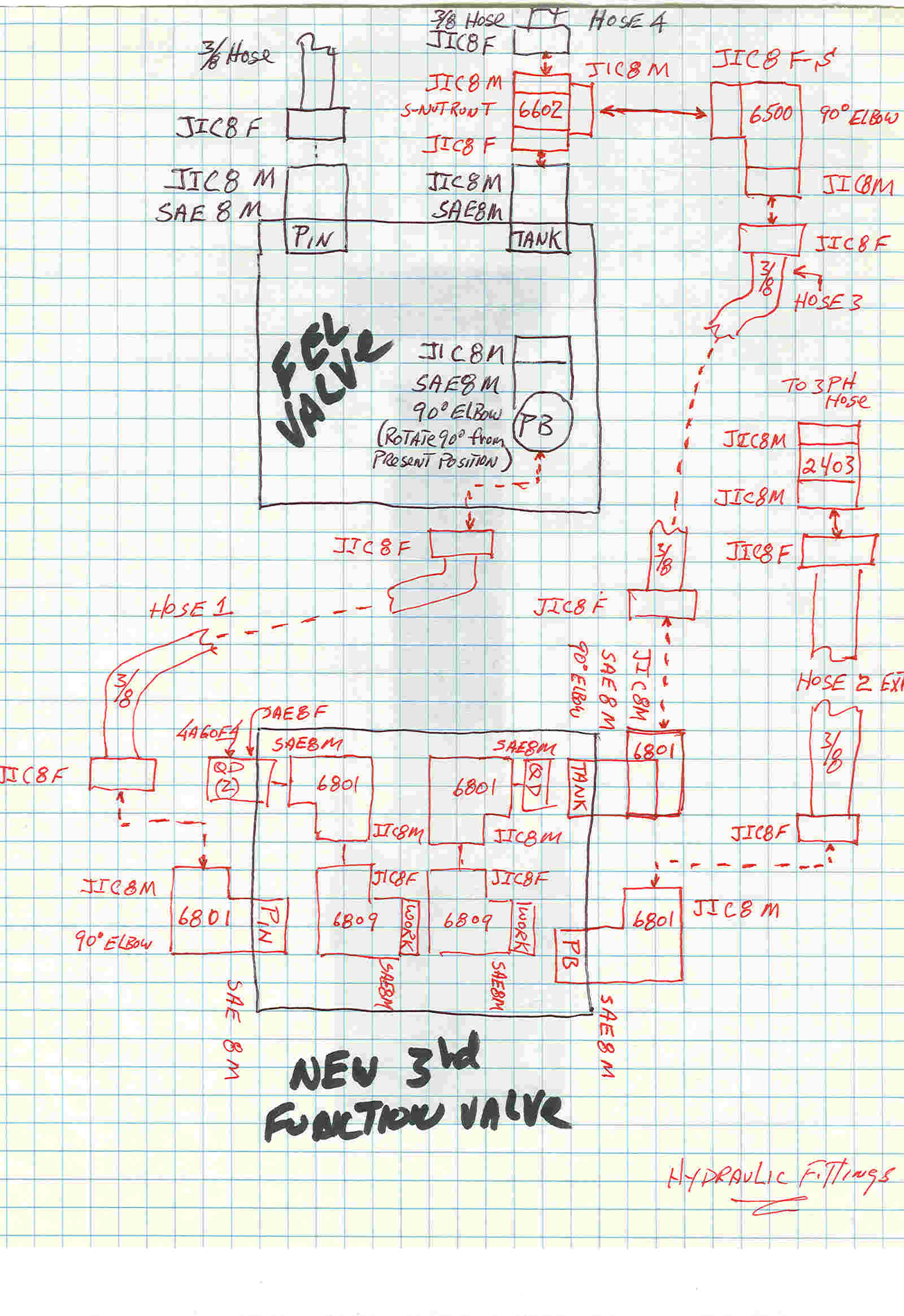

Here is my hydraulics diagram. I am going to steal what I can from teg's parts list that he was nice enough to give us. It will be a while before I am done. I would like nice weather for the plumbing.

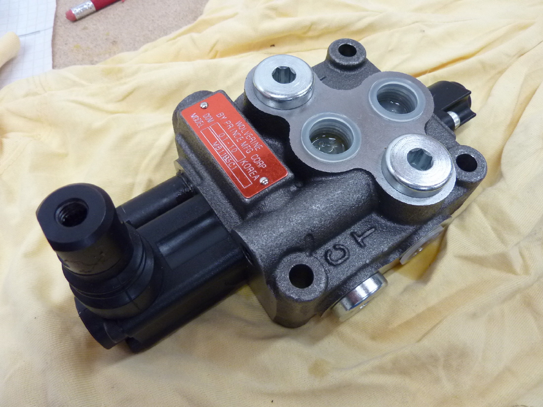

How do you like the 'Wolverine' series valves?
I have several of them.

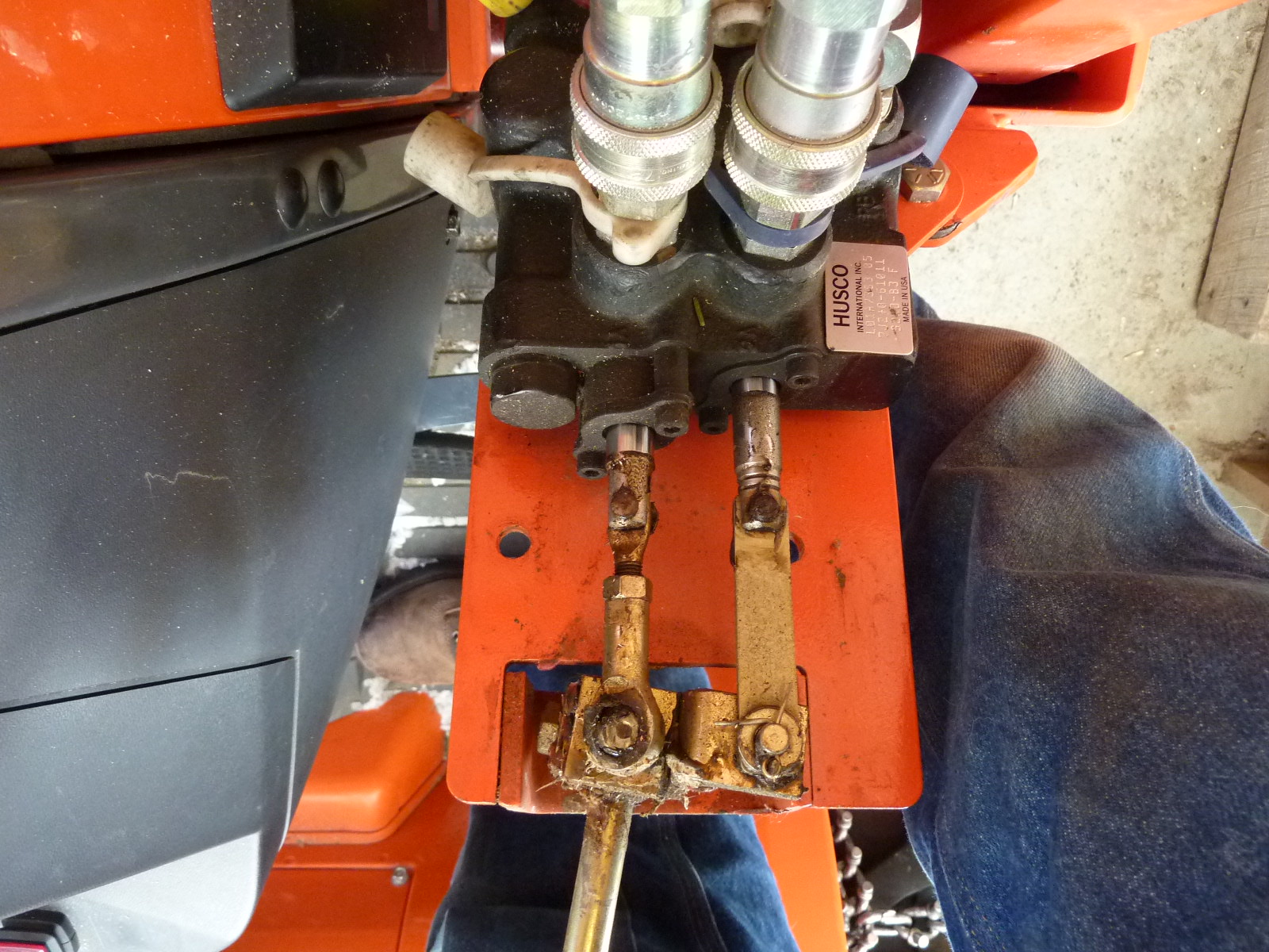

teg I like your cut off FEL lever. Puts everything close.
I like the idea of a fully hydraulic control to give you a better "feel" and feathering ability. In real life I don't know how important that actually is, but I like it. Also the fully hydraulic control was simpler and cheaper for me to install.
I finished my lever arm. The grapple control is always within reach now. It moves left to right with my FEL lever as I dump and curl. It is much better than where it was down by my rear end on the rear remote control.

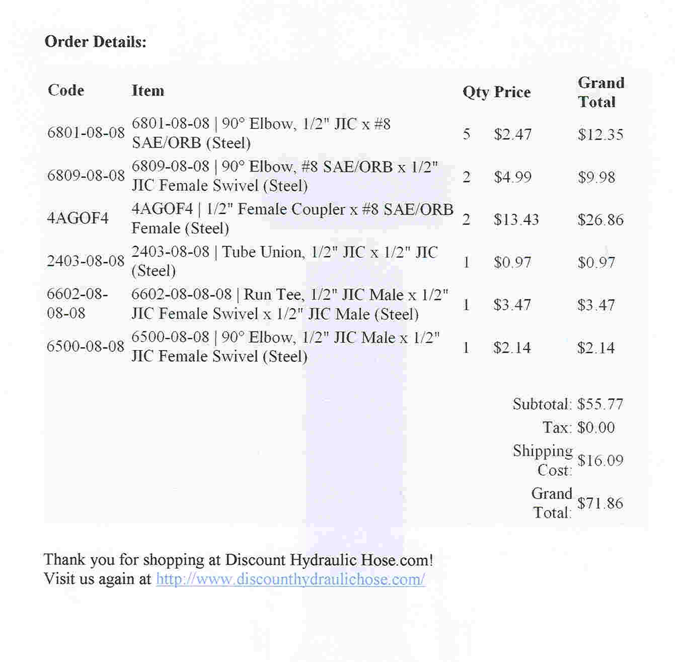

We had some lousy weather so I sat down and figured out what I needed for hydraulic fittings. I used #8 (1/2") fittings and QDs with 3/8" hose to be consistant with the original equipment. I ordered them from DiscountHydraulicHose.com.
It looks like my total cost for the Third Function Valve installation will be just under $250. Here is how it breaks down.
Parts S/H
Single Spool Valve Surplus Center $89.95 $12.98
5 1/2" X 6" X 1/4" Plate Walbridge Welding $5.00
Includes welding nuts
18" length 1/2" rod Walbridge Welding $6.00
Includes welding bushing
Knob for lever arm Messicks $15.37 $13.61
Fittings Discount Hydraulic Hose $55.77 $16.09
3 short 3/8" hoses w/ jic 8F NAPA $30.00 (est.)
$202.09 $42.68
I hope someone finds some of this info useful.
