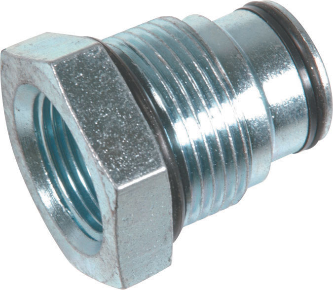

I am in the process of installing this set up on my L3200. Same valve... Question on the "internal H.P. carryover plug (1/4-18BSPT)", it seems odd but I just want to make sure this plug needs to be installed inside the PB port for this set up. You did install this plug correct?
/ Photos of Third Function Valve Project #27
If you are feeding the next valve, you need the PB adapter.
/ Photos of Third Function Valve Project #28
JJ, are you speaking about the little plug that goes into the power beyond on the new valve?
/ Photos of Third Function Valve Project #29
Yes, that plug is necessary to separate the main flow from the OUT flow.
Some valves use the hex screw, and other valves use a PB adapter sleeve.
If you are talking about the valve in post 25, it uses the PB sleeve.
If you look in the PB port, if it has a small 1/4 in threaded hole, then it takes the screw.
If the hole is larger and has a seat for an o-ring, then it takes s PB sleeve.
I posted both kinds.
You should use the part made for your valve.
Perfect! Thanks JJ.

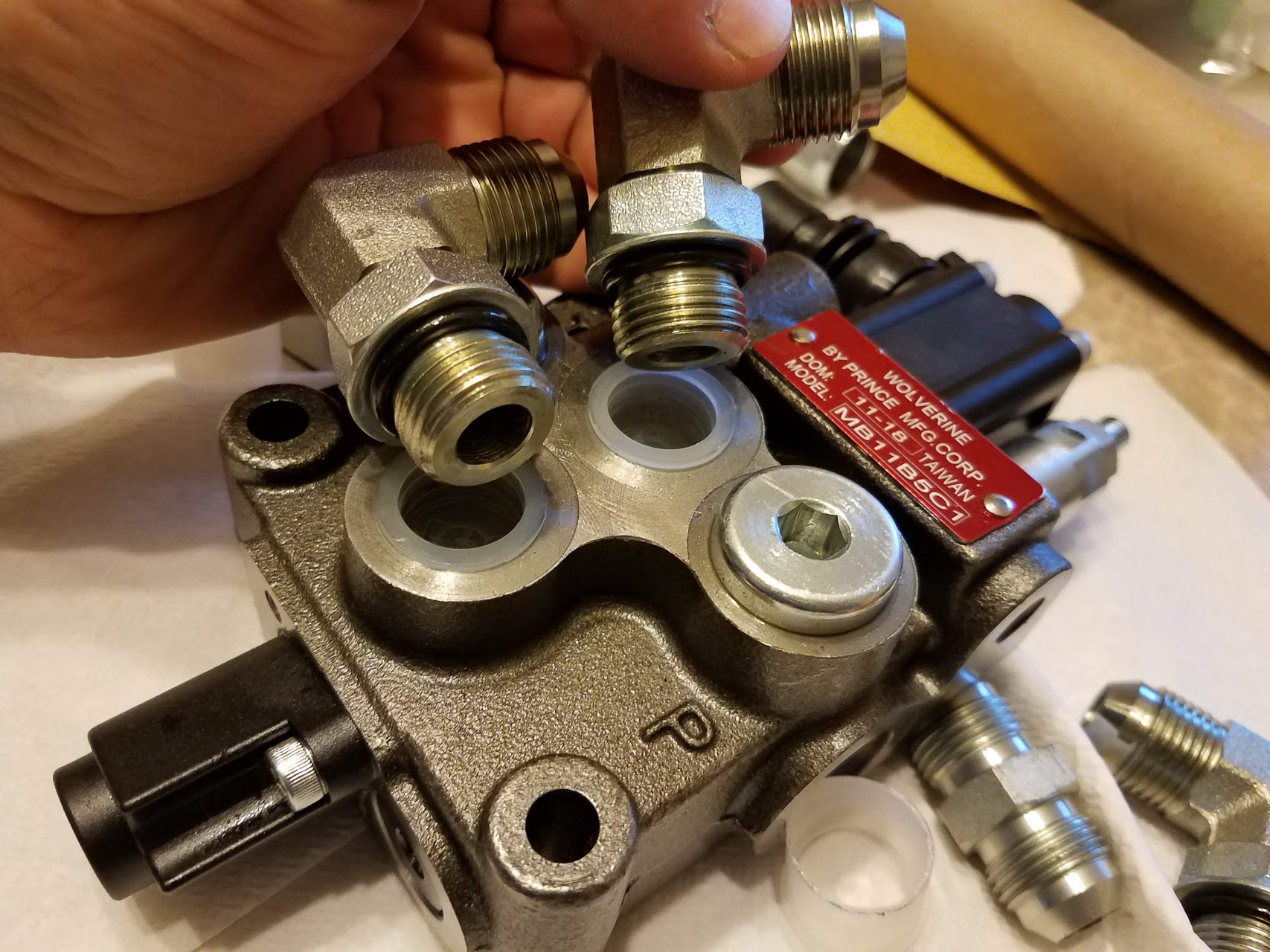

So I blindly ordered the fittings exactly off the parts list previously posted here. The hydraulic diagram calls for 90s (ORB to JIC) for every direct valve connection. The 90's on the Tank/PB and output ports cannot be installed at the same time due to their close proximity. In other words, they cannot be installed at the same time due to clearance issues. I am aware that I can buy more parts but I'm wondering how no one else has had this issue? Also, a recommendation on the cheapest way to correct this would be appreciated. "Long" fittings are not cheap compared to their short counterparts.
/ Photos of Third Function Valve Project #37
Straight ORB to JIC, then a standard 90 degree JIC swivel fitting.
/ Photos of Third Function Valve Project #38
Re: Third Function Valve Project/ valve question for the hydraulic guys
I used ORB standoffs on my setup.
/ Photos of Third Function Valve Project #39
There is an alternative to JIC fittings and expensive angled hose end fittings...the alternative is NPSM swivel fittings...They are mechanical fittings that require NO sealant or tape etc...they are actually more robust than JIC flares...

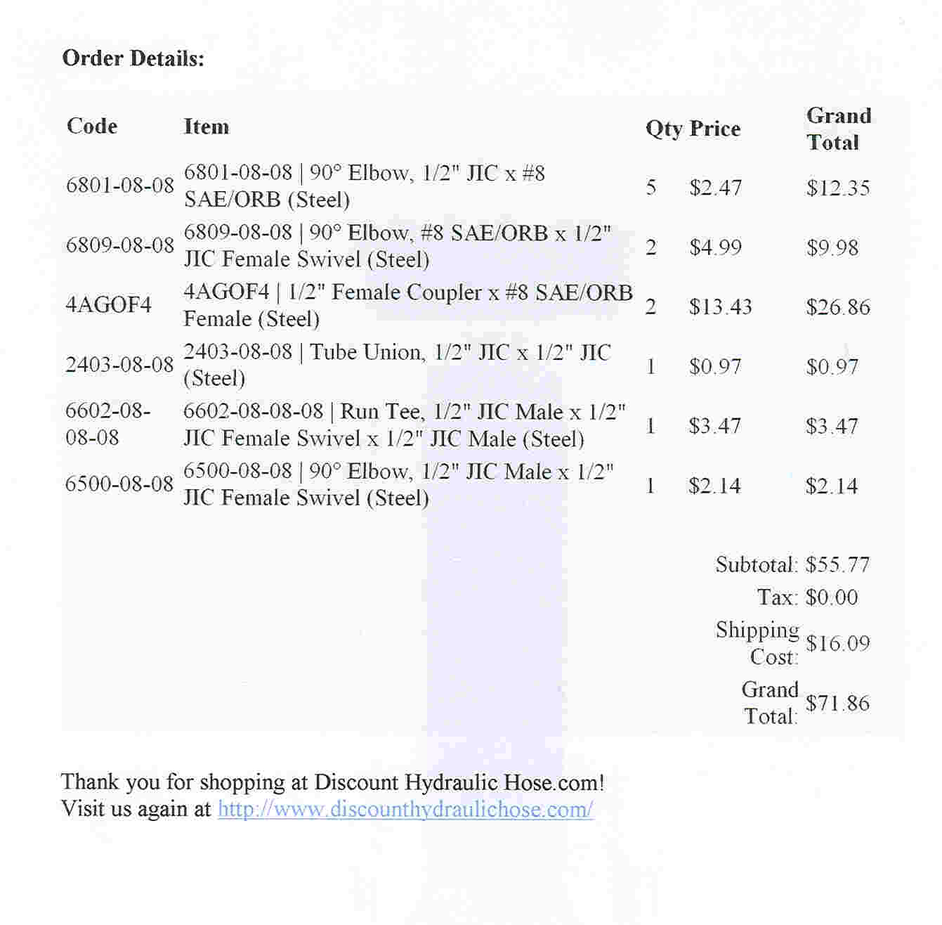

I ended up ordering from discounthydraulichose this morning what I think will work. Male ORB to female JIC with swivel nut. That should allow me to screw the ORB Male into the valve, then tighten a male JIC 90 onto the new fitting. I ordered two JIC Male to JIC Male 90's as well. Assuming I am interpreting the definition of "Swivel" correctly I believe this will work?
6402-08-06 | #8 SAE/ORB Male x 3/8" JIC Female
[Edit] Insane.. I ordered hyd oil direct from Schaeffer Sunday evening. I just got my tracking number today, UPS has yet to receive the item. I ordered fittings from discounthydraulichose at 8:30am this morning and USPS has already received the package as of 5:30pm. I may not get to use my new grapple this weekend not because of the fittings I ordered today but the oil I ordered Sunday.. LOL
