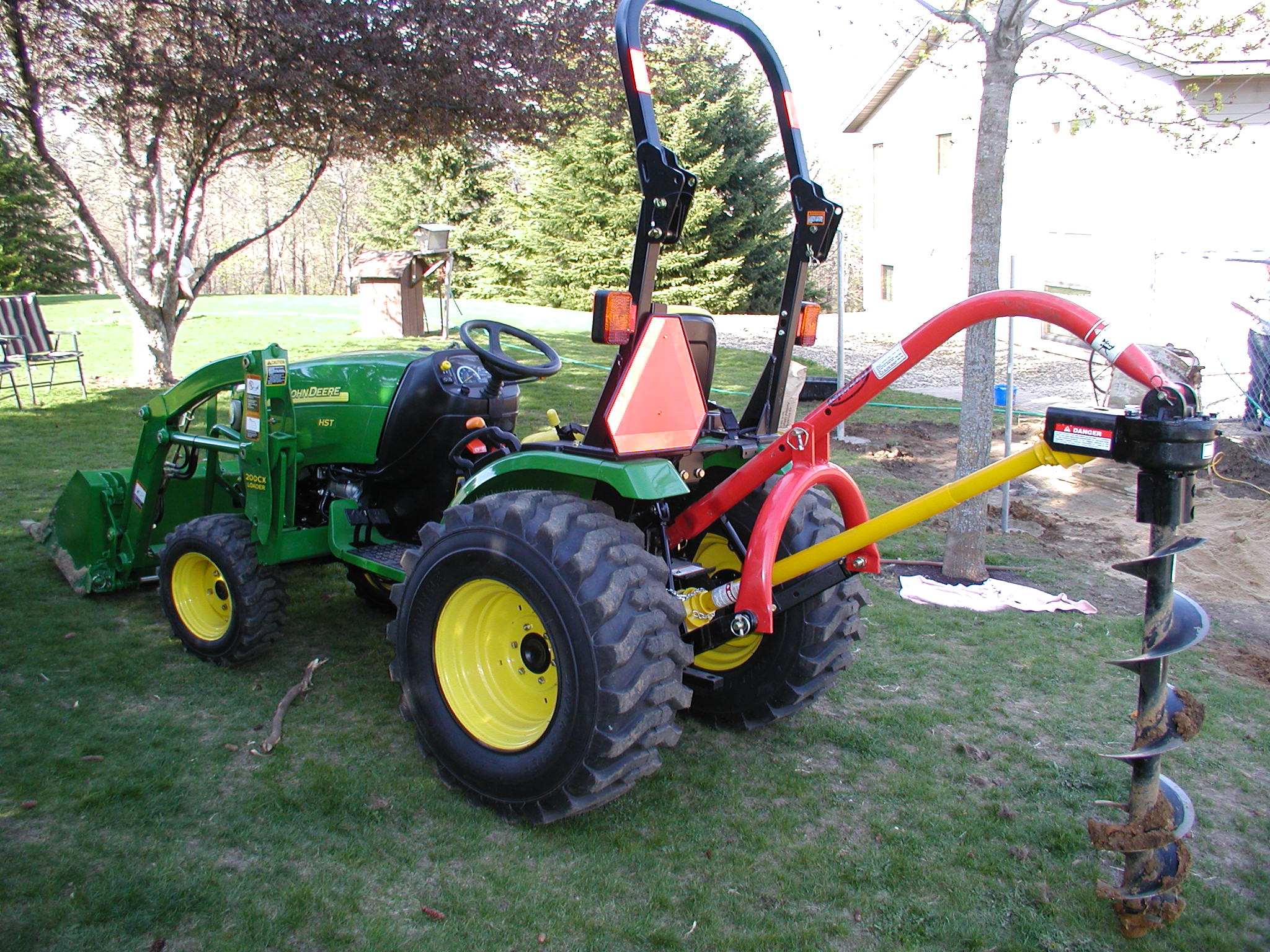

I own a Speeco, from TSC. It is about the lowest cost one there is. And it works great. As far as rocks, they come in all sizes. If you are drilling a small hole (9 inch for instance), and you hit a four inch rock, you are about screwed and must bust the rock out of the way with a bar or something. BUT if you are drilling a bigger hole (12 or 14 inches), that same four inch rock will come out with the dirt. Northern sells a larger bit (14, I think) that fits the speeco, even though Speeco themselves sell only 12 inch at the biggest.
A great idea someone here on TBN had, I still need to copy, is to weld on a segment of 2 inch water pipe horizontally across the bit down-tube, like at the top end of the flighting, or higher. this way when you hit a rock or auger under a root, you can stick a shovel handle thru the pipe segment (with tractor OFFF!!!) and turn the drill backwards. Sure beats disconnecting it from the powerhead and pipe wrenching on it.
Ideally you would have power revers on the PTO, to back out of bad situations. Hydraulic would also help a lot, variable, and reverse. There are some PHD that are loader-bucket mount ones, hydraulic powered, etc. Nice, but expensive.

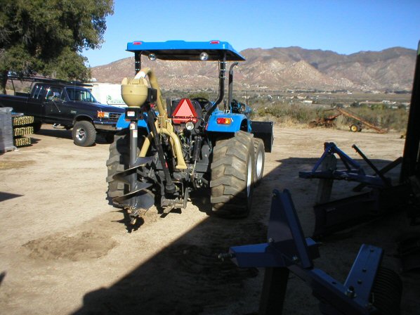

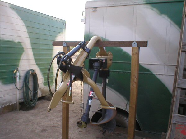

Maybe if you would have had your phd on a stand you would not have fought it so much. By selling your phd you now have taken away the convenience of being able to go and drill just a few holes when needed. My guess is that in your situation you don't need that convenience. I have found that renting equipment is inconvenient and costly. Renting can be a real problem if needed on spur of the moment type of conditions. We each do what works best for us. Oh, unless I'm having a bad day, I can have my phd hooked up and ready to use in about 5 minutes.;)

My feeling on implements is if it has a gear box buy a top brand, If it is a non mechanical buy anything that fits the bill.My PHD is one of my most important implements. Not that I use it all the time but when I need it it will spend weeks on my tractor. there is a way to use it and every hole is different, you have got to clear the hole as you drill. If you sink the drill and let the hole fill in on top of it what do you think is going to happen. The other thing about storing and mounting is no more hassle than any other implement. In fact I find it one of the easiest to store and mount. It takes up no room at all in my shop.

I bought Bush Hog's optional parking stands for it, which placed the 3PH connections at the right height for hook up. I just found it a pain to connect, use and disconnect as I had to remove my quick hitch, then the top link, then fight with the thing to hook it up. Of course the projects I bought it for didn't materialize as I had expected. In my case, renting would have been far cheaper than buying the PHD. I had a 12" auger by the way. Anyway I'm glad it's gone.
