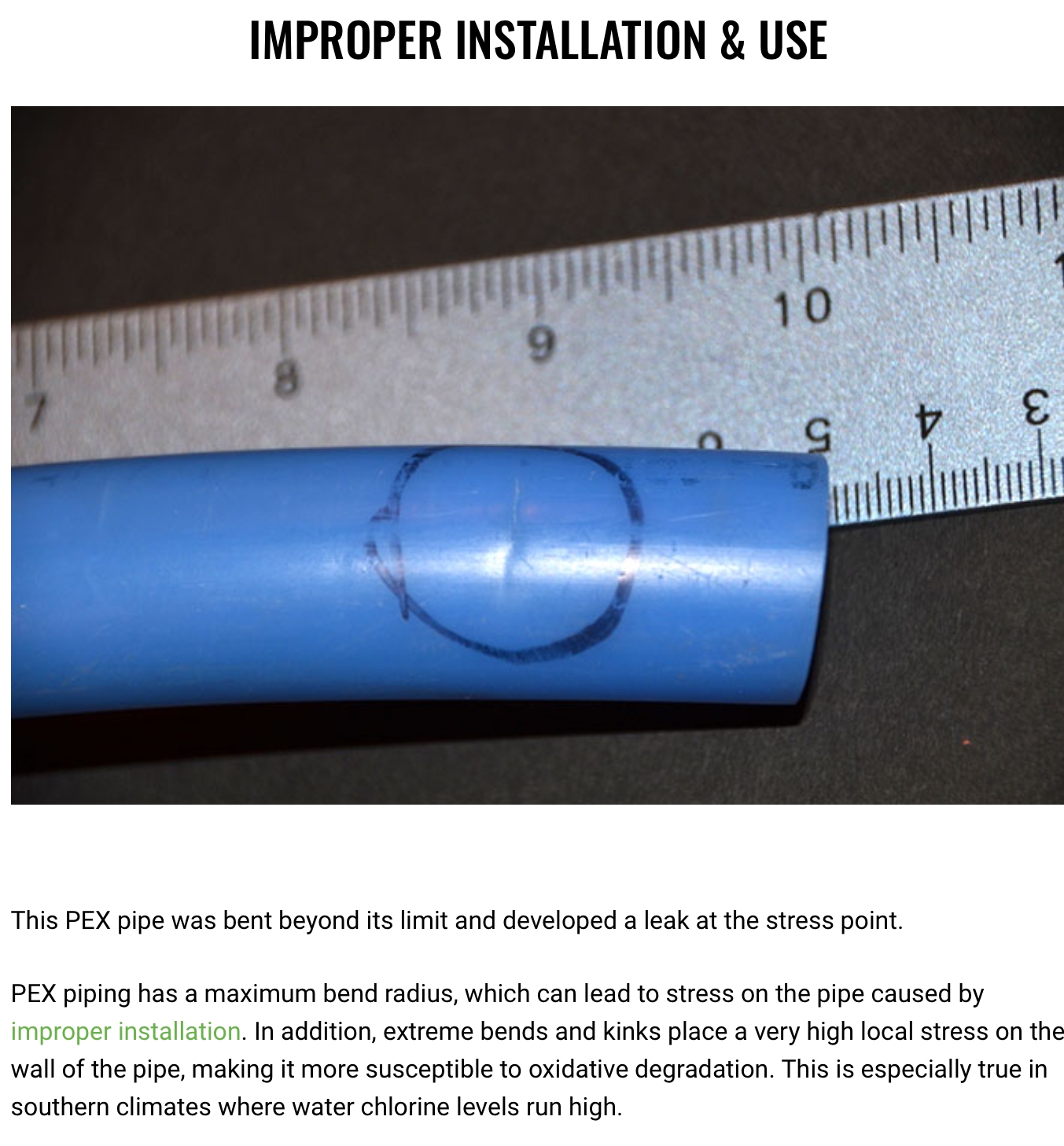

@Pettrix Don't even hesitate. Replace.
As @Chewwy's material points out, a kink ruins the strength and structural integrity of PEX. I would make sure that they replace several feet of the pipe to not be kinking the replacement section.
I hate to say it, but I would strongly recommend you going over ever inch of this installer's work, looking for small defects. It does not take much to generate an issue, and that photo says a lot to me about that particularly knowledge of PEX and their skill level.

pex-a I wouldn't worry. A heat gun will take the kink out and fix. pex-a be stronger and more forgiving.
pex-b on the other it will be permanently weakened so a simple fix would be done if me.
if your plumber still be around a simple fix and you be good to go. I would fix it. A buck or two and its fixed if plumber their.

Post number 4 covers it nicely. However, my PEX has been in my concrete slab or over 20 years now with no issues but I installed it myself, always mindful of the minimum radius. That kink-crease will fail, have it replaced asap.
