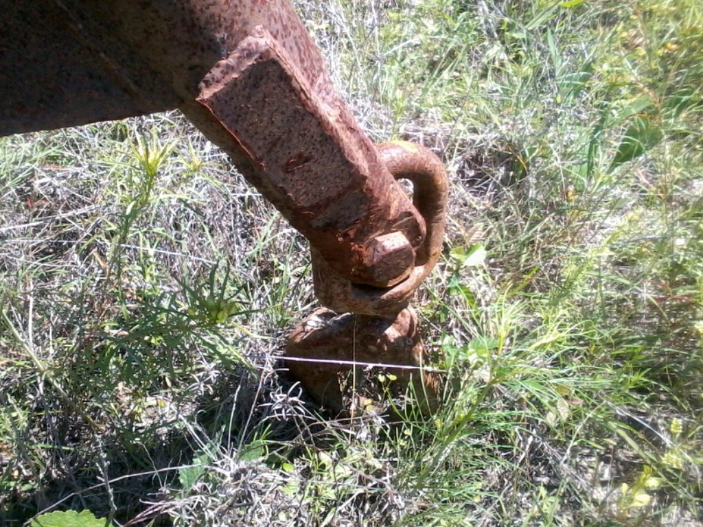

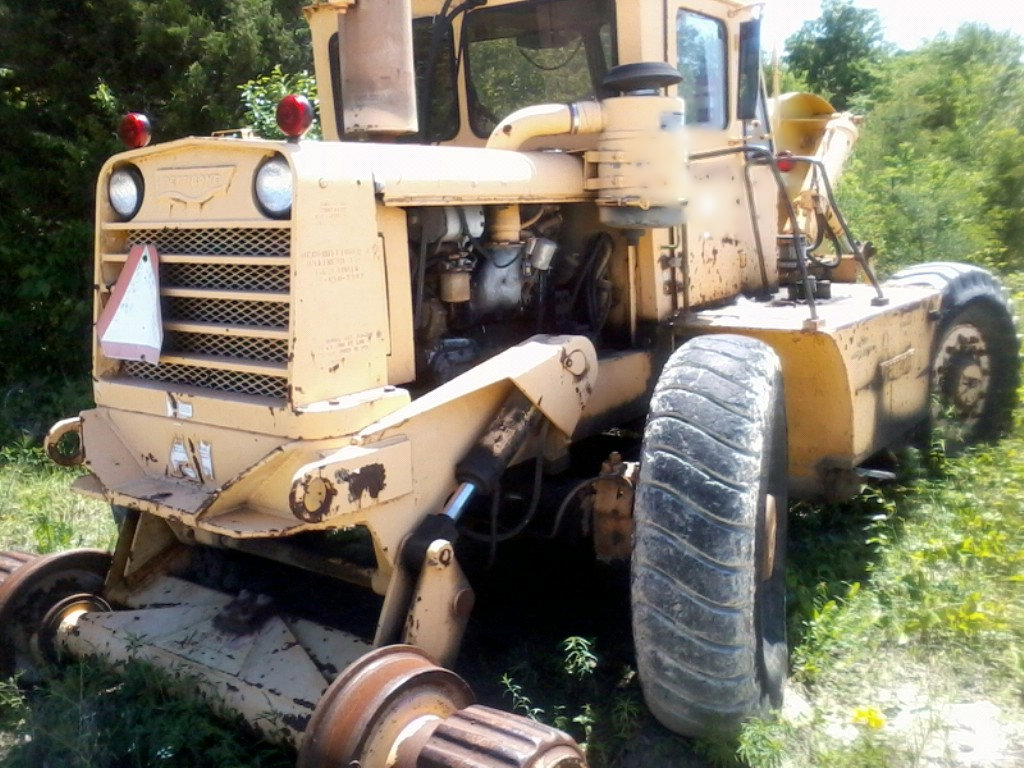

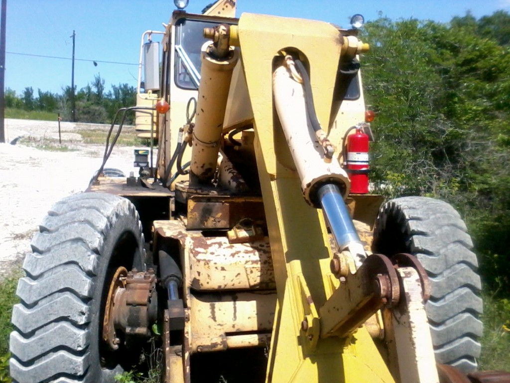

I noticed this machine sitting in the same place for several years. It was used on a nearby railroad. Recently, I got some ID #'s off of it and sent it to the RR company to see if they still own it or not.
Had no idea that these Speed Swings had several attachments.
I'd rather have a Cummins than a Detroit, but that's what it came with.
Trying to find out who the owner is and if I could purchase it.
Has anyone on here ever used a Speed Swing like this one? I think it was made in the 1970's, but not certain. Has four wheel drive and four wheel steering. The boom rotates 180 degrees left and right on a horizontal plane.
Would like to know what the rear mounting holes are for.
Thanks

/ Pettibone Speed Swing #3
I think they are just to pick it up. I had a Tonka one of these about 50 years ago. It is still up in the barn. They all had screaming jimmys on them.

/ Pettibone Speed Swing #11
The first picture shows the tool box,where a grease gun and small hand tools were kept. On the drivers side there should be a large tool box with indented steps to assist in climbing into the cab. Passenger side were the diesel and hydraulic tanks
There looks to be part of a pulling block, sitting on the front lip of the tool box. This part went over the ball of the rail and a wedge with a serrated edge was inserted and
hammered like holy hill. When pulling anywhere from 400' to 1660' of ribbon rail (continous welded rail), there is a lot of stress and the more you pull the tighter the wedge gets.
The small toter boom in the picture was for small loads. The only other attachments I myself have seen were a small material bucket, the large snow bucket with raised portions to fit over each rail at the same time and lay flat to the ties and a lattice boom about 20-25' long.
