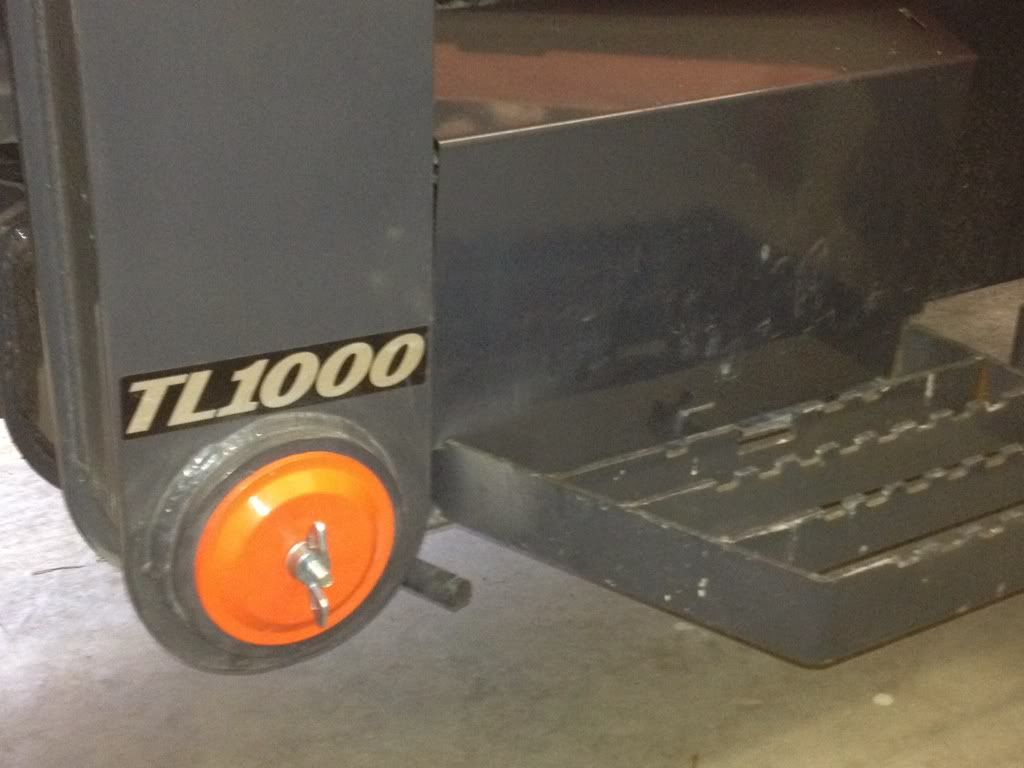

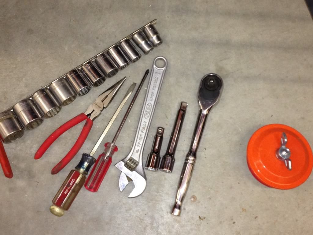

Well I finally got my L45 into the shop and completed my "Bucket Buddy" (quote from a past post)

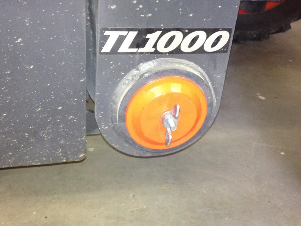

But having a breakdown on my tiller the other day made me realize I really need a toolbox. So being cheap and looking for an alternative I found that Kubota has given us a built in toolbox, we just need to provide the lid, which I did in the form of an Oatey plumbers cap.

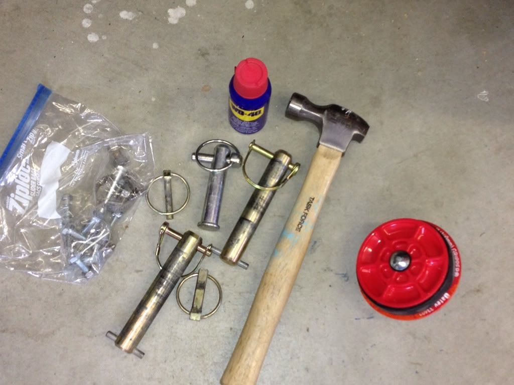

About 6 bucks at the local hardware big box. I reversed the outside portion and painted with Kubota orange. Here's some other shots of all the stuff I was able to put them (one on each side). They are 4" dia. and 14 1/2" long.
I had to cut the claws portion of my cheap hammer to fit, but now I at least have something to pound a pin with!!!

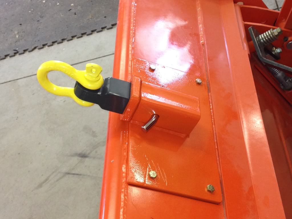

I added the receiver mostly for lifting things around the yard without having to weld a hook directly on the bucket. I think moving a trailer would require an 8 or 10 inch drop hitch. If I get a chance after work today I'll try hooking up my transport trailer and let you know how it goes.

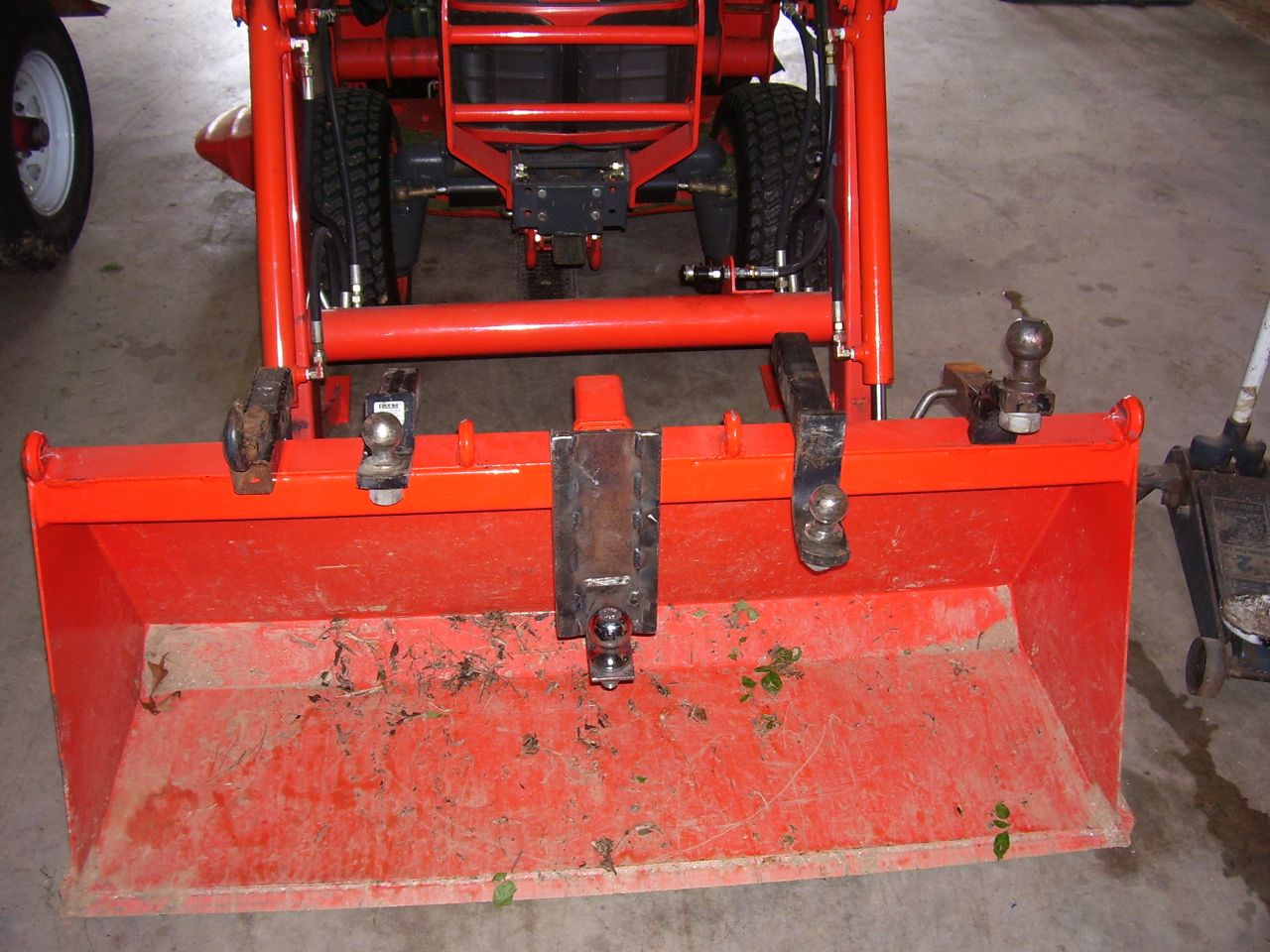

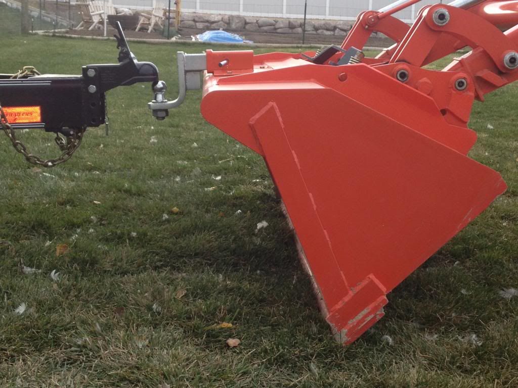

Well, all I had was a 6" drop hitch, and it just barely worked, so a 10" would be better depending upon the tongue height of your trailer. Here's a couple of picts.
/ Perks for the L45 #8
My fear realized.
I am considering welding up a bracket that would make the hitch level when the bucket is level. That might reduce the drop needed.

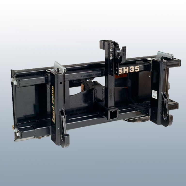

Another way is to use the QA feature of the FEL and drop the bucket in favor of a specialized adapter plate. My old dealer usually had a pile of simple QA plates with the receiver already welded on for around $100.
The most expensive/versatile adapter that I've personally used is the Land Pride SH35. It will do any hitch at any angle and also Cat I and II 3pt attachments. Very clever.

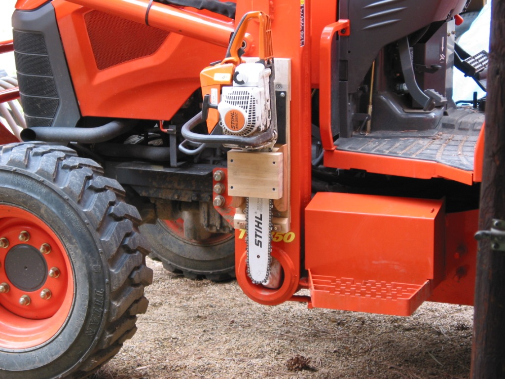

And here's another version of a tool holder using the same "tool box" mentioned. The chain saw bar serves as the lid. The tube holds a bottle of bar oil, a container of pre-mix, and some tools.

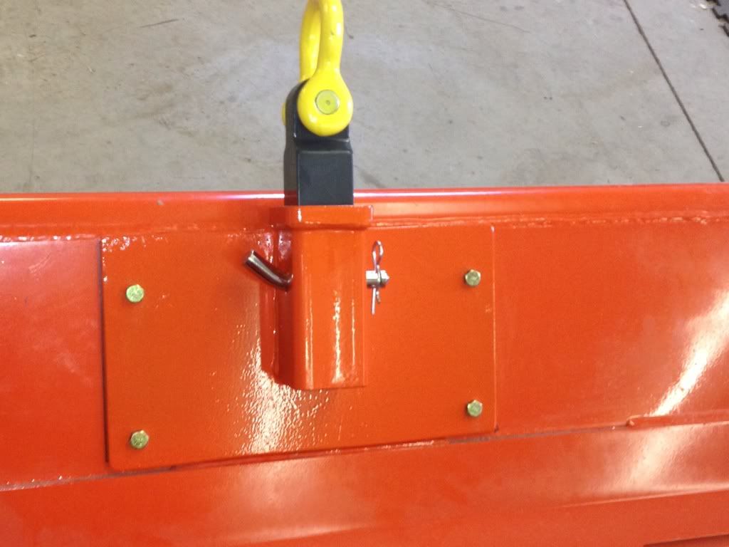

Please let me know if that receiver works for moving trailers. I think I have the same bucket on my L39, and the angle of the heavy duty bucket makes it look like it will be tough to get under the tongues.
ac
